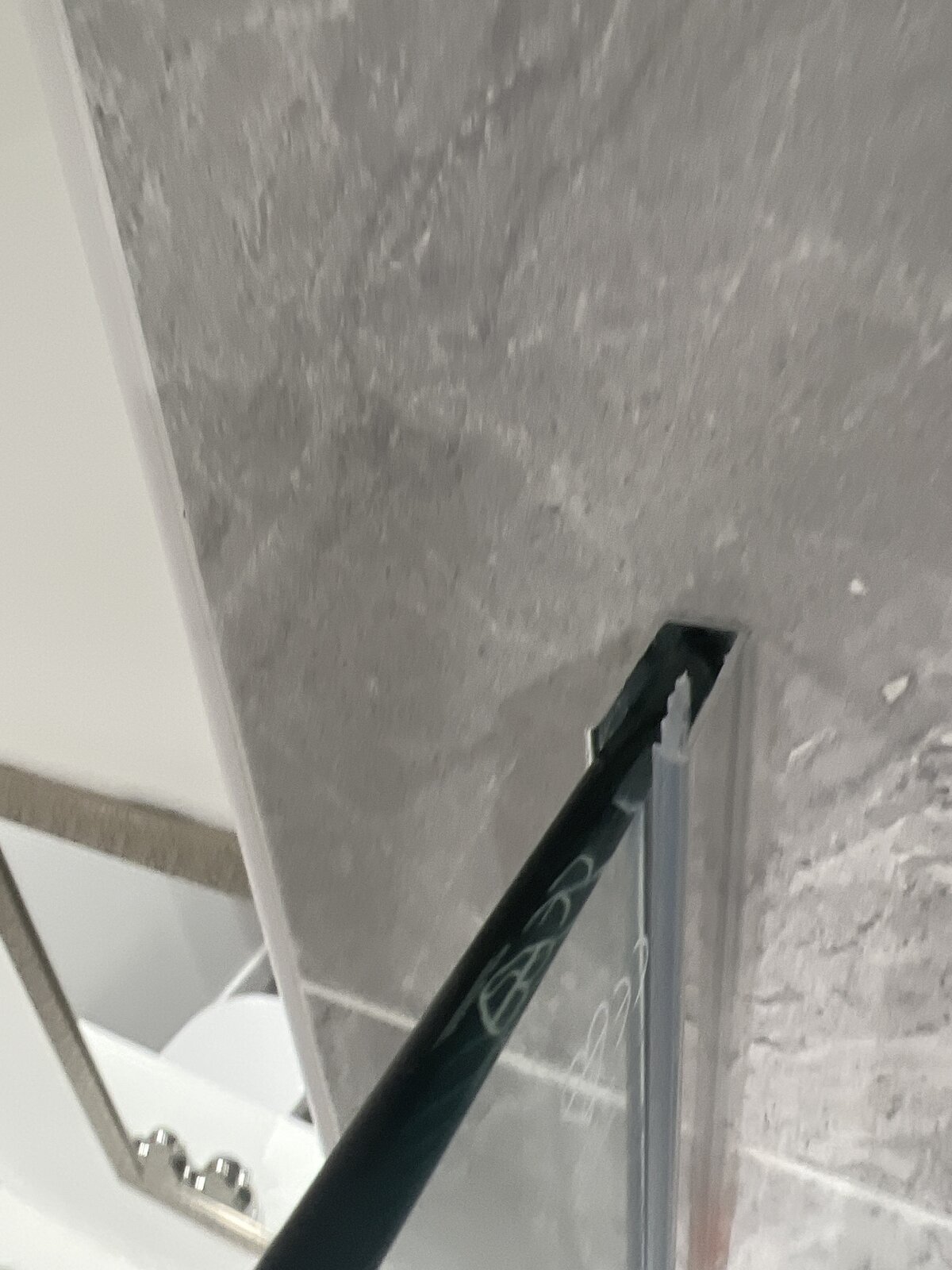

I have just had a bath removed and full shower installed. The problem is that the sealant where I’m assuming the new drill holes were drilled for the screen are discolouring. Reddish/pink colour approx 1-2 inches in length, 3 areas inside and outside. I have taken the sealant out where visible on the outside but it’s changing colour again. I have shown the company but they’re aren’t fixing it.
Is this the tile dust which is then being drawn out by the moisture of the sealant and how do I resolve it?

Has the profile been sealed on the outside and the inside? Has the top cap been put on the profile.
If yes and yes and no.. The profile is full of water and the screws they used didn't come with the enclosure as there rusting!!

There is no cap but it’s to high for water to get in

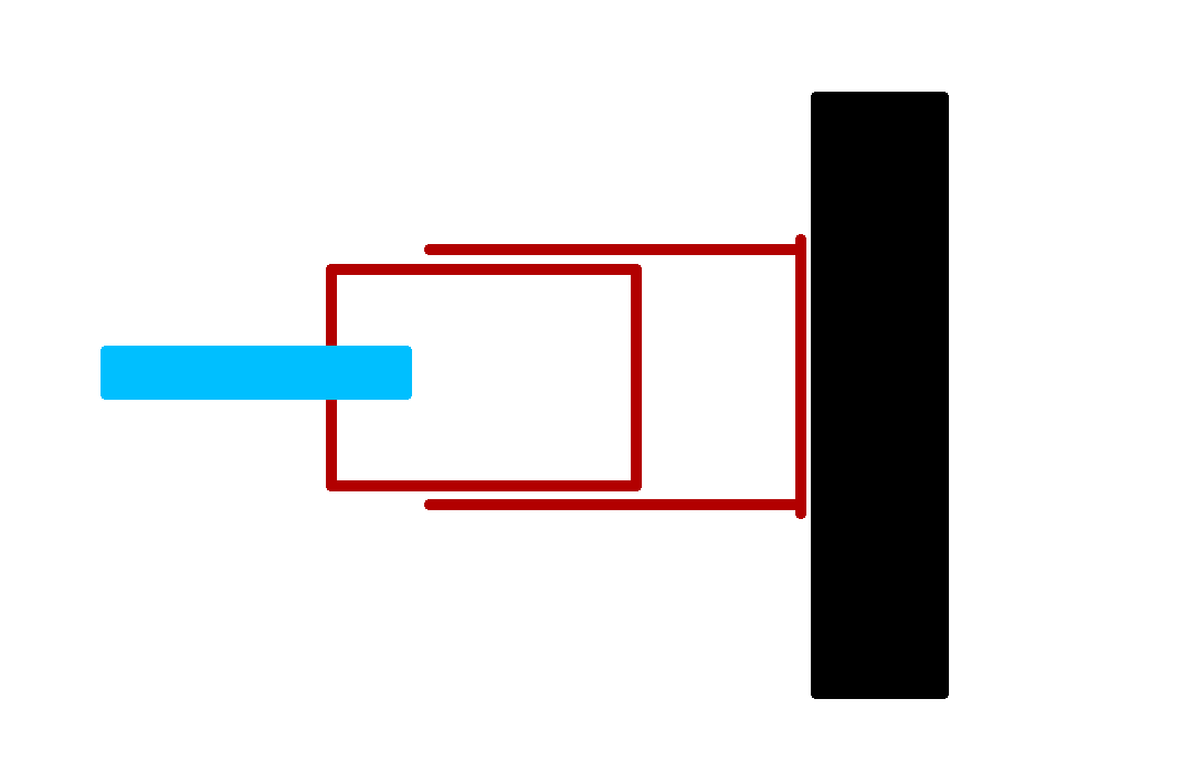

The badly drawn image is from above. The blue is the glass, the red is both the box section and wall channel. The black is the wall.
In theory, if any water enters from above it should drain into the shower tray, hence the reason why the inside should not be siliconed.
