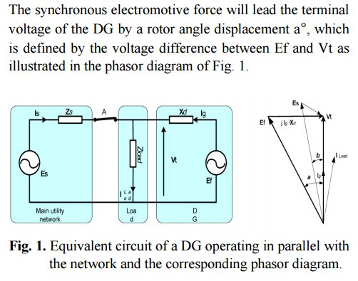

John, Bit of an explanation here: https://pure.qub.ac.uk/portal/files/868297/03-2006-JA-PS-1-020[1].pdf I have to admit I can only take a away a fleeting overview of how it actually works from that, the maths is a bit beyond me, I never understood calculus of anything but the most basic functions ...
Many thanks. At a first glance, the maths is not a problem for me, but I need to spend some time reading the paper properly.
However, also at first glance, it looks as if this may well answer my question, and somewhat support what I've been saying. This bit of text and 'phasor diagram' (and the corresponding Fig 2, in the 'islanding' state) ....
... indicates that the islanding state is essentially detected on the basis of a change in the phase angle "a", which is a function of the difference between Ef and Vt. The existence of that difference to exist relies on the presence of Xd, which is therefore seemingly the 'something' that I have been postulating has to exist between the inverter supply and connection to the grid - since, in the absence of Xd, Ef and Vt would be the same (hence zero difference between them), under any/all circumstances.
However, as above, that is all based on a very quick glance at the paper. I'll have a proper read and will comment further if necessary.
