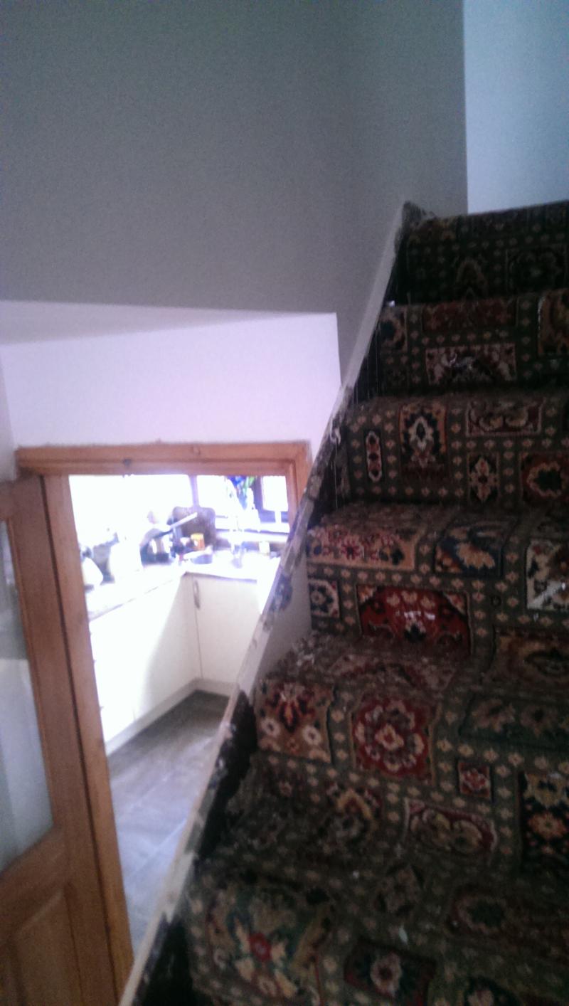

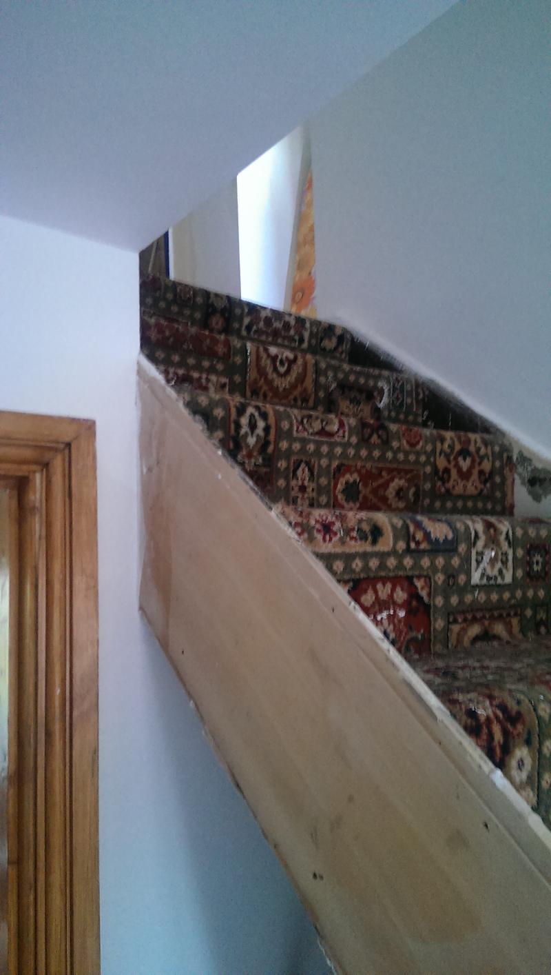

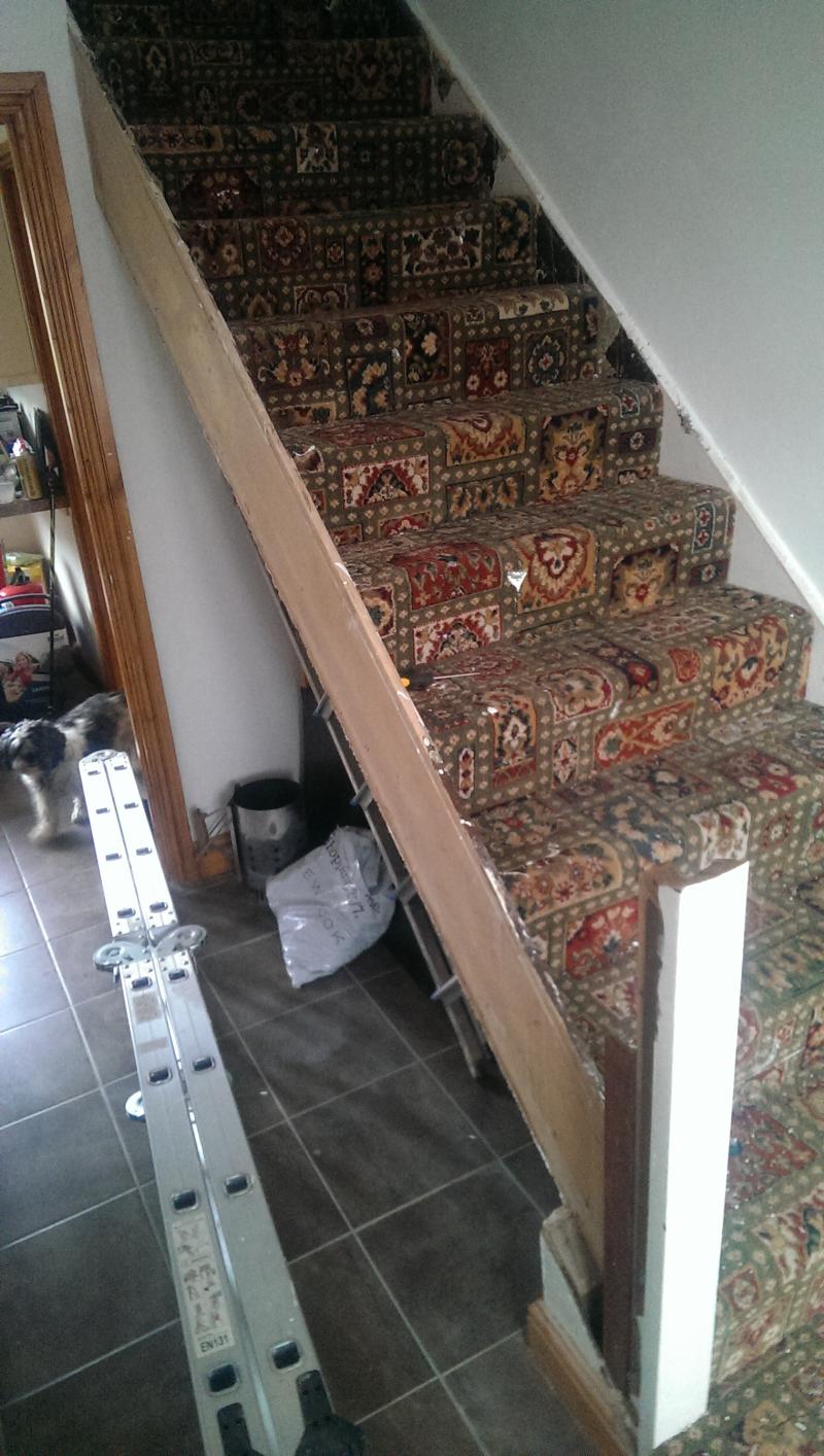

I was looking for some guidance and assistance here if at all possible. I'm looking to put a new handrail, baserail, spindles and Newell posts etc on my staircase (please ignore the carpet!! It's a rennovation project, honest). Hopefully as you can see from the pictures, the wall only goes up half way so I am unable to fit a half Newell post etc at the point where the wall cuts off. I'm just stuck with how I can do it, I'm unsure how I could have it towards the top with the wall cutting it off, the handrail would be tiny (and might look a little silly).

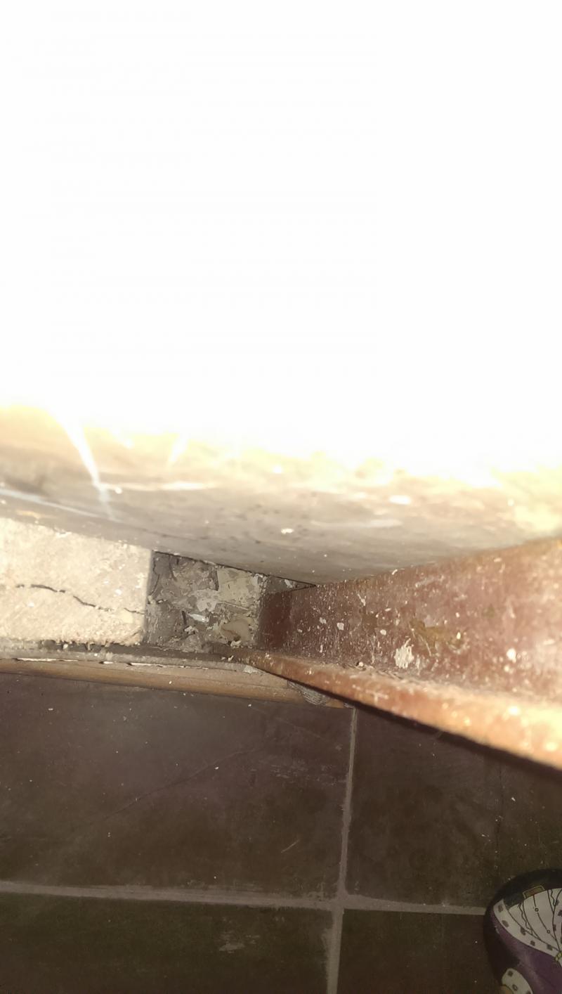

Also, the old Newell post was part wood, part steel or iron and is cemented into the floor. I've tried to take a picture below. Would anyone have any ideas of how best to remove it?

Not quite understanding "wall only goes half up" re: the angle iron/concrete base, have you tried hitting the metal with a sledge hammer side to side, to see whether it will slacken?
Looking at your pics it looks like you need to cut the top newel post so that the upper part is half thickness and screws against 1st level wall! ...pinenot :)

Thanks for your reply. RE: the iron post, I haven't tried that, simply because we made the mistake of laying new tiles before deciding to have spindles etc, I'm worried about any damage brut force will cause...I have since looked on Google and how found a similar situation but someone used a reciprocating saw? I think I'll try that, see how it goes.

Here's a sketch of what I mean
hope this helps, it's not an easy cut by any means, but that's how its done...pinenot :)
