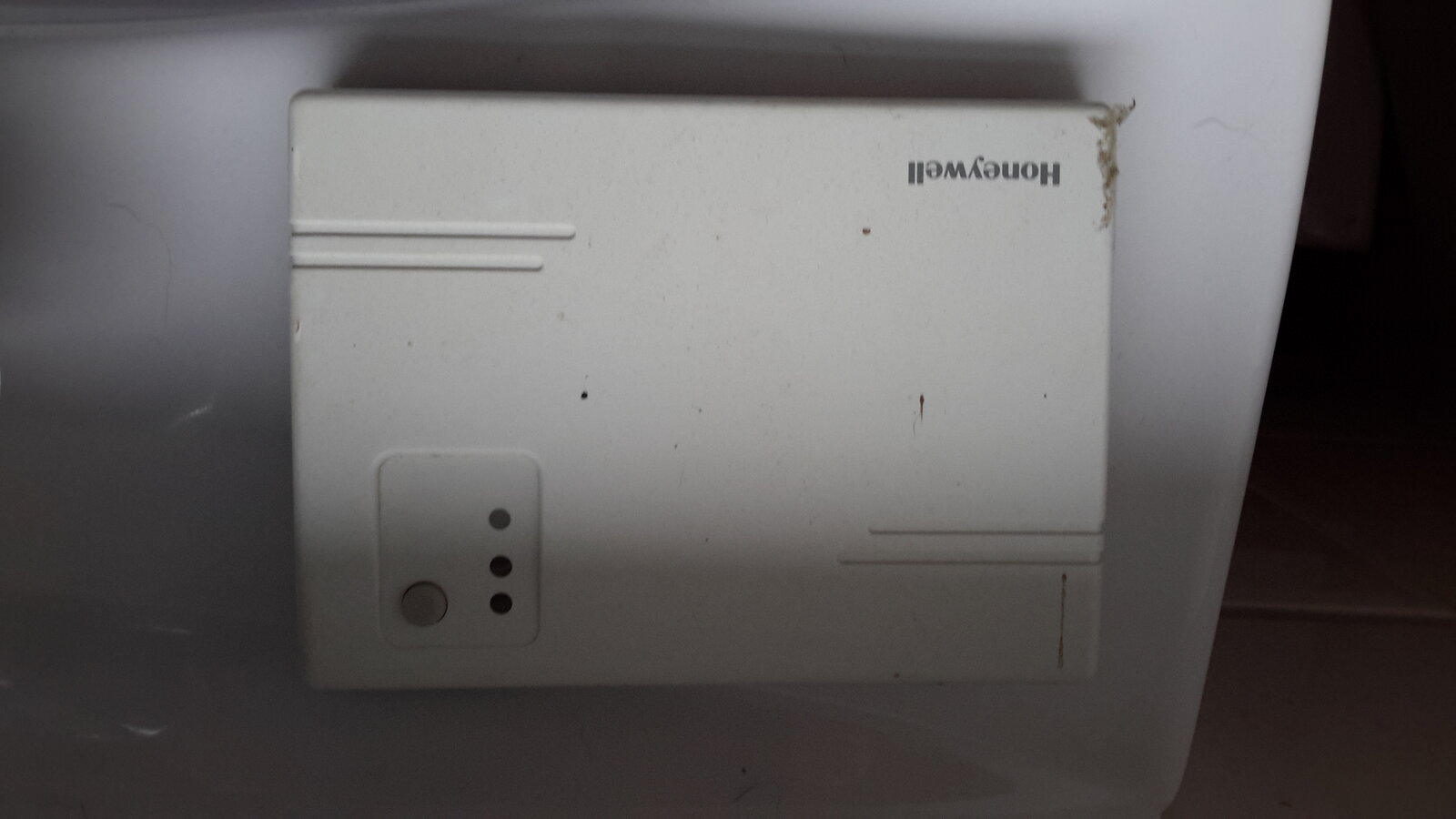

Our honeywell has stopped working boiler end
We've been quoted a lot to have it replaced, small job clearly no interest.
Thinking surely I can do this myself;
- Wire in replacement
- Conect to new wall thermostat
I'm not interested in a smart router attached option.
Cheers,,,,,Q

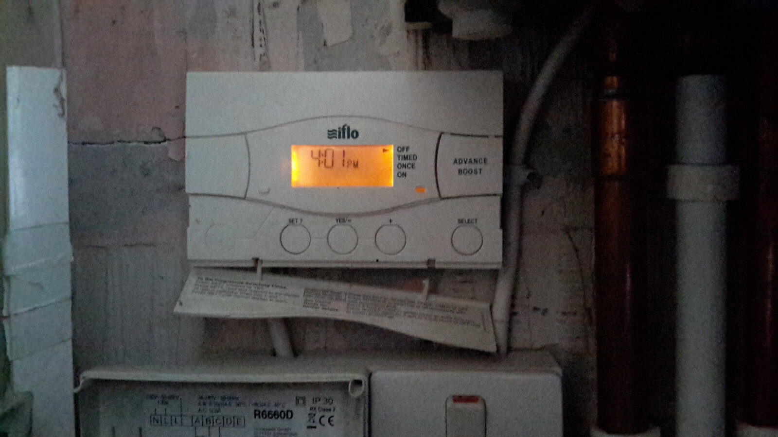

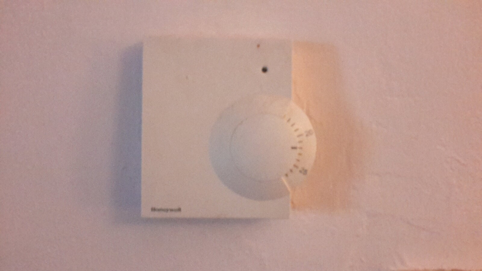

It looks like you have a Honeywell R6660D Receiver, and Wireless Battery Operated Thermostat. The wires are connected to the Receiver and the Thermostat communicates with it wirelessly telling it to turn the heating 'on' or 'off' as required.
If you want to leave the existing 'iflo' timeswitch (actually a rebadged Drayton) in place and just replace the thermostat and receiver you can do. If you go down that route you can buy a new wireless receiver and thermostat and simply replace the those you have. Or...
...Buy a simple wired thermostat which will replace the existing receiver and thermostat, but you may have to run a new cable from the receiver to the location of the thermostat. Or...
...do as @Alec_t suggests and replace the 'iflo' timeswitch and existing thermostat with a programmable thermostat that contains both functions in the one device.

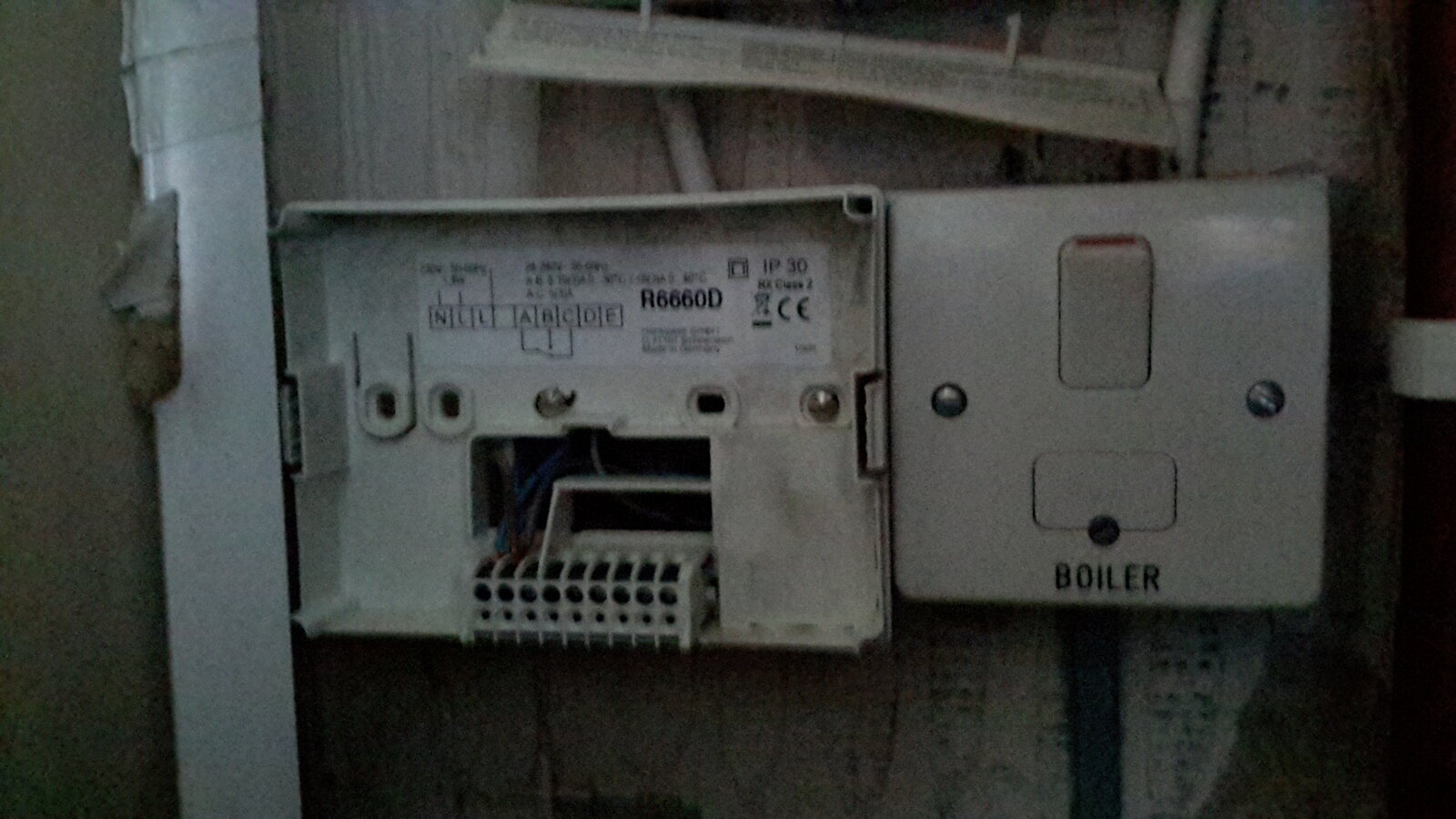

For DIY a new new wireless receiver and thermostat would probably the easiest option wiring wise. Although from your photo of the R6660D receiver it appears some wires have been removed from A & B, I assume this is to get the heating working without the thermostat, you will have to reinstate them.

You can buy a replacement R6660D receiver swap them over and then use the 'Teach in' facility to link it to the existing room thermostat.
Are you 100% sure that it's the receiver that's at fault and the thermostat is OK? if not you would be best to replace both items. You can buy them as a kit.

The thermostat still lights up, but when I switch the other item off, then on, lights light up, then red, then off, nothing.
