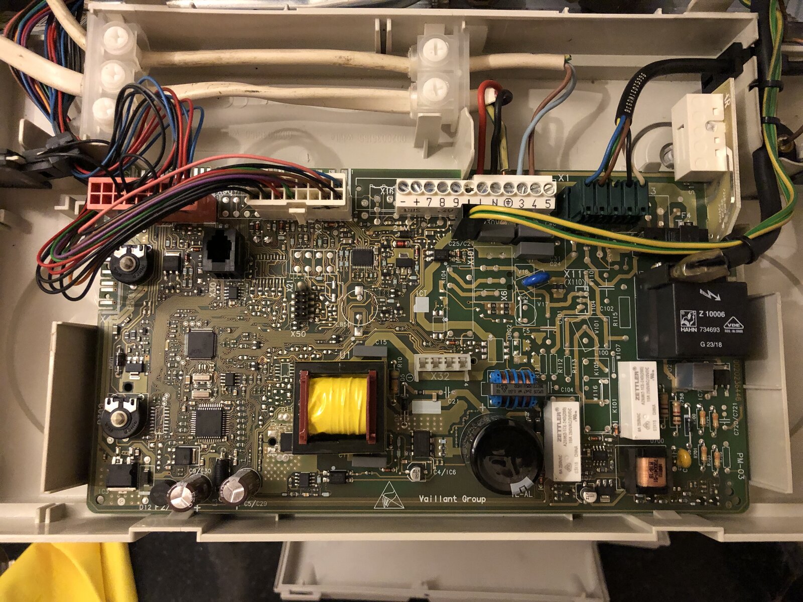

I'm replacing an old Honeywell CM907 thermostat with a Drayton Wiser smart thermostat.
img_2087-jpg.246191
The current thermostat is wired directly into the boiler (Vaillant EcoTec 831) and only uses a live a switch live. The new thermostat requires a neutral wire. I don't know how to wire in a neutral myself, is there a way around doing it?

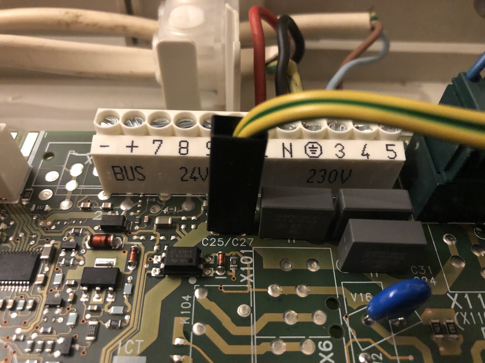

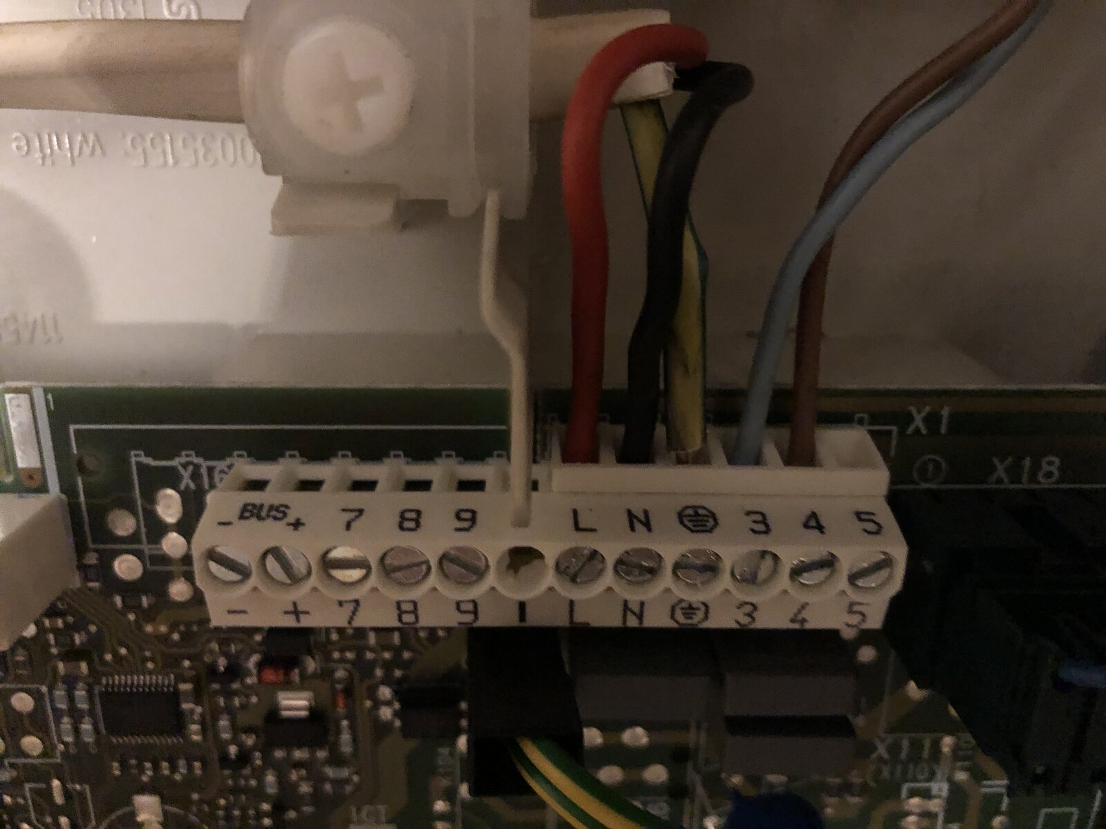

Thanks for the response. That sounds like a good plan. I've opened up the boiler and you can see the live, neutral and earth of the power supply to the boiler. The thermostat is connected to 3 and 4. Can I just connect the blue core to the neutral of the power supply or should I move the live and neutral to the same L and N of the power supply and just use the eath as the switch live on 3?
Personally I wouldn’t use the green and yellow (earth/cpc) as a live conductor, even though you plan to sleeve it. The mains in for your boiler is on twin and earth (not generally suitable for inside a boiler), but you could obtain some 5 core heat resistant flex for your thermostat, piggy back the live and neutral so they are permanent, then 3 to com and 4 to On, connect the earth and the other end in a choc block to keep continuity.
The cover on your boiler forms part of the combustion circuit, so recommended to get it checked for safety afterwards.

Agreed sleeving the yellow/green core is not ideal but the flex at the stat end looks buried in plaster so replacing it may be a significant task if it is remote from the boiler.
I'd advise leaving the brown core where it is for now-that way it is protected by any internal fuses in the boiler- move the blue core to neutral and use sleeved green/yellow to 3 at the boiler end.

Thanks for the help everyone. I followed the advice to get new flex and wire into the boiler locally. Works a charm
