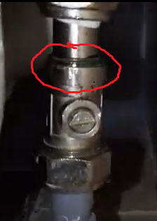

Next issue... The water inlet ball valve isolater seems to have developed a leak, see picture, it seems to have a short bit of pipe fitted to the top of it to extend it. I cant solder etc so id there a good solution for a diy'er here please? maybe a flexi fitting with a isolation valve in it?

Will do thanks. One more question, when I tighten the top nut on the isolation valve the whole pipe spins, how do I avoid this please?
Will the valve come off the plastic pipe ok? can I reuse the plastic end? What connections either end should the valve have please?
Valve will come off, but do you need it to?
Yes you can re-use plastic end, if required.
1/2” top end which connects to fill valve, 15mm compression other end.
