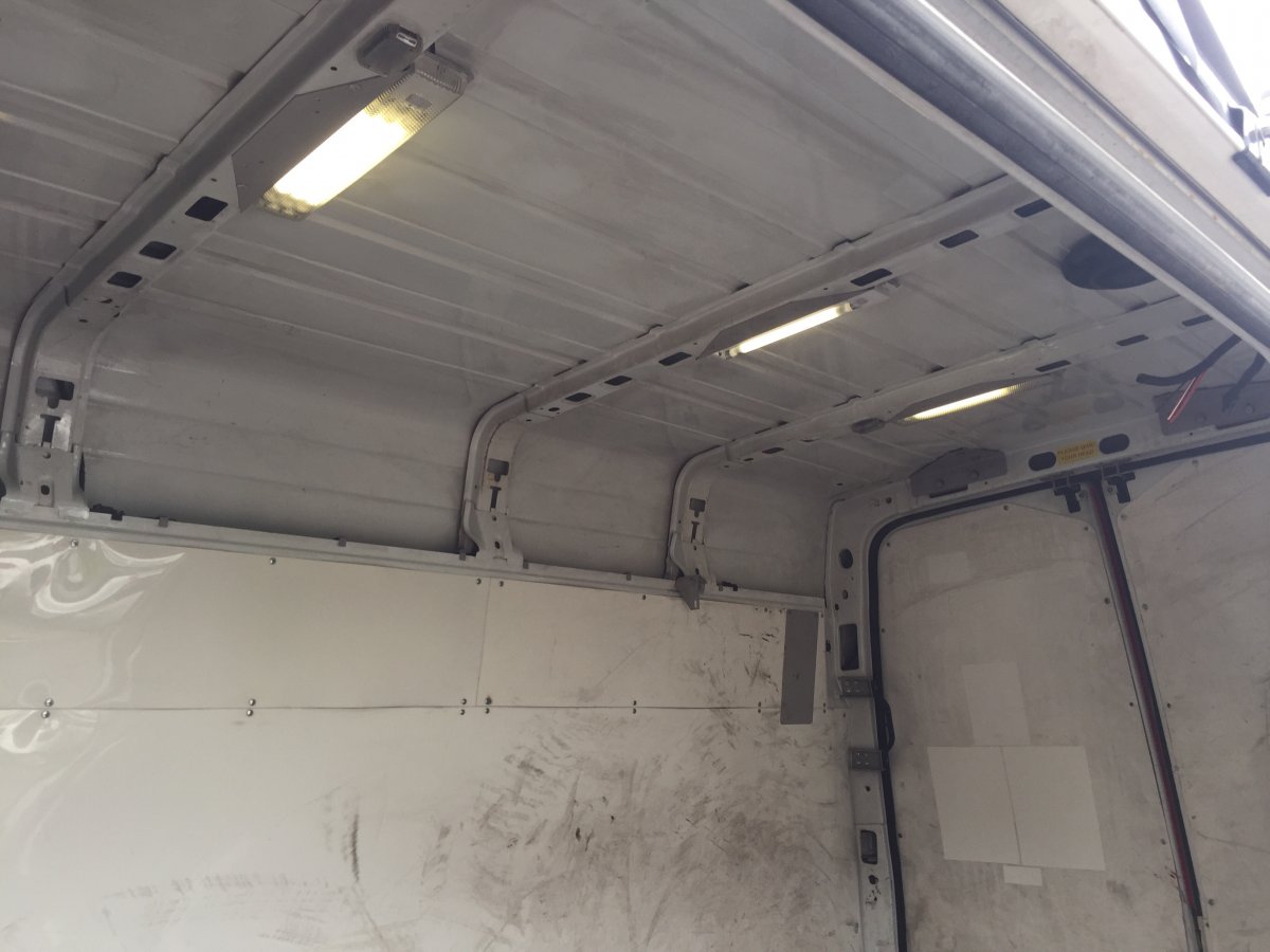

Love me new van but need to sort out the electrics.
It had a load of electrical extras, some of which were removed pre sale by the fleet owner.

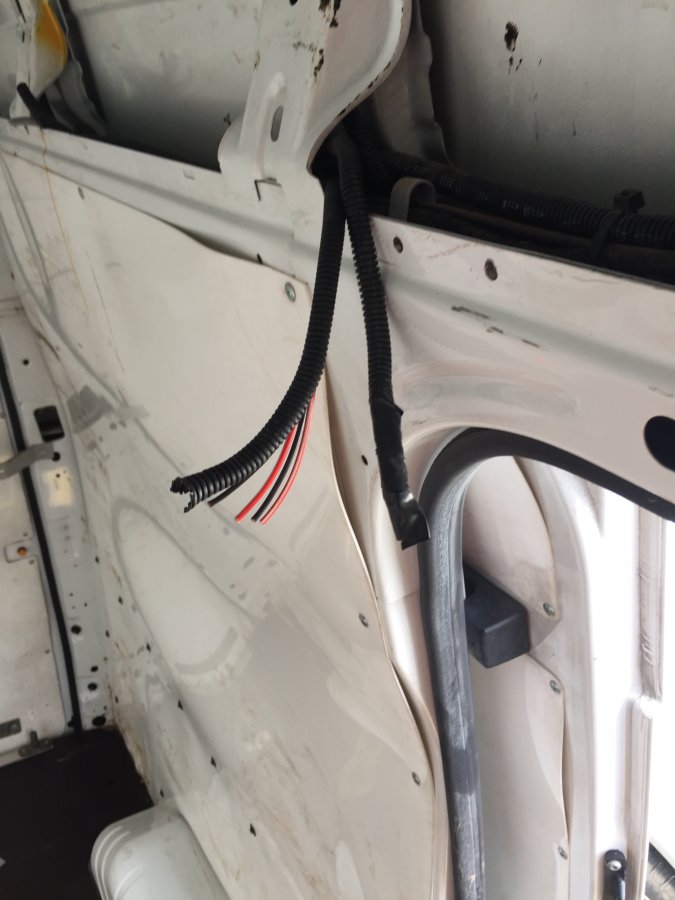

Inverter; beacons; rear work lights; water heater and cab heater were all cut off and removed.
The loom is all still there, but with 'open' ends. There are labelled switches on the dash, an isolator for the inverter, fuse holder from the batteries to isolator, double plug socket outlet with RCD protection mounted to the bulkhead, 'blue sky' auxhillary fuse board in the cargo bay, reversing camera and LCD, fluorescent lights in the cab and cargo bay - these remain.

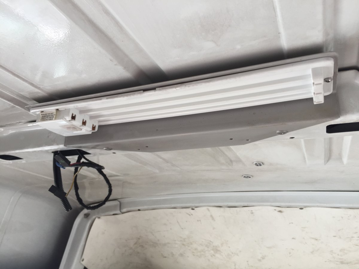

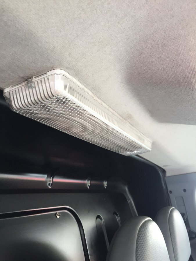

Over time, I may reinstate some of the above but for now, my main aim is to get the interior fluorescent lights working in the cargo bay and cab, as there is a fault which I suspect is to do with unterminated 'ends' from the removed components!
I've carried out some testing with my self priming digital multimeter but vehicle electrics is not one of my best skills and I have limited knowledge!

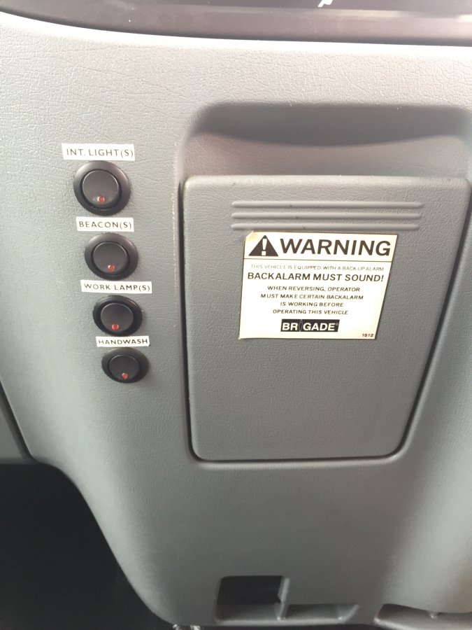

When I attempt to operate the lights, using the dash master switch I get one tube in each of the 3 cargo fittings coming on very dimly AND the reversing alarm/beeper sounds. Rocking the switch again, stops the alarm but kills the lights completely, further operating the switch repeats this pattern!
I removed the tubes from the fittings, checked the fuses in the auxhillary fuse box and am trying testing with my meter... ONE probe of the meter on the positive pins of the fittings gives a fluctuating reading of 28-45v DC! but that's just one probe, I'm not measuring across the pins! The other side (earth ?) gives no reading.
Can anyone guide me where to go next as I am a tad confused o_O
Your spurious readings and operation of the various fittings points to faulty earthing.....very common in vehicles where those horrible crimps are used in place of solder and heat shrink.
If it was mine I'd seriously consider removing all of the cables that aren't needed by tracing them back to source - and then starting again.
If you look carefully at the battery positive terminal, are there any cables that don't look like manufacturer fittings? I find them all the time.
For rewiring the equipment you need again, consider starting at the battery with a short length of cable which goes directly into a fuse and then continuing on to your interior lights or whatever - this way the fuse will pop before any damage can be done.

It's been properly outfitted by a specialist company and as burnerman says I reckon it has to be an earth fault somewhere.
I can only think that the reversing alarm is linked into the lighting so that you are aware the rear working lights are on if you try to drive off!

Its a nice looking installation, professionally fitted (if not professionally removed!)
You can see where the red battery feed +ve comes in at the bottom, and the black earth return at the top, so check for battery voltage across there.
There you can remove each fuse at a time to identify each circuit in turn and probably keep those dash switches too. One relay is probably to do with the reversing sounder......it will get its input from the reversing lights, and then the relay will then switch its required current. This will have its dedicated fuse too.

Yep. Thought it was a proper job too and that fuse board is where I started! It's a marine type product from BlueSeas, so looked them up too.
Anyway... Must be because it's Fathers' Day as, following a couple things you guys posted, I tilted the drivers seat forward again and took another look at the batteries... And then I saw it! dirty great black lead disconnected from the neg terminal of the battery with a rubber 'boot' covering the 'eye' connector so I didn't see it on first visit!
Hooked that back up and all is working with remaining components as it should.
I then removed auto fuses from the aux fuse board so that all the robbed circuit don't have live wires swinging around in the back!
Happy days! I'm off to the pub now...
Thanks a lot Chaps, it was a magic fix after all!
