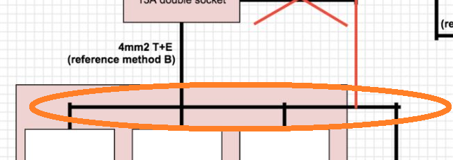

There is no ring - either necessary or required (quite the opposite) - nor in your drawing.
As said, RCDs will be required.
Are there no lights in this loft?
What is this?
I have altered the diagran to show an acceptable method.
Should I post it or would that be inadvisable?
What is this?
Light is connected to the light circuit, im not taking it into account.
Whole house is protected by two fixed RCDs in my original CU.
This is a busbar which connects MCB to 10mm2 going down to the CU, although i will leave this for a sparky to design.
Hi. Im trying to design a new ring final circuit for my loft. Can someone please have a look on this draft and assess if there's something wrong in it, etc? I've got no experience or knowledge in electrics and dont know much about Building regs.

From a design point of view, your design is over complicated, and down right dangerous.
Yes, ive already acknowledged that. Now i actually feel bad about wasting my time to design it, because i found that there's a ready-made solution which i could have fitted and it's called "Caravan Hook Up point".

But all that is is a small enclosure with an MCB & RCD, or RCBO, supplying an IEC 60309 socket - how on earth is that what you need in your loft?
I'm really struggling to understand what you think you need, and why.
And don't forget the aircon.
Just run the pair of 4mm² in parallel to a consumer unit in the loft protected by a 45A MCB at origin if installation method permits.
OK lets completely forget about my design and start from scratch. I need two 16A and two 13A sockets. I need those sockets connected to mains through switch/switches like this http://www.vesternet.com/z-wave-aeon-labs-heavy-duty-switch. Lets keep it simple. Can I just tell my electrician to install one of those caravan hook up units plus two sockets? If that's something I'm looking for, then it would safe time and money for both of us.
