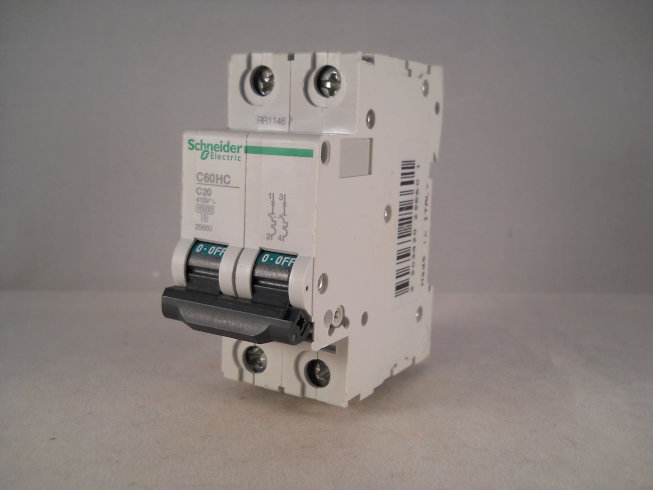

When I first moved to the UK, ring circuits seemed a bit unusual, we only use radials in Canada in house wiring. Although ring finals seem to have a lot of benefits, I don't think they would be legal in Canada with a 2.5mm cable because you cannot use a 32A breaker to protect a cable rated less than that. Although there are 2x2.5mm conductors, if the ring is broken or if a contact becomes high resistance, it is possible that 32A could flow down a single 2.5mm conductor and be overloaded.
Assuming there is space in the consumer unit, why don't they don't use duplex breakers (2x20) so that each end of the ring gets its own breaker? and the cable is fully protected even if the ring breaks?

In their defense, ring finals do have some advantages. Load flexibility, redundant grounds, lower resistance, etc. And one of the main drawbacks/safety issues could eliminated by using double pole 20A breakers instead of a single 32A. Given that breakers are cheap, the question remains, why don't they do this?

No domestic consumer units will accept duplex circuit breakers, and contriving such a circuit would require far more effort than using radials.
It's adding complexity and cost for no reason.
If you used 2 20A breakers you would not need a ring. Make it 2 radials.
Is that true? I don't have enough experience here to know. In Canada you can also use a pair of single breakers and a handle tie. If you look closely you will see the one in the picture has a handle tie, even though the body looks like two breakers molded together.
