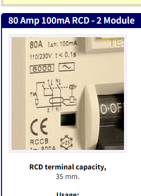

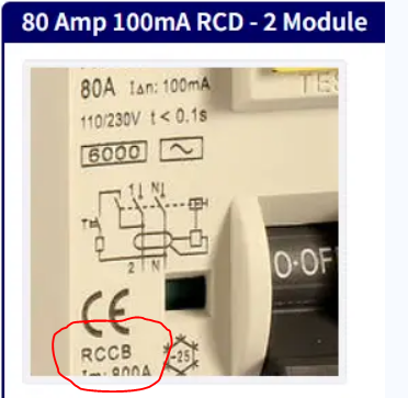

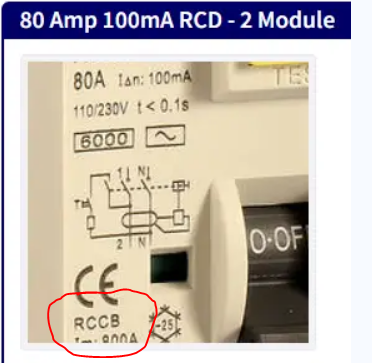

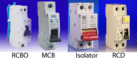

To be fair, TLC call it an RCD on their website. If it walks like an RCD, quacks like an RCD then it might actually be an RCD or an RCCB. I don't think it matters for this thread though.
View attachment 316779As said what is tripping? If MCB then not looking at water.
Surely water in contact with a live piece of equipment, (cable, circuit board, relay etc), will cause an MCB to trip?

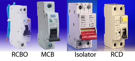

He hasn't mentioned anything about an RCD in the board, so assuming there isn't one protecting this circuit, something has to protect it against an earth fault.
Yes, lots of people get things wrong.
It is an RCD but then so is an RCBO - so it is no good asking if something is an RCBO or an RCD.
