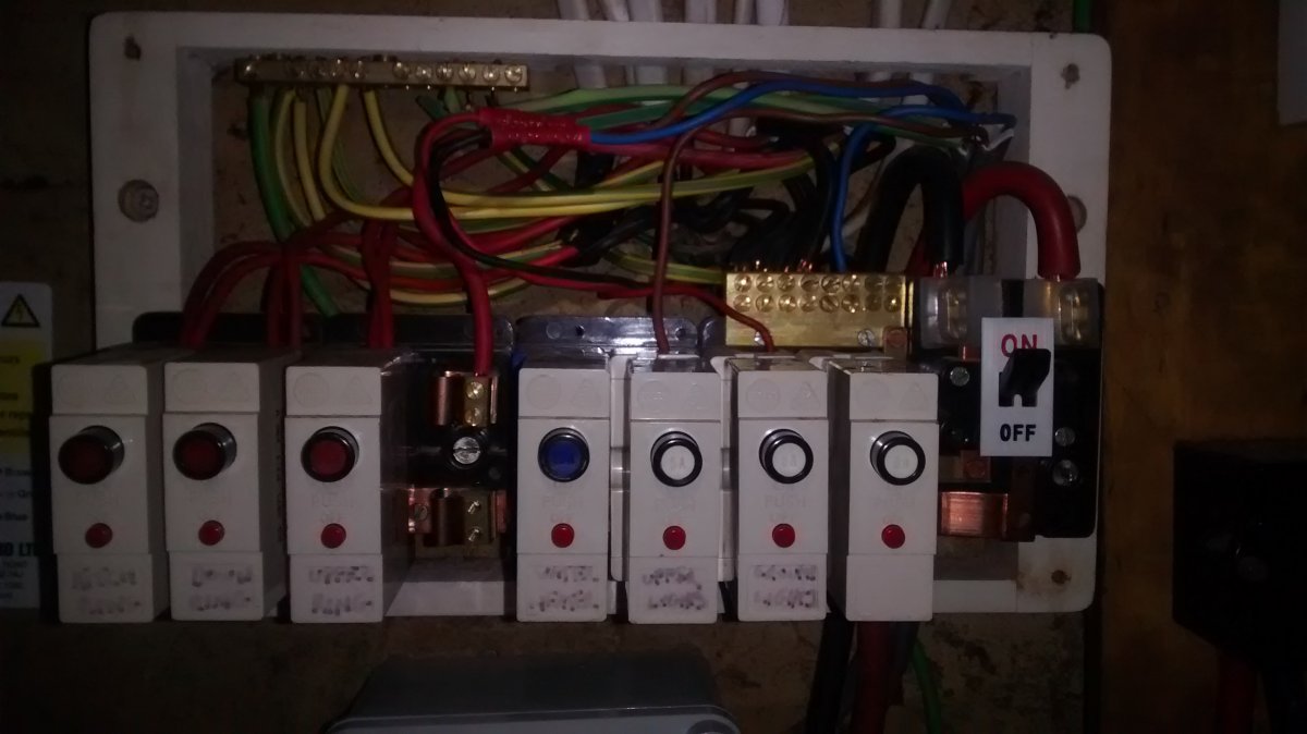

The other day I put a junction box in my lighting circuit. The circuit was off (it was tripped but the circuit breaker was in place), but when I went to turn it on the power wouldn't come back on.
Trouble shooting wasn't obvious: power was going into the circuit breaker, it appeared to be crossing the circuit breaker, but it wasn't reaching the first junction box on the circuit. A multimeter showed a current going across the circuit breaker, and swapping the circuit breaker for another working circuit breaker (from another lighting circuit) didn't solve anything either.
I called an electrician who perform some wizardry at the consumer unit. He said there were black marks behind the circuit breaker at the consumer unit (not sure where) and suggested I'd shorted the circuit when I cut the wire, but wouldn't show me what he did to fix it.
I've now had another mishap and shorted the oven circuit. The circuit breaker tripped, but power wouldn't return to the circuit when I switched it back on (no sign of life from the oven; no power detected by a non-contact voltage detector on the cable where it meets the oven).
This appears to be exactly the same as the problem with the lighting circuit: power is going to the circuit breaker and appears to be going across the circuit breaker, but not reaching the appliance.
In addition, the lighting circuit also doesn't work as a result of the oven circuit blowing even though it didn't trip when the oven circuit tripped. Again, the circuit breaker looks fine and swapping it for a good circuit breaker (from another lighting circuit) doesn't solve the problem.
Does anyone know what's going on or how to solve it? Don't worry, I won't work on electrics again once this is sorted!
Okay can you upload a picture of your consumer unit?
If your are having tripping issues and the MCB (breaker) is still in the on position and you have lost power to some circuits but not completely lost power to all circuits. This would indicate that an RCD has more than likely tripped, RCDs can trip even if you have isolated the circuit you are working on.
Testing for current at the breaker is not what you would ideally be looking for, as it is voltage that is best measured and a non-contact stick/pen would be best substituted for a two pole/probe voltage indicator.
Here's a picture of the consumer unit. I did try to test with a non-contact voltage detector but it beeps as soon as it's near the consumer unit - it can't distinguish between different breakers. That's why I tested it at the back of the oven instead, but didn't find any voltage there.

Well there is no evidence of RCD protection, unless you have remote isolator somewhere else before the fuse board?
And you are saying even though the breakers are in the on position you have no power on the circuits, we first need to confirm that the breakers have not fried or become faulty, so you do need test at the output point of the breaker, if you isolate all other breakers you can test using the non-contact for voltage at each individual circuit at the board. But ideally we could do with the two pole version.
All those breakers are in the off position?
They are indeed! So to the OP have they been isolated intentionally or have you not been able to reset them? It is the larger button near the top of the breaker that needs to be pushed inwards for it to become live.
There is RCD protection, it's out of shot just below the consumer unit. I've switchrd it off and on but no difference.
I think the lighting breakers are okay because swapping between the good downstairs circuit and the faulty upstairs circuit doesn't help. I can't do the same for the oven. I also used a neon screwdriver to show there was power getting across the breakers when in position, and a multimeter to confirm continuity in the breakers. I'll do the testing you suggest once the others and left the house and I can isolate circuits.
Sorry, that picture was mid-troubleshooting when everything was intentionally turned off. All breakers are now in the on position except the oven - I've removed the breaker to be sure the circuit's safe as the oven isn't fully assembled. We have power everywhere except the oven circuit and the upstairs lighting circuit.
Don't use a neon screwdriver, they are unreliable and potentially dangerous!
If you have continuity and voltage across a closed breaker, then you are now looking for a loss of continuity upstream of the breaker, either down to damaged or loose conductor, this could be line or neutral (that is why you require two pole testing) or possibly faulty contractors on an isolator or an upstream fuse.
It would be worth checking that the line cable in the breaker is making good contact and the neutrals in the neutral busbar, also check earths are making good contact. As it seems some work has gone on at the board they may have become disconnected or loose.
