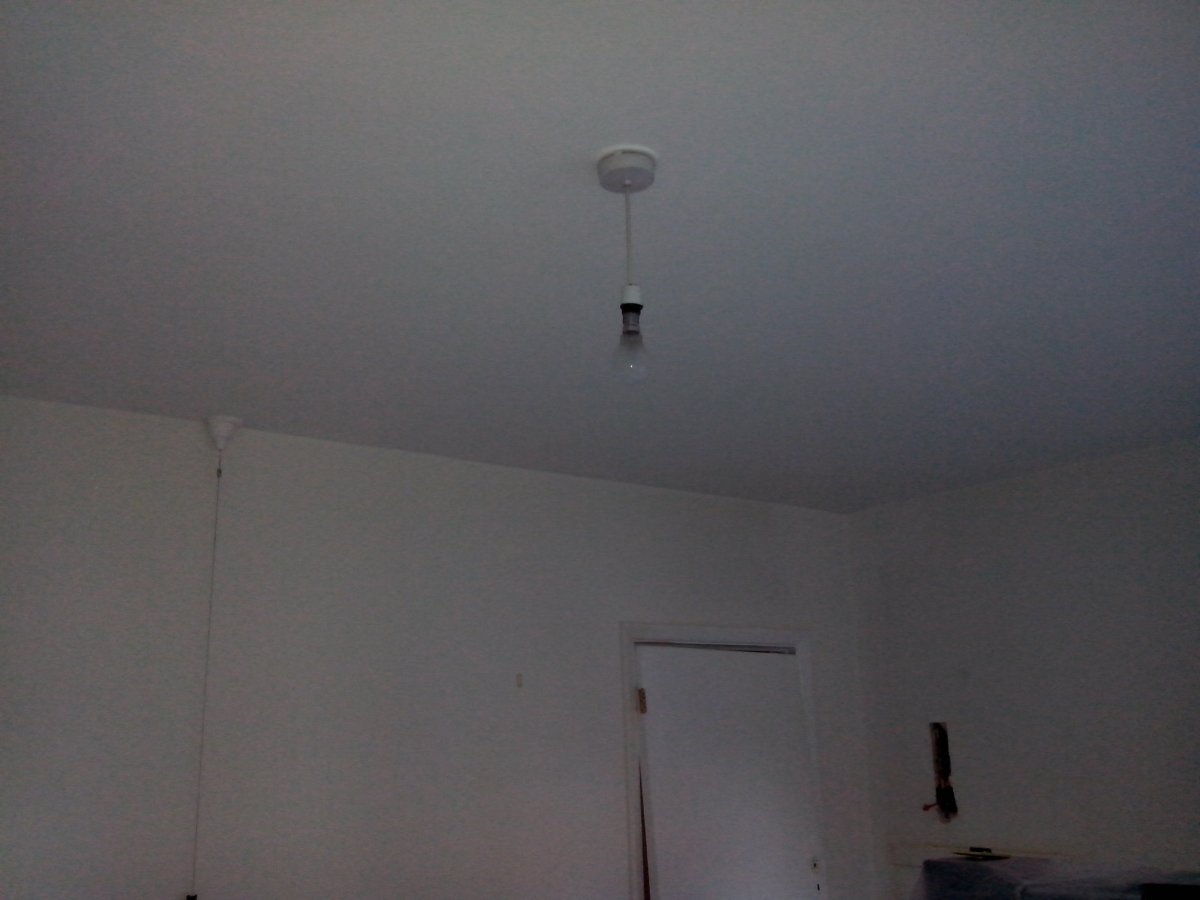

Here is the layout:
Pull cord on the left.
Switch hole bottom right.
Light centre of the room.
What does this tell you ?
It's honestly hard to say, the conduit MAY be continuous, and so allow pulling of new cables. But you are going to need to do all rooms, back to the fuse board (I am doubting it has a modern consumer unit even), and to the far end of the circuit.
Once you start you could run into difficulty if cables snag.
And I cannot answer about the earthing required for the conduit, it's beyond my knowledge.
