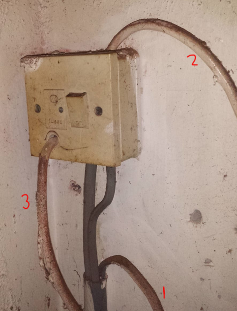

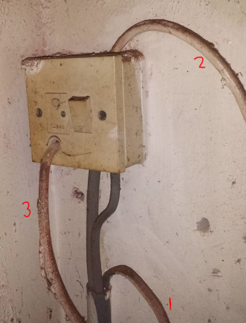

So accessing the pump area, I also discovered this fuse spur, which I forgot existed.
Screenshot 2026-04-10 at 02-58-31 (JPEG Image 1200 × 1600 pixels) – Scaled (54%).pngScreenshot 2026-04-10 at 02-59-12 (JPEG Image 1200 × 1600 pixels) – Scaled (54%).png

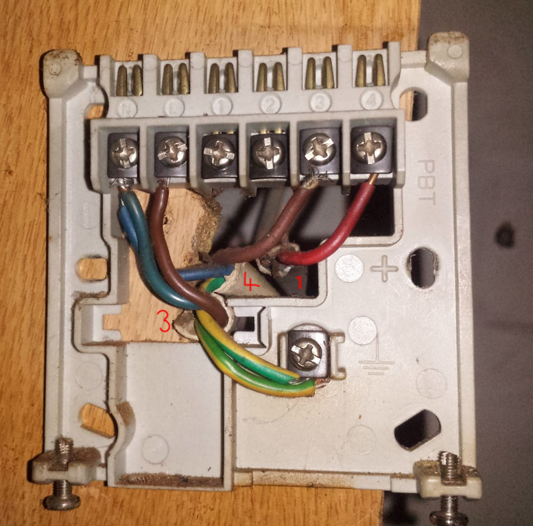

As I said, i energised the controller and did not detect a voltage on line and neutral.

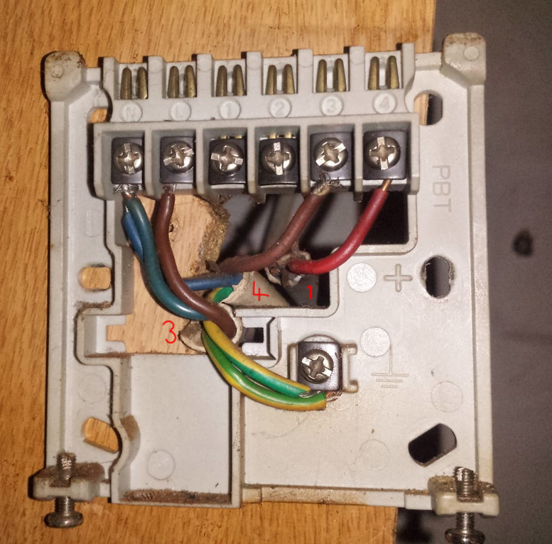

Now, this is the fused spur and the corresponding back plate to the controller.
As a precaution I tested the fuse in the spur and it was fine, but that makes sense as the timer/controller gets power.
1. Cable comes from conduit and ends up in the as the red cable in CH call.
2. This goes to the pump.
3. Goes to N L and Earth on the back plate
4. Goes to boiler from N, HW call and earth
So, at the moment, for some reason, power is not getting to the pump it seems.

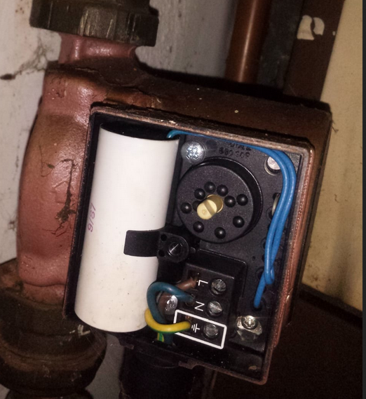

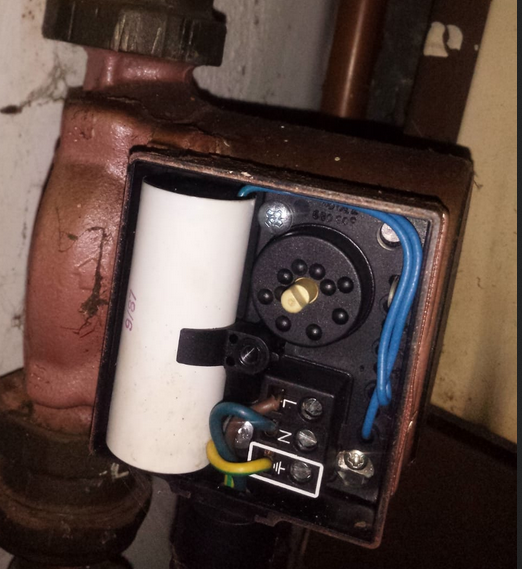

Edit: Just after posting this, I decided to double check the cables on the pump. The neutral seemed loose, and when testing the cable out, I got 240v.
I then re-interested (hoping this was the issue).....i powered up and called for CH I did now get 240v going to the pump! But alas.....no actual pumping.
So maybe I did get just just got an erroneous/mistaken reading on my first test, or maybe that neutral was loose. Who knows.
I opened the cap and gave the motor a manual spin (whilst energised) and it seems to spin fine.
From what i understand, it is unlikely to be the capacitor if I gave it a manual spin (while energised) and it did not power up.
So, the best option is potentially a compatible head replacement?
This system might be in for another year or so, so nothing long term is needed. Cheap and cheerful pattern part? Reconditioned Grundfos?
Are there any other things I should check first? Other cheaper repair options?

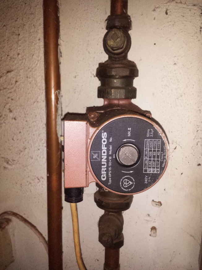

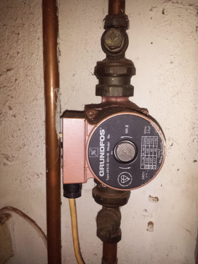

Pump did 28 years service according to the date stamp....not bad. As per the image it's a Grundfos UPS 15-50 x 18
