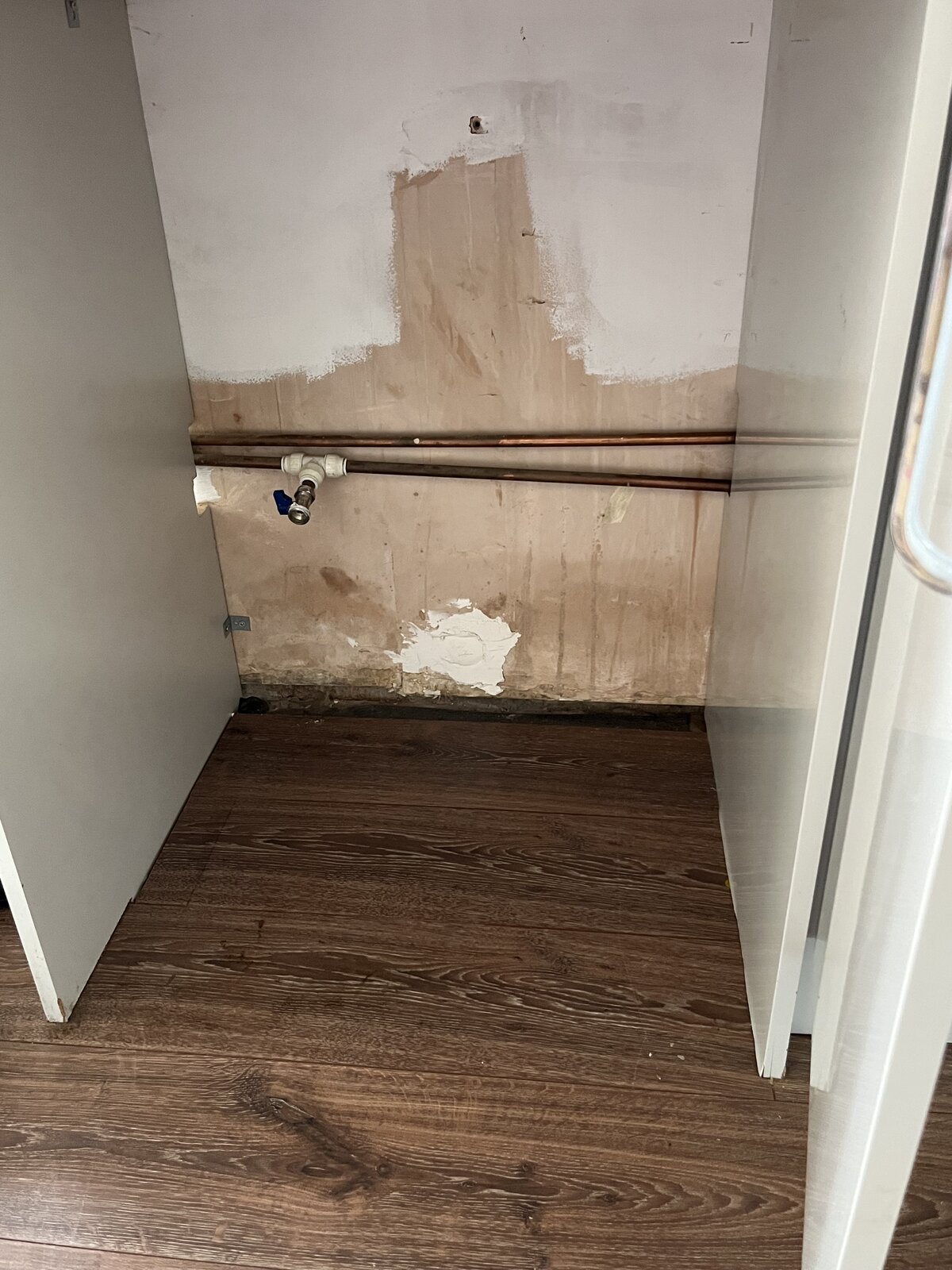

What is in the cupboard to the left of the under sink cupboard? Will the back panel pop out?

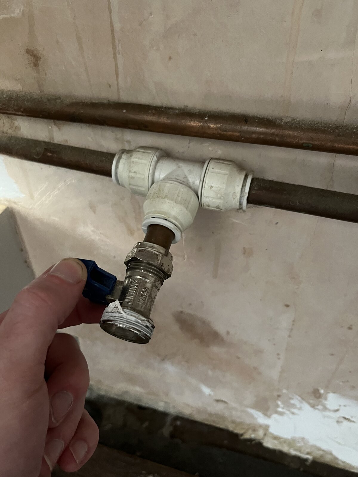

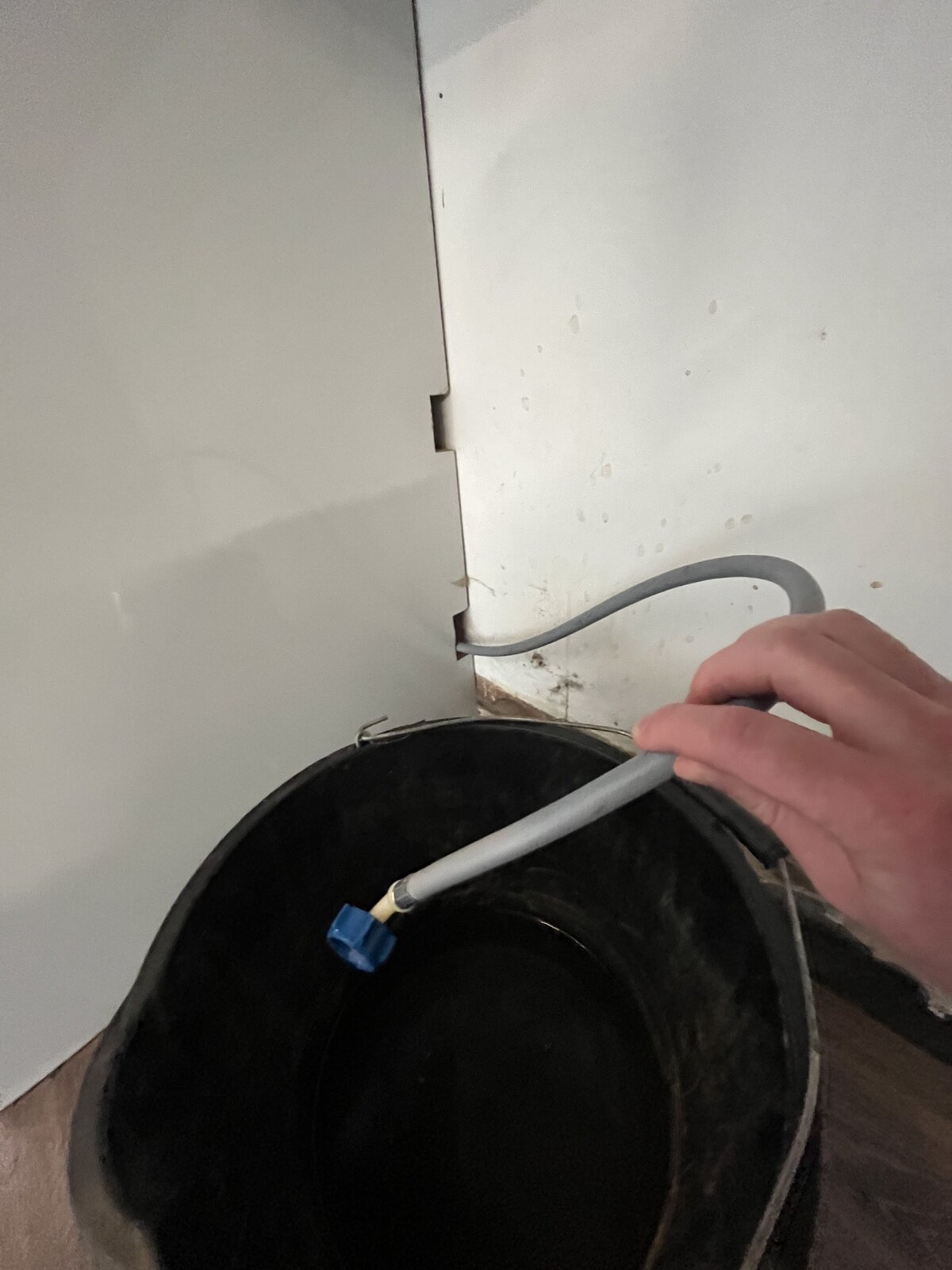

So this pipe, connects to the tap outside from what I can see
This pipe, is the washing machine connector but I can't see where this is connected too, but water is coming out of it when running the mixer tap not on it's coldest (so some warm is mixed in)

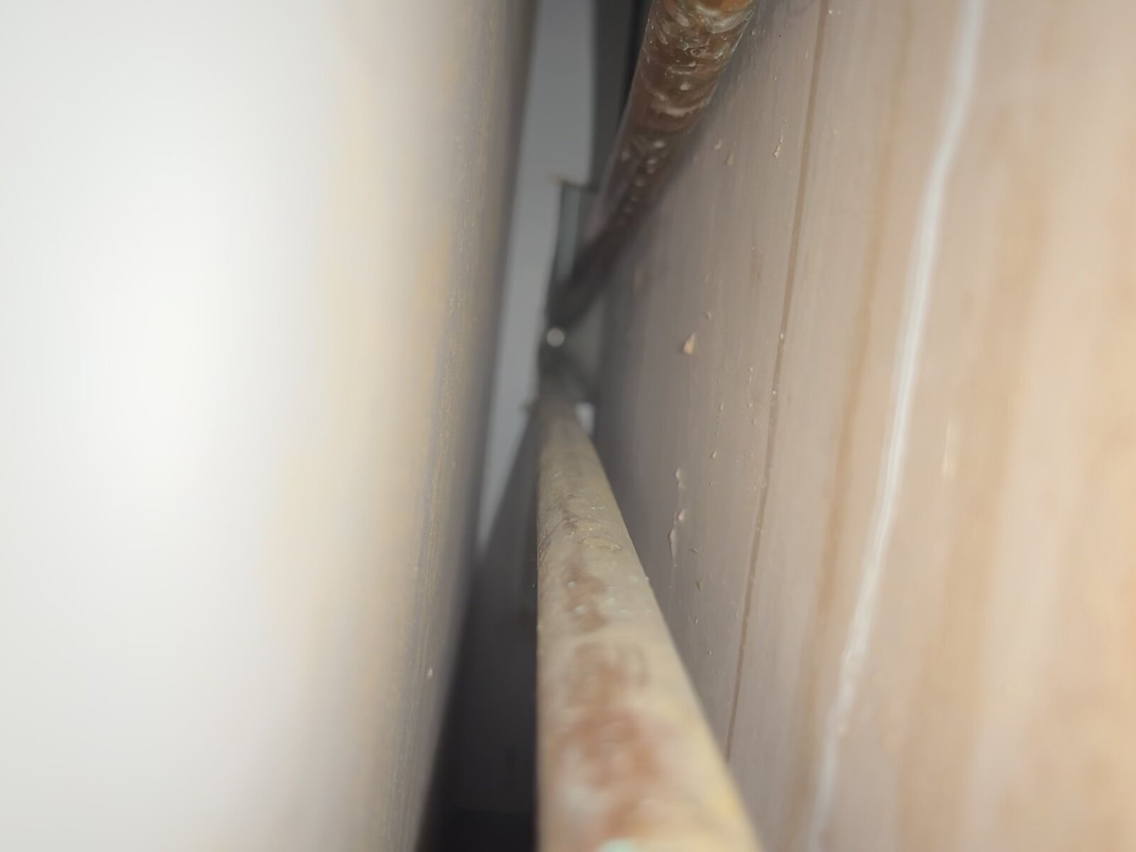

It seems that the only access is the hole in the back of the cabinet in your original pic of under the sink.
Can you get your camera in there to take picks ,left,right,up a down ?
Cheers for all the help, I’ve managed to get it somewhat through.

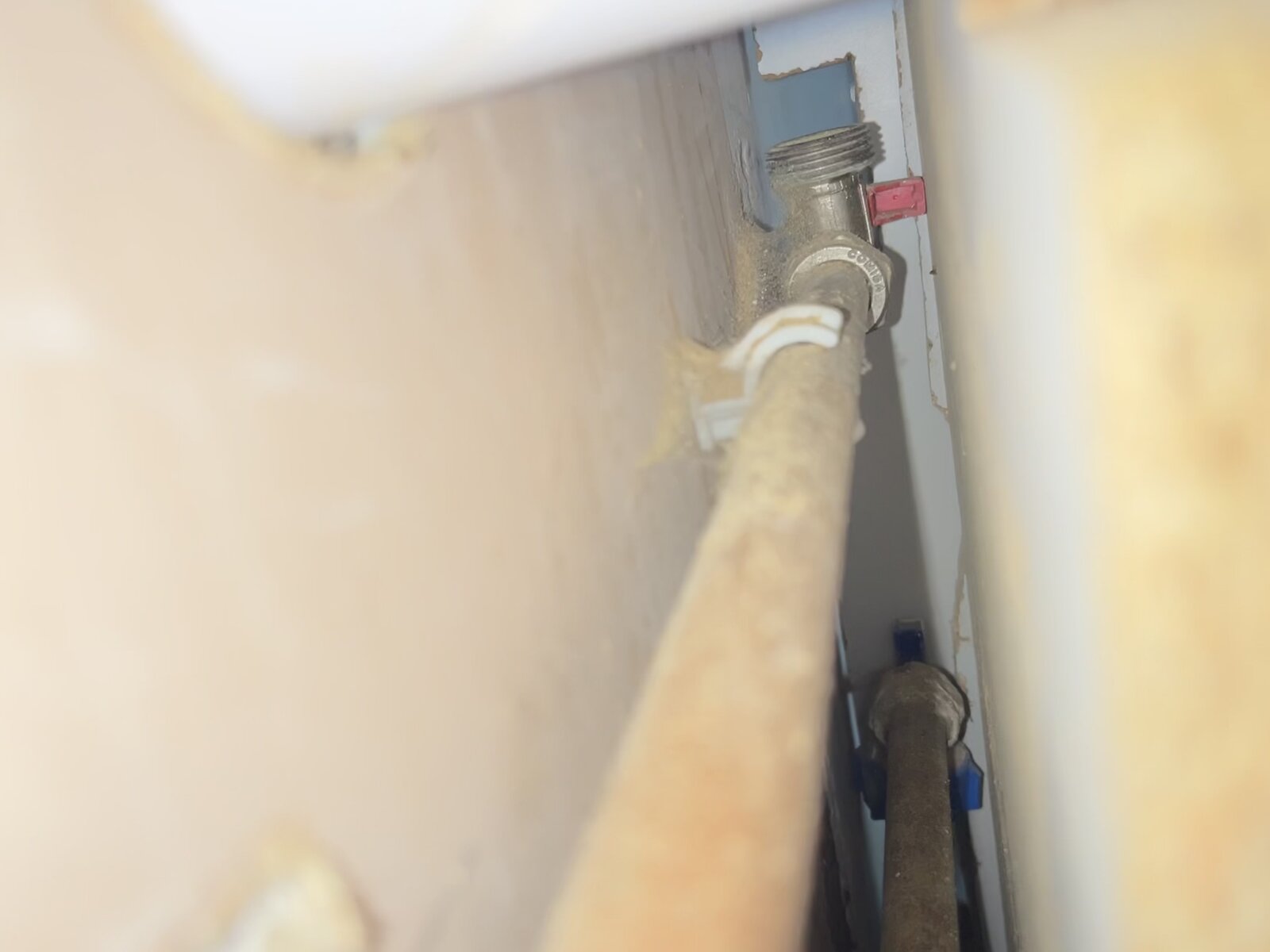

Right
Left
So doesn’t look like anything left but the right side is the interesting one. Looks like the washing machine is the lower connection. Then there’s a valve on the top?
But not a clue how they would have turned that off and I can’t access it without chopping into the side

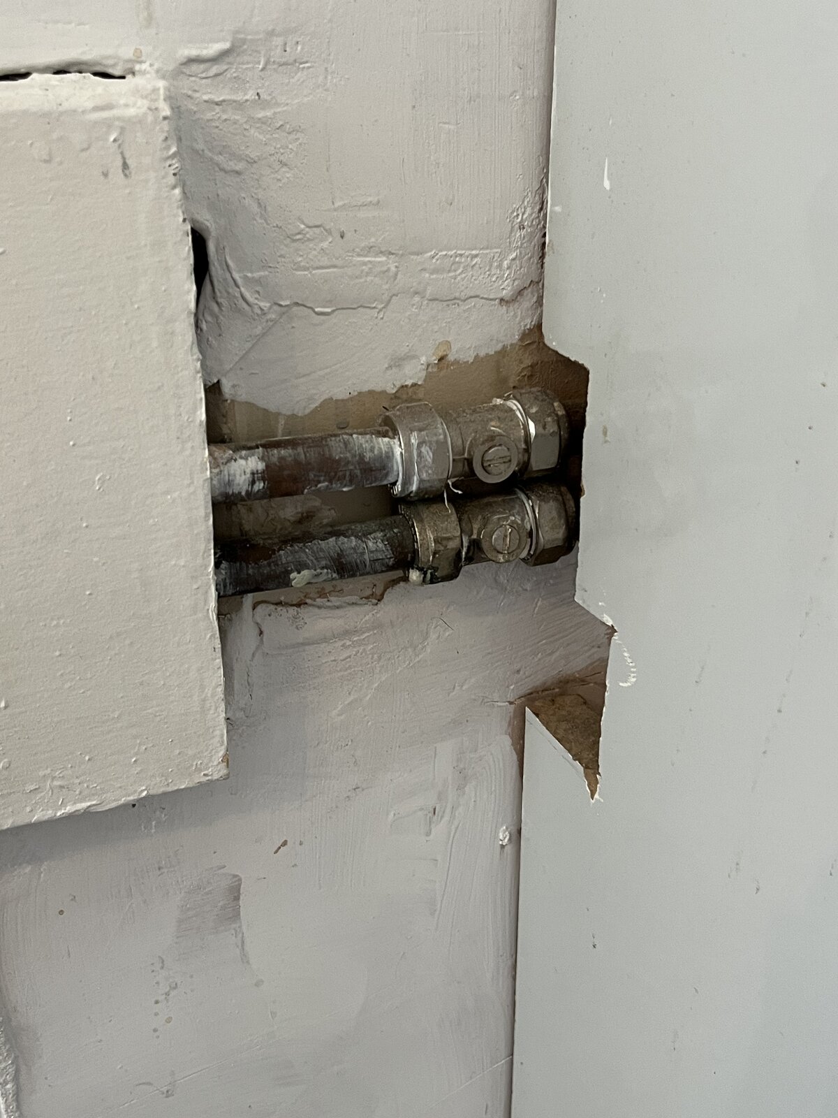

To the left is the dishwasher connection. I have had this in the off and on position too to test. The valve doesn’t seem that secure also.
Update - Had a response from the estate agent and the person who gave us the keys failed to communicate they’d turned off this bottom valve by the stopcock.
Thanks for all the troubleshooting though.

Your kitchen mixer tap appears to allow cross flow between hot and cold ,as hot water flows out into the cold pipe for appliance hose, which is not good.

You need a non return valve fitted on the cold feed to your tap ,and a piece of the cabinet cut out to give access to the washing machine valve. Both simple jobs to do if you have a bit of DIY skill and a few tools.
Unless that washing machines isolation valve is turned off I expect the hose flowed out water when you turned on the isolator that you discovered.
The non return valve on the cold feed, is that under the sink where the current valve is?
And you’re spot on, I thought it would and it did spurt water out so looks like the isolation valve is on
Yes ,you fit a non return valve on the pipe that goes to the cold tap of the sink,before the existing isolation valve would be simple to do.
