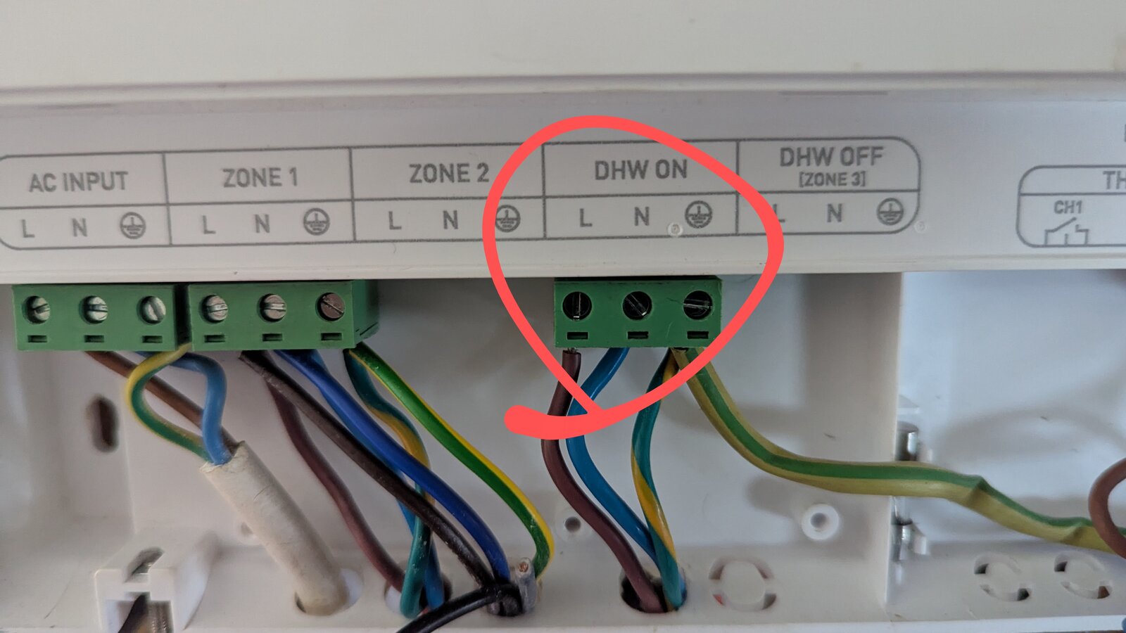

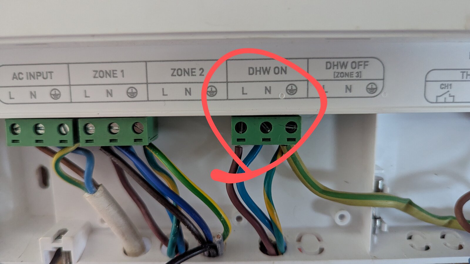

Thanks. I did wonder about that.
So the valve has 5 wires, live, neutral, earth, grey and orange. Live neutral and earth are all connected to the relevant connectors but but orange and grey are cut and disconnected. This is by design, the original installer has tapped over the ends of these so I know they have not become disconnected accidentally. I think this might be because the Navien wiring centre connects to the boiler wirelessly? So the switched live from the valve it not needed?
The only connections to the valve are as shown here.
Well, it took all day but I figured it out. Don't know how it happened, but the demand control on the boiler was set to thermostat - which I assumed was correct, but it actually needed to be set to"wiring centre". I don't understand how the wiring centre option works, but everything working as expected now. Just heated a tank of water and it switched off at the right temperature.
