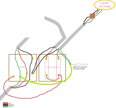

Aside from the wiring in the ceiling (which really needs sorting as already discussed), from the diagram, surely there is no earth connection from the FCU to the two gang plate switch?
As far as I can see, link the earth connection on the FCU to the earth cables going out to your lights (on the two gang switch plate).
Doing this will (hopefully) give an earth in the cable that can be chased from light to light, and joined back together or used if needed.

Would an earth connection at the FCU be needed from the 8 x Kitchen Lights which are all Class 11?
One thing I'm unsure of is that the 2nd switch going to the ceiling lights in the rear extension, connects up to a light fitting which is NOT Class 11 and has an earth connection (from the fitting as well as when connected to the wire in the ceiling). That earth wire at the other end is connected to a screw terminal inside the metal box. Is that sufficient/safe?

@Vincent80 basically you need an earth connection into every live terminal block or other termination. Whether the lights are class I or ii just says whether they will need the earth, but you still need it into the terminal block regardless. See efli's diagram for what you need to add for certainty.

Thanks everyone for your help. I'll run an earth from the fuse to the switch :)
