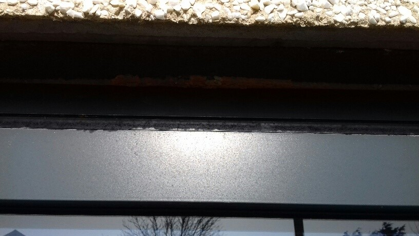

My daughter has now received the door seals in the post and had them fitted.
Just need to establish cause of water ingress from above the door frame.
Sorry about the dark pic, but it appears that the top of the door frame has been sealed with foam, but water is still getting through.
I must stress that the leak is only noticeable during rain and high winds.
As the door was installed by a FENSA registered installer, would you expect some sort of trim to be fitted over the sealant to keep the wind off and provide a neat finish?
The pic is showing upper door frame (grey), brown foam and the render above.
Cheers All
This clearly demonstrates that being fensa registered means absolutely nothing.
A bodger is a bodger, even if dressed up as the king of wonderland.
No it just demonstrates that FENSA has absolutely nothing to do with workmanship as has been said before, it's a self certification scheme enabling installers to sign their own work off in terms of regs, this isn't a regs issue so FENSA quite rightly don't want to know, this is workmanship and yes it should really have some sort of trim or cloaking or at least a silicone seal
