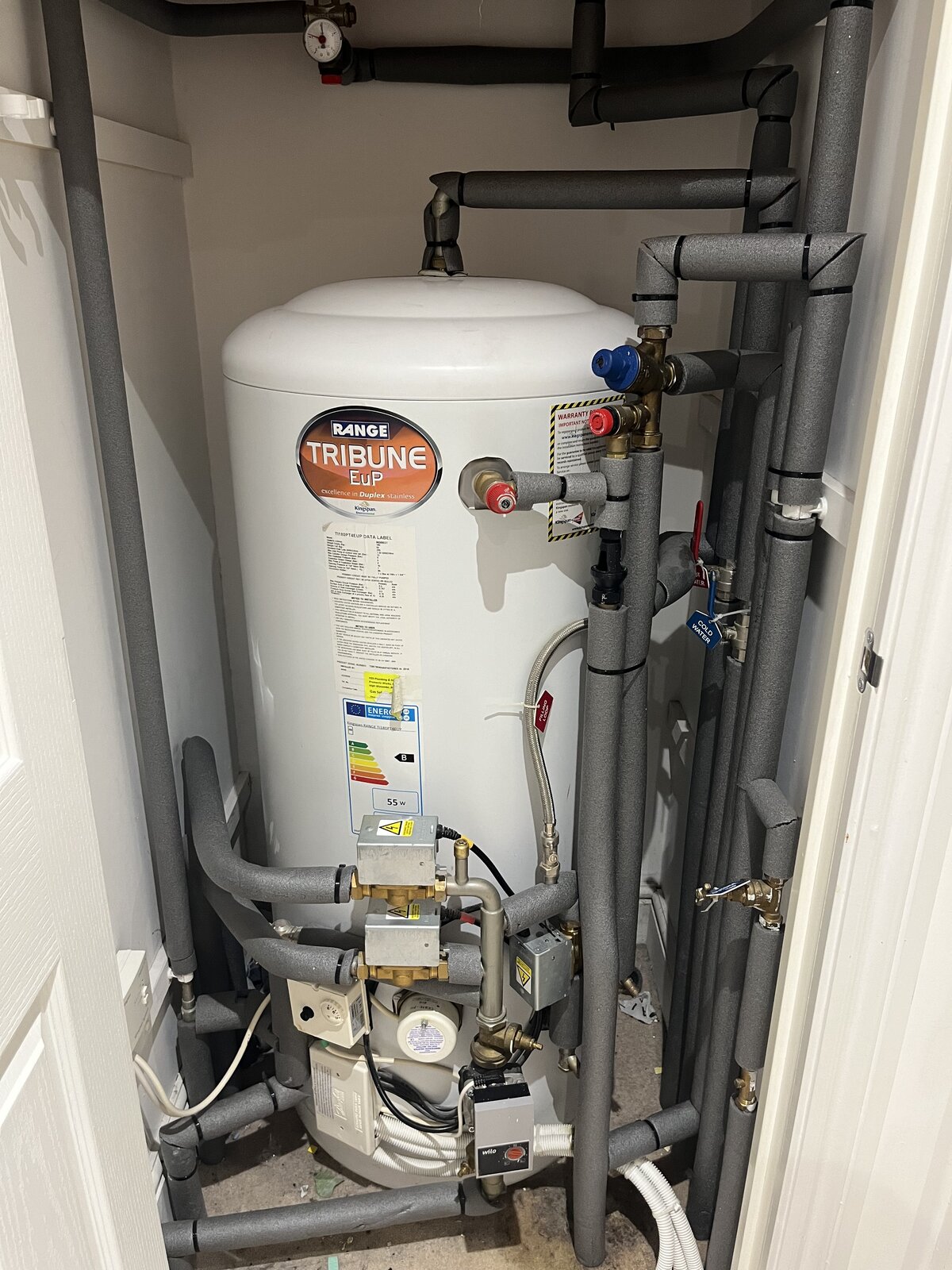

I would have thought the scr is for heating only? Sounds like you have a y-plan system and a failure in the motorised valve. Can you post a photo of the cylinder cupboard and all controls? Or is it an ideal combi boiler?
Here’s the setup, happy to take any close ups if needed!

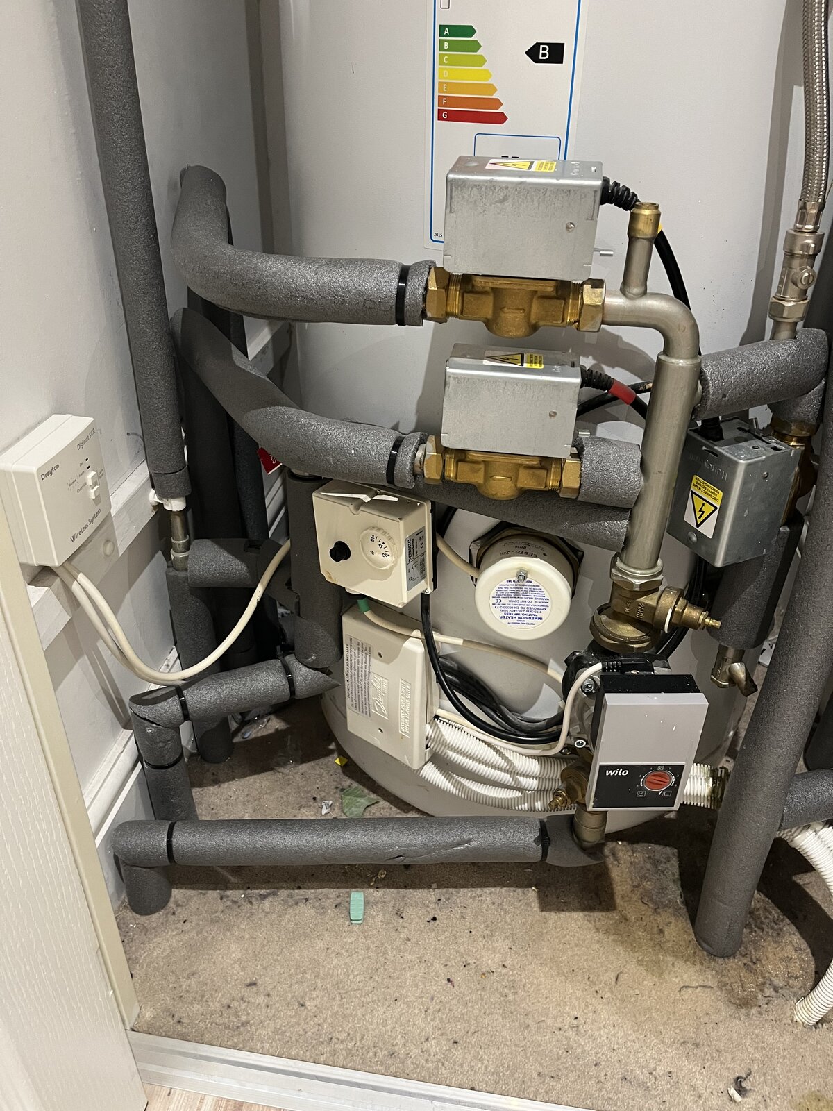

Ok, those changes things slightly. You have an unvented cylinder, which will need a G3 registered engineer to work on it. It doesn’t sound like anything other than the valve, as you have hot water when heating is on. Not a y-plan, but S-plan plus. It’s failed to spring back fully, which is why you have hot water when heating is on.
Thanks so much. Guessing you mean diverter valve? So if I find a G3 reg engineer and suggest I need a diverter valve replacing, I’ll be pretty close?
Really appreciate your help.
Not really a diverter valve. It’s correct name is a spring return 2 port motorised valve. Yes, you can suggest a new Honeywell 2 port actuator (this is the name for the head part (metal box) that can be replaced) or the synchron motor if applicable.
Is G3 needed to fix a motorised valve? Just asking
Tbf I’m not 100% sure, I would like to think so and have given advice based on this. Should anything go wrong with it would you like to be responsible? I have just completed my unvented training yesterday and they only mentioned 2 safety devices, but G3 of the building regulations mentions motorised valves as an energy cut out.
