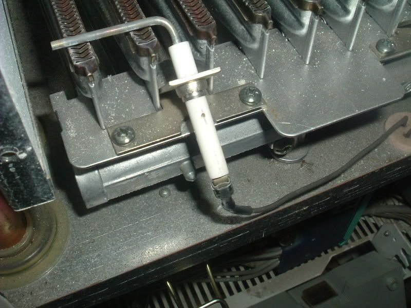

I have a Jaguar C/H combi boiler and recently the hot water side has been playing up.
If the heating is on the water will get hot if the heating is off the water won't heat up when a tap is turned on. I have removed the covers and found that one of the thermocouples has what appears to be an electrical arc burn on the ceramic casing, could this be the problem and if so would replacing it solve the problem?
Thanks in advance, I have posted a picture to help.
A galvanised cover plate goes over this and actually touches the ceramic just where the burn is.
Conny the item you call a thermocouple is in fact a spark electrode. If boiler functions for heating, I would say the spark electrode is in perfect condition. If it were faulty, you would get no heating or hot water.
Fault would seem to be in 'hot water detection' area. Running of hot tap is 'seen' by the boiler. Boiler then self starts to heat water.
Running boiler in CH mode means boiler is already running when hot tap is run, so you get hot water.
Suggest you put the cover back on the boiler- not safe to remove it and run the boiler

To the right of that electrode there are 2 similar probes, I suppose these must be the thermocouples but both appear ok and are in the flame when the heating is on.
It was only removed for 'inspection' purposes. Looks like I will have to get an engineer out unless you have any suggestions of where I should look.
