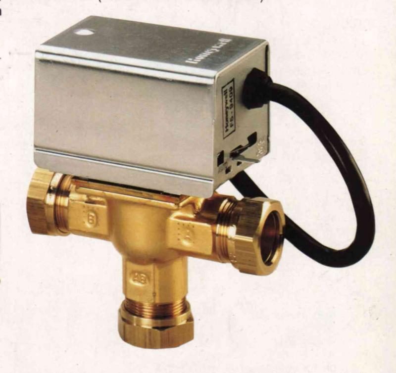

depending on your system the most likley cause will be a zone valve
they should look something like this see if you can find them in your airing cupboard

if it is fully pumped and has zone valves they would normally be the cause and would normally be located in the airing cupboard but often on backboilers you will find the pump and valves are hidden behind removable panel on the side of the chimney

the valves look like the picture i posted although they could have blue or white plastic heads rather than silver metal ones

if the boiler does not light at all and it is on a fully pumped system it is likely that the hot water motorised valve has failed you would need find and replace this valve
