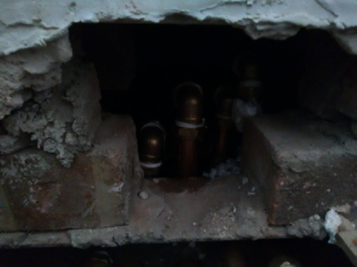

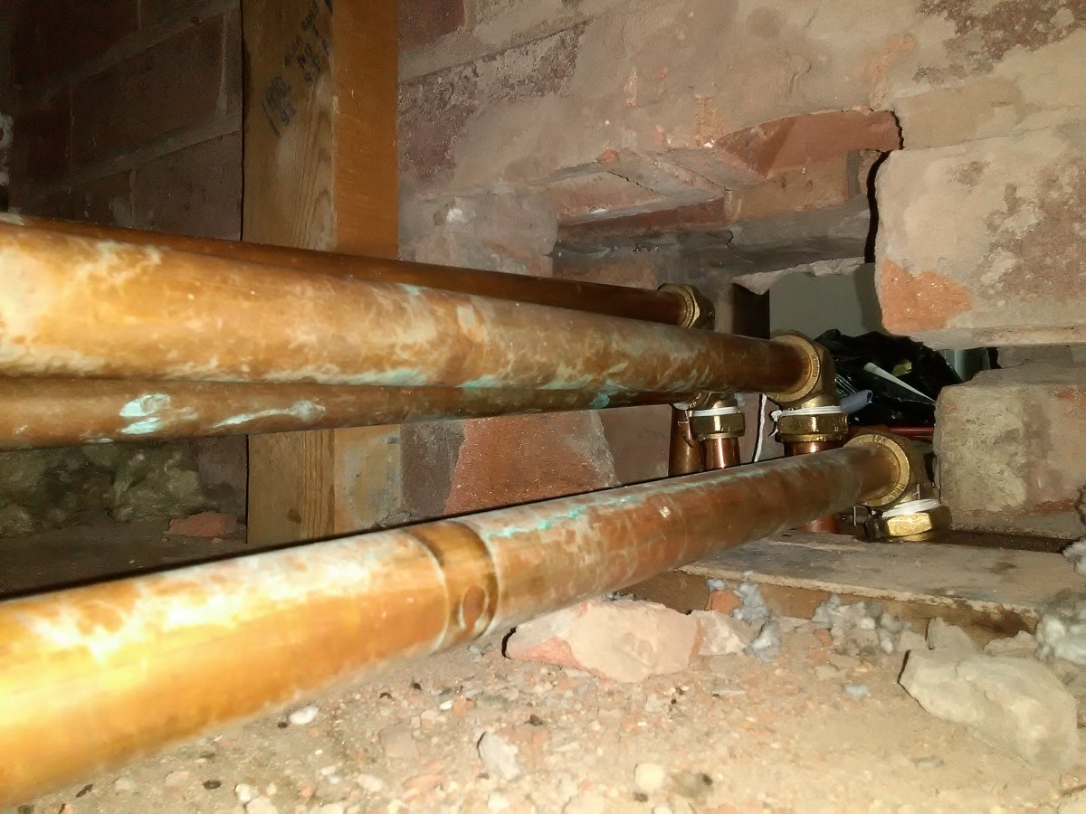

My alterations may have affected things then. To avoid running the pipes along the wall, I've dropped them under the floor into notches (already there). The pipes run from a void above a kitchen extension into the bathroom and I had to drop them 4" to go through 2 steel RSJs rather than the brick walls above.

Photos as promised from both sides of the wall. The original pipework went straight through the wall above the RSJs and then followed the bathroom walls. I've dropped them to go through the RSJs and under the floor.
The cylinder has a basic setup with a vent leading to the F&E tank and the F&E tank feeding the other pipe.
