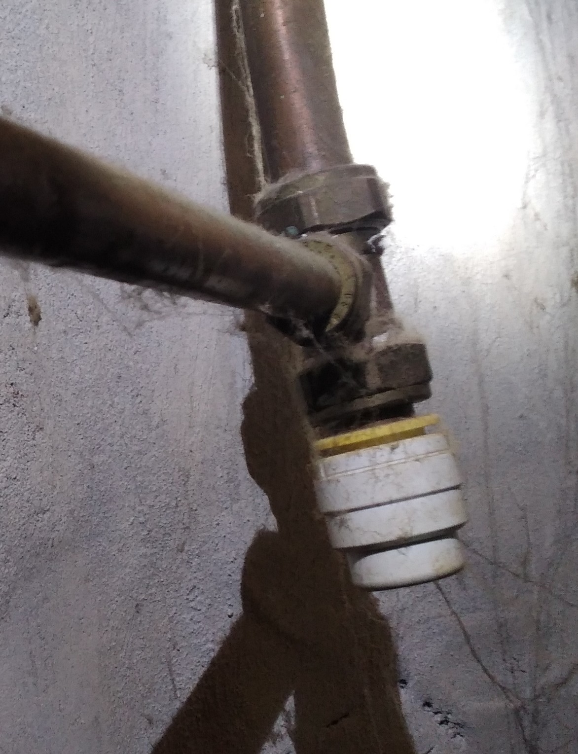

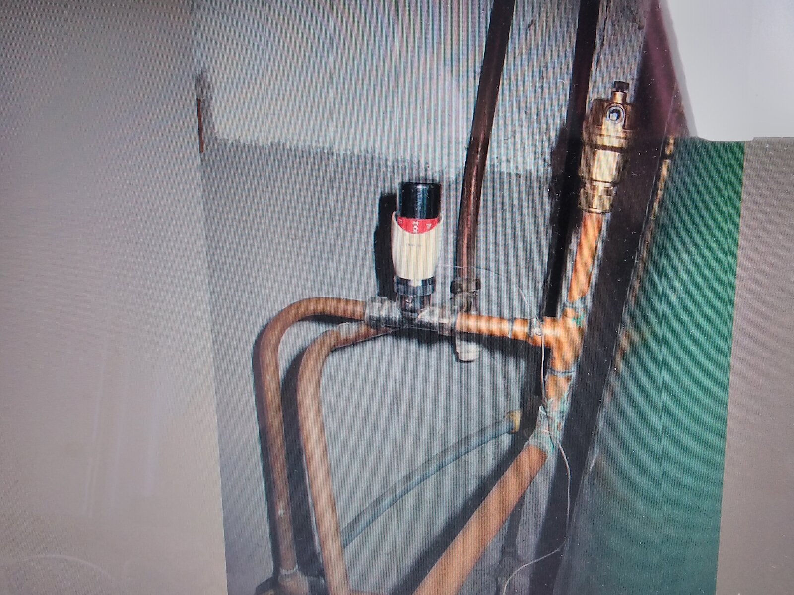

The first photo above, shows a "tapstat" thats the "red" one with the capillary wire which should be attached to the cylinder, note the setting on the tapstat (required cylinder temperature) and then increase it to the hottest setting, it may make some difference but doubtful as the water is hot up to the cylinder coil inlet?, you could slacken the compression nut at the coil say a 1/2 turn and pull back on the pipe until water/air comes out, if only hot water then looks like coil or return line blocked.
Thanks,which end? The hot feed or return? Assume you're thinking air lock?
Yes, the hot end first, then, if accessible, the return. There's also a air vent near that tapstat, can you vent that by removing the black cap or whatever.
Thank you, I can make water leaks just by looking at the pipes,bit of a coward I know. Might try it if I get some bravery!

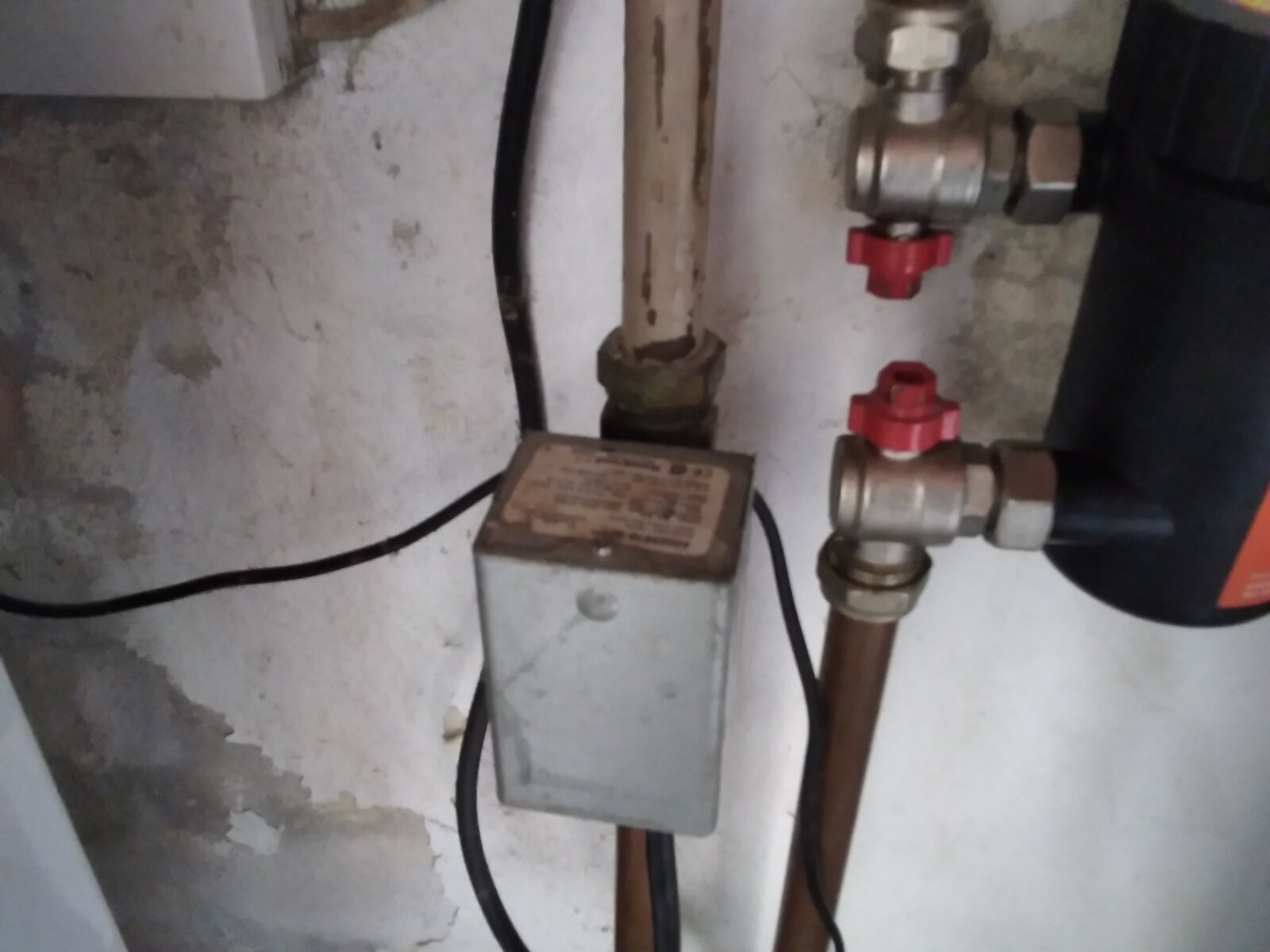

I have just removed the cover of the motorised valve to see if the motor works, it definitely is not. When the valve is held open manually, or to be accurate, (it doesn't seem to matter) the micro switch is making a connection as the boiler will fire up.
I think that a new motor/head will be needed whatever else happens.
The central heating works fine but no flow through the coil with the valve in it's present state , and the coil return pipe remains cold.

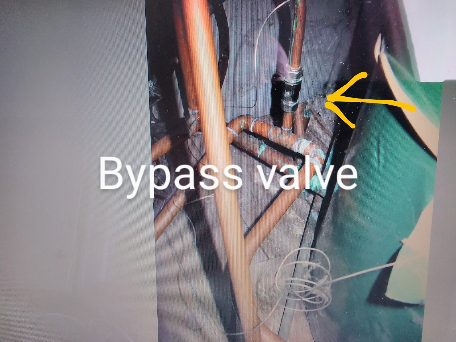

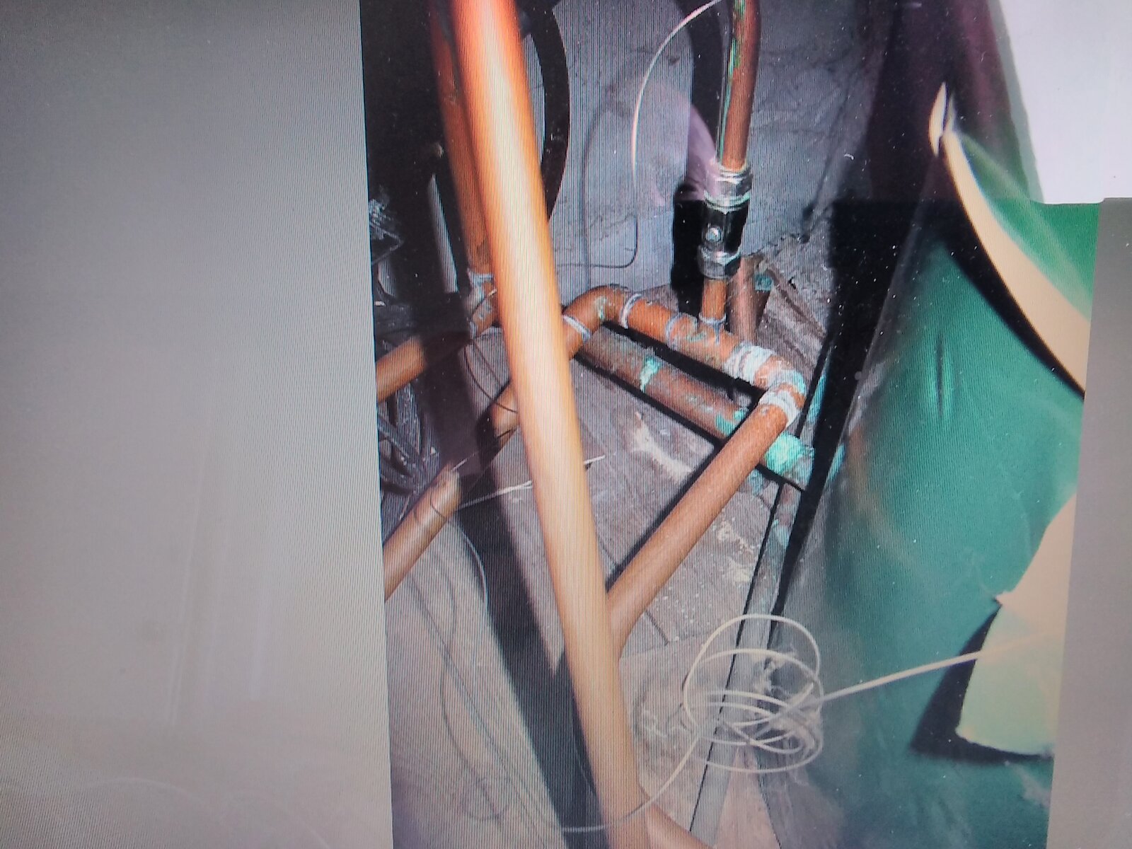

There is a bypass valve on the coil inlet pipe which when opened allows hot water to return to the boiler, so it would seem the pipework is clear other than the coil.

Thought this might help !

There certainly could be a problem with the motorized valve actuator, but if the CH/rsds are getting hot water then there should be hot water available to the HW cylinder coil, controlled by the tapstat.
If the motorized valve end switch is permanently made (fault) then the boiler shoulf fire at least intermittently and constantly.

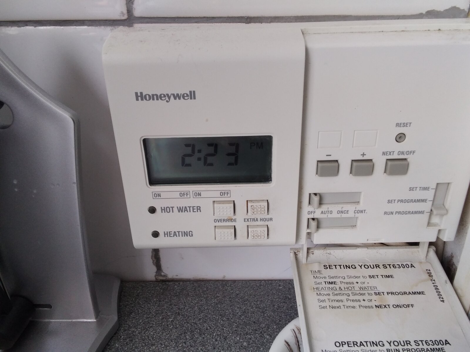

What tells the motorized valve to open? is there a programmer or timer that says CH ON/OFF or something like that, what controls the room temperature?, is there a roomstat (thermostat) somewhere like the hallway. There seems to be another white temperature controller to the right of the tapstat and upside down, can you get a close up photo of that.
There is a controller/programmer that we switch the HW and CH on with. The usual way we control the water temperature is by the boiler thermostat. We have to have both HW and CH on for the CH to work. I think once the hot water has reached the inlet of the tank coil(and can't go further) the boiler does switch off,resuming when the temperature drops again. Thanks again for your time
