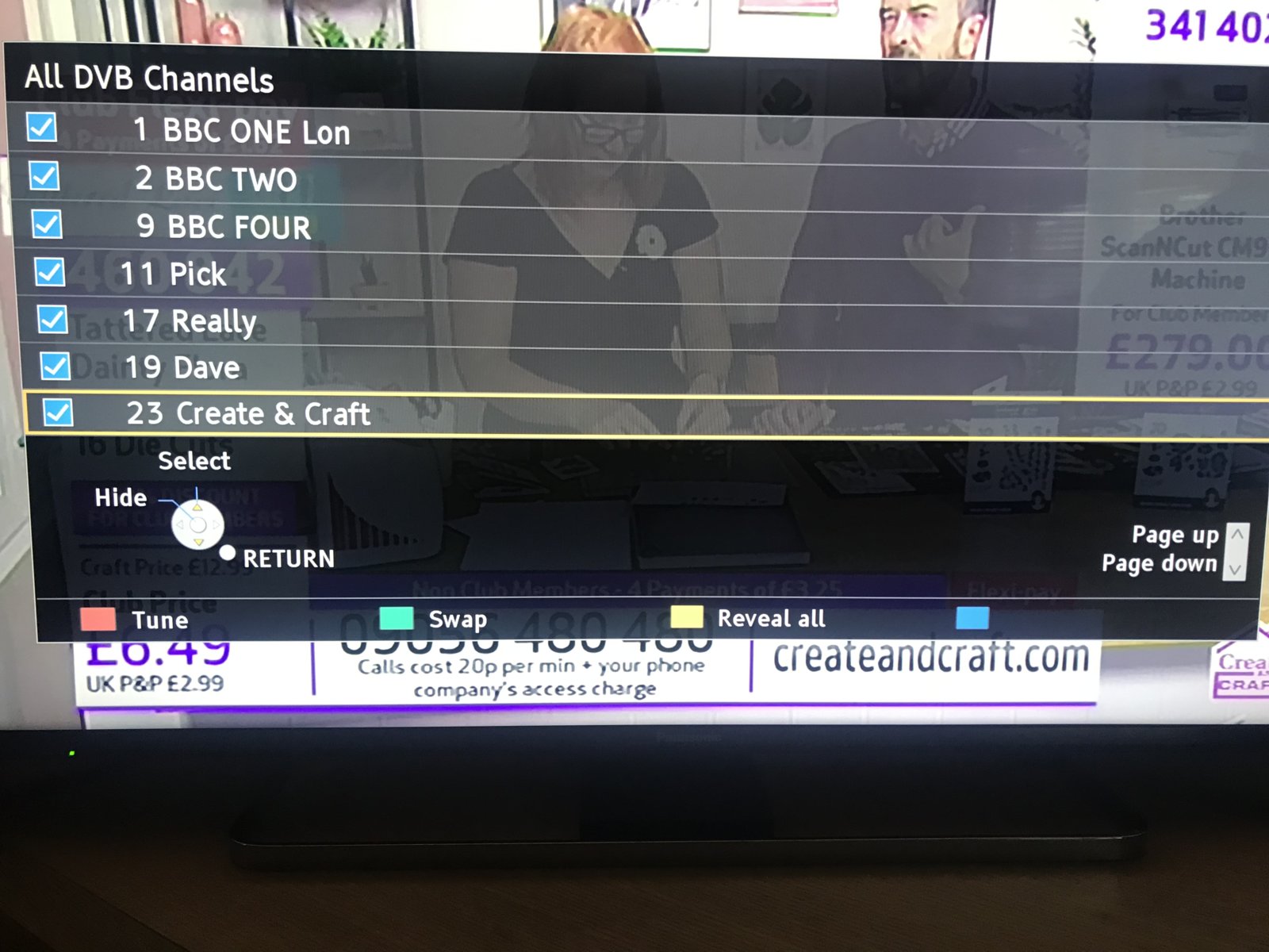

Just recently over the last couple of weeks, I kept getting a blank screen when watching ITV programmes with a message saying 'channel not found’. It’s a 40” Panasonic smart TV about 5 years old now. Tried retuning it tonight and I lost all ITV channels. Furthermore, the option to automatically search for channels was greyed out for some time in the menu. It’s back now but retuning makes no difference, the ITV channels are still not showing. I have the latest software installed. No problem with another smaller (22”) smart TV in the house and they share the same aerial through a powered splitter. Nothing has changed for 5 years. The picture is good on all other channels, Freeview play and Fire stick via AV works fine. Time for another TV or is there anything else I can try?

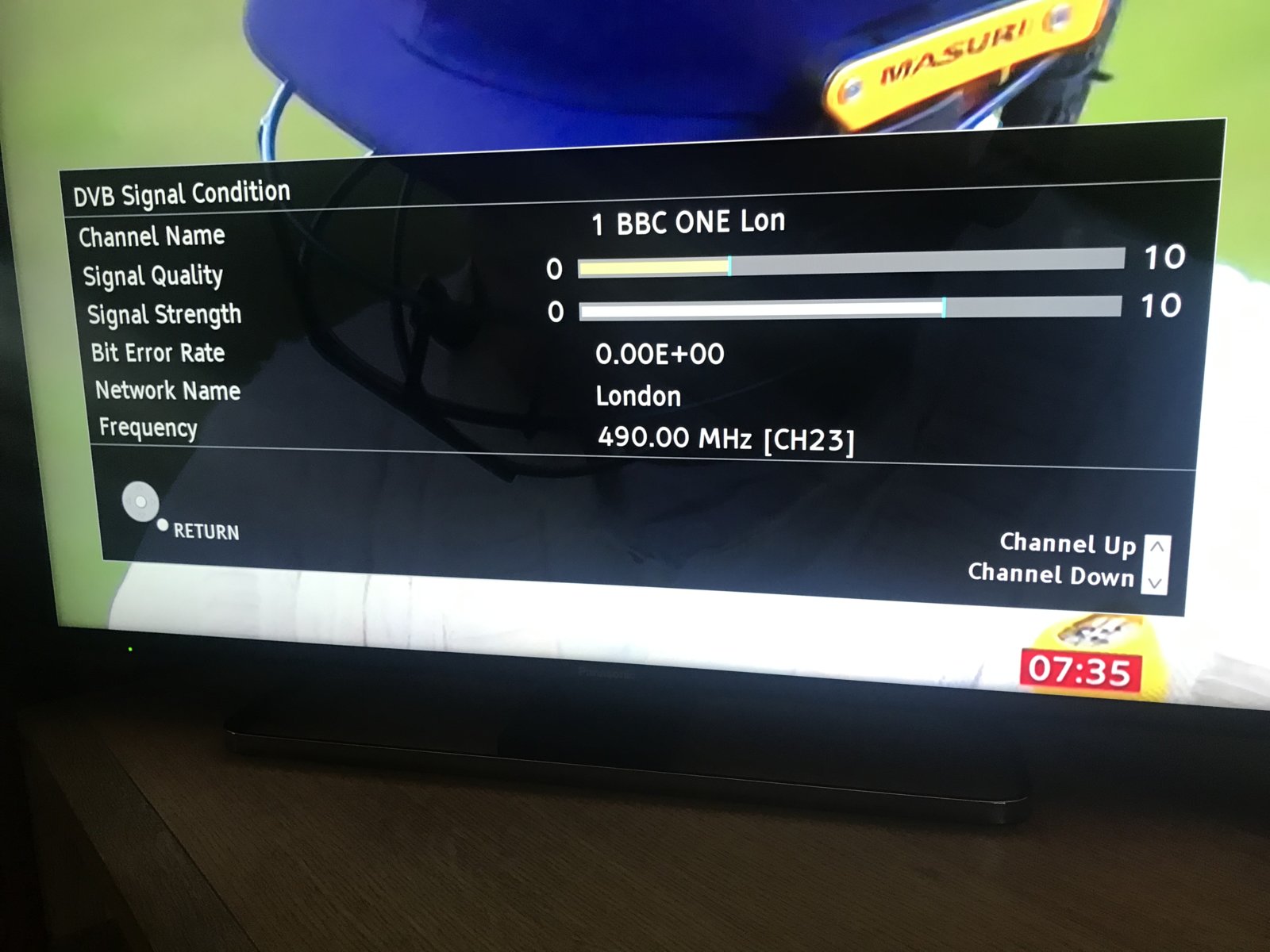

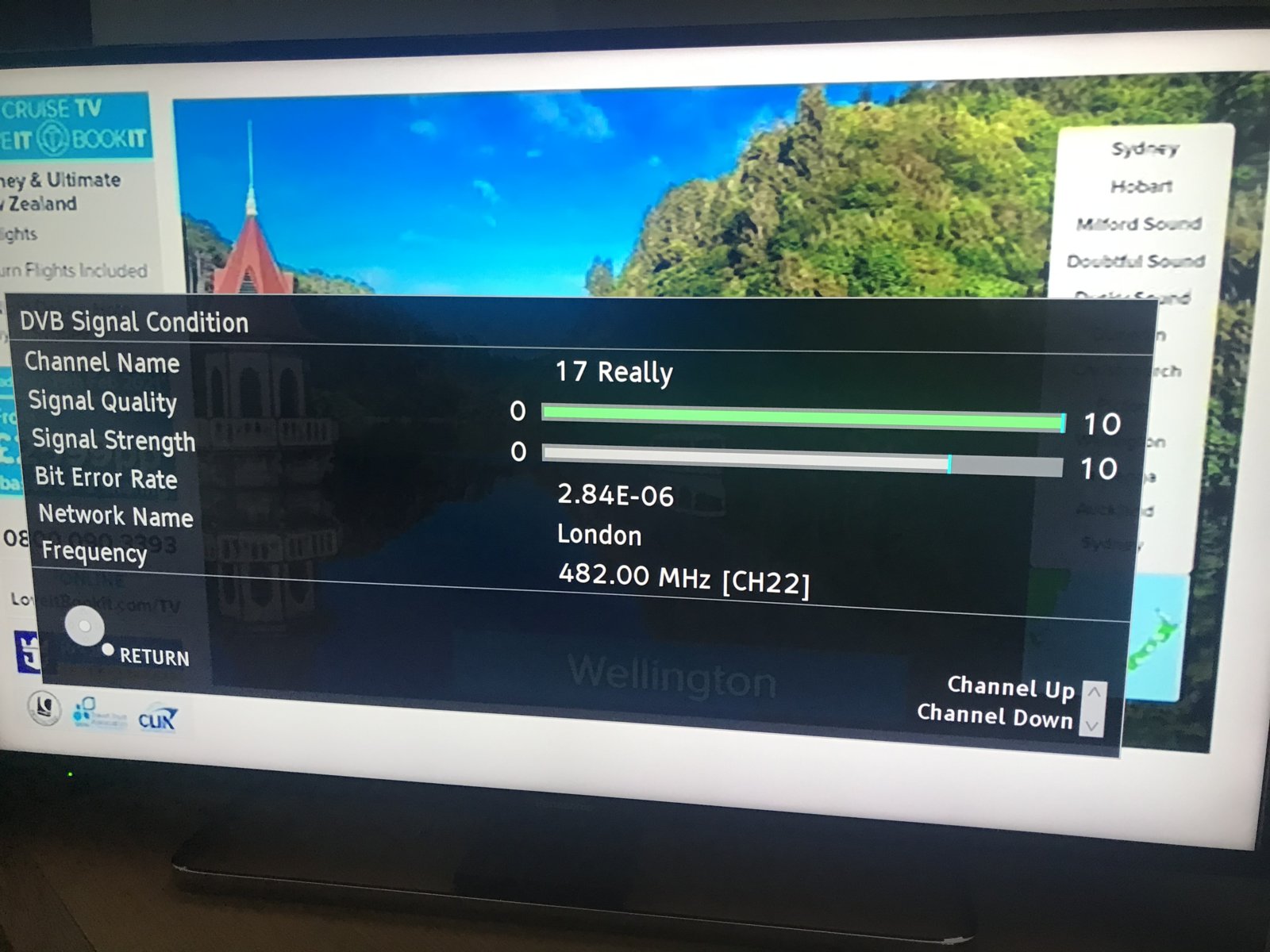

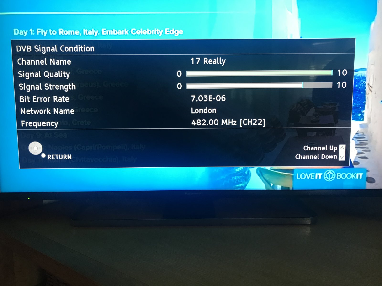

Looks like it’s not just ITV. Seems to be plenty of channels missing. Although picture quality is good, signal strength on BBC channels seems weak compared to the signal strength on what I would call the more obscure channels.
Just had a look at my aerial and it is in the same position as it’s always been. Any idea's?

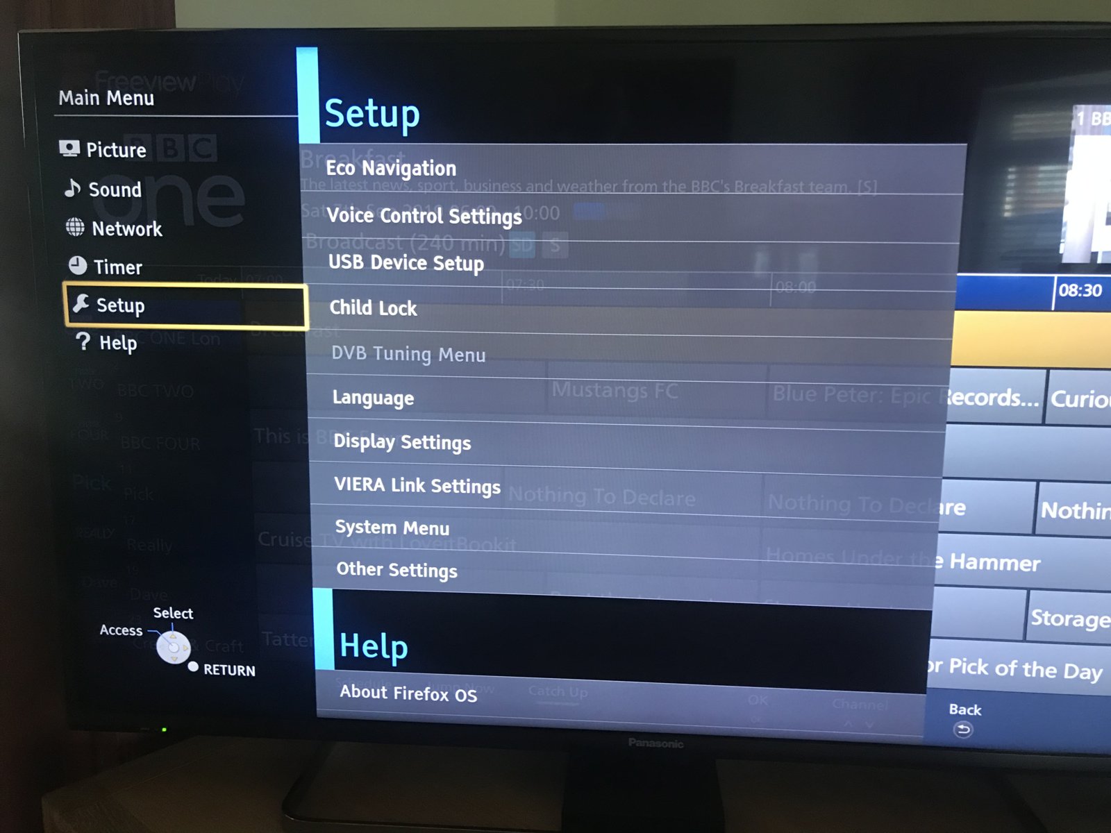

Thanks. Just went to try that and again, the DVB tuning menu is greyed out and nothing happens when I try selecting that menu. Does this indicate an aerial problem or a receiver problem in the TV? Will swapping TV's round confirm anything?
Does your Freeview come through an external recorder? i.e. do you set the TV to one of the AV inputs and then change channel with the remote from say a Humax recorder?
Incidentally, it looks like you might be picking up signals from Crystal Palace. Your ch 22 looks health but ch 23 is on its arse. That would rule out an aerial issue. Could possibly indicate too much signal. As a test, try an attenuator. https://www.toolstation.com/proception-variable-attenuator/p86843
Thanks. No, Freeview comes directly to the TV by aerial and I use the TV remote to change channels. I’ll swap tv's round later - going out in 10 mins - but I’ve just checked the signal strength on the upstairs bedroom telly (also a Panasonic but a 22” one) and that has 100% signal quality and 99-100% signal strength on all channels. Would a smaller TV need less strength signal than a larger one? I was hoping it would be the TV because I’ve seen a 40” 4K Panasonic TV I’d like to get, but the wife will brain me if I buy it, plug it in and get the same results!

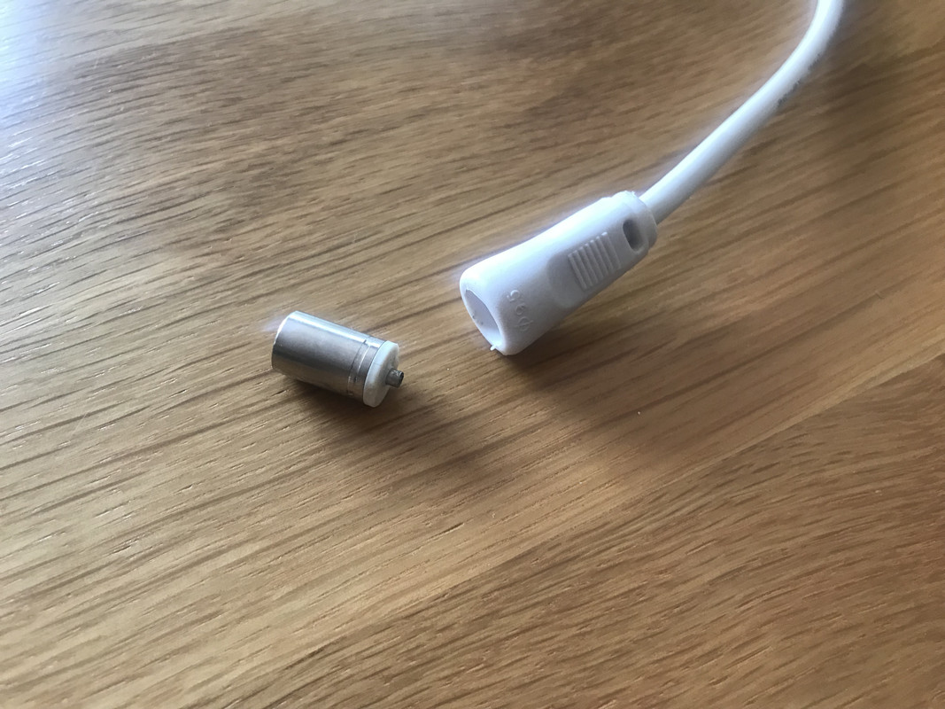

Good news: I unplugged it and I thought I’d try it in the wall socket in the kitchen first. As I pulled the cable out of the wall socket in the lounge, it fell apart!
Just been and bought a new cable, £3. Job done. All channels working. Checked signal strength and all are now up to 99/100%

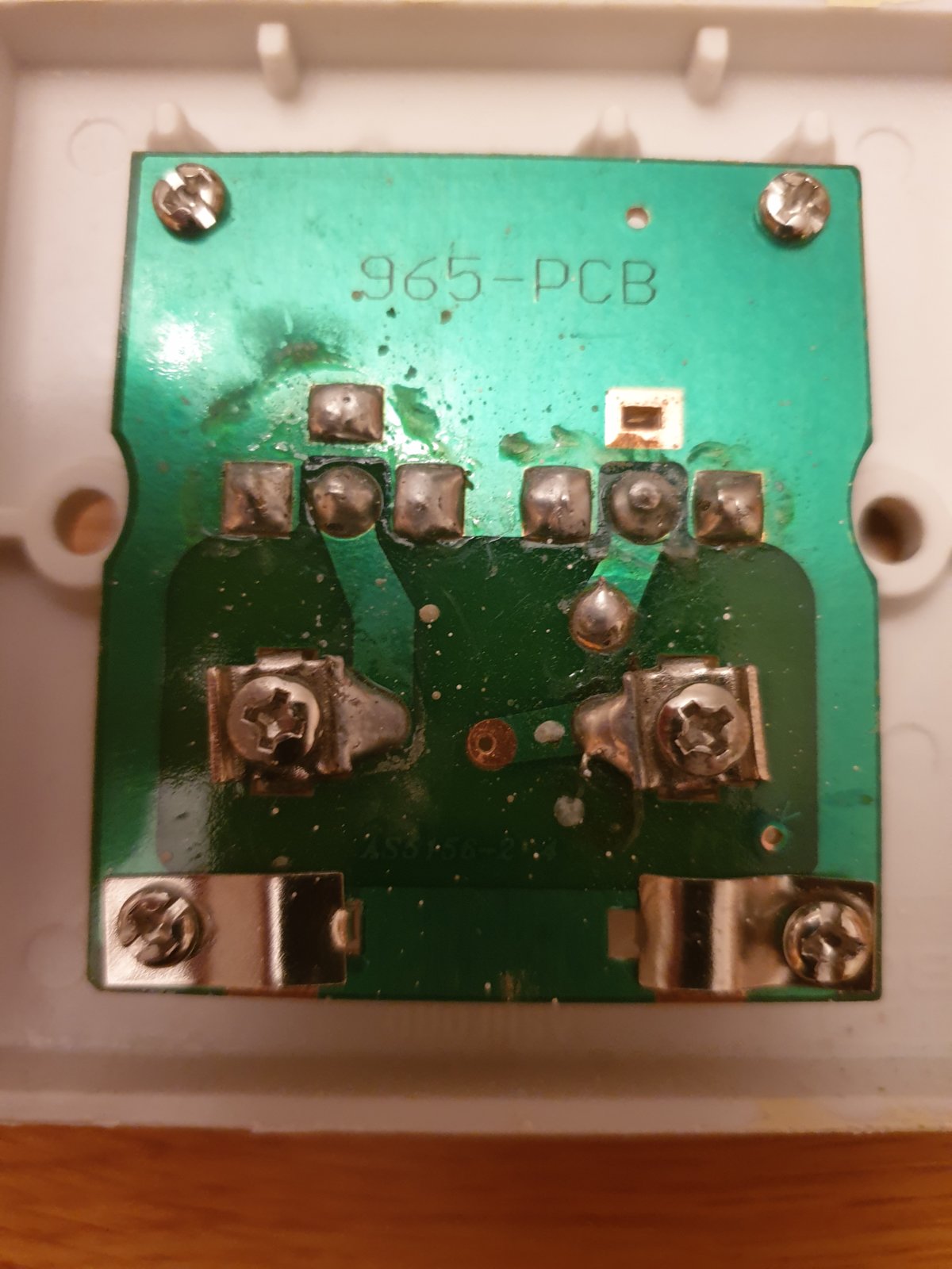

...And now its just packed up again - this time, no BBC channels! Plugged it in the kitchen aerial socket and it was all fine. Swapped the sockets over and back up and running again now....but for how long? The original one in the lounge was a double one - tv and sky. Sky has long gone. Perhaps it was the circuit on the board that was playing up - the one I swapped it with was much simpler. Is that a blob of solder missing on the top right hand side - that was the aerial side. Only time will tell.
What you have there is an unshielded aerial wall plate. By the sounds of it too, there's possibly a fault with it.
Shielding is important for TV signals, but especially so for digital TV signals. Have a read of this page to find out why, then get hold of a shielded wall plate to replace that dodgy one and see how you go.
