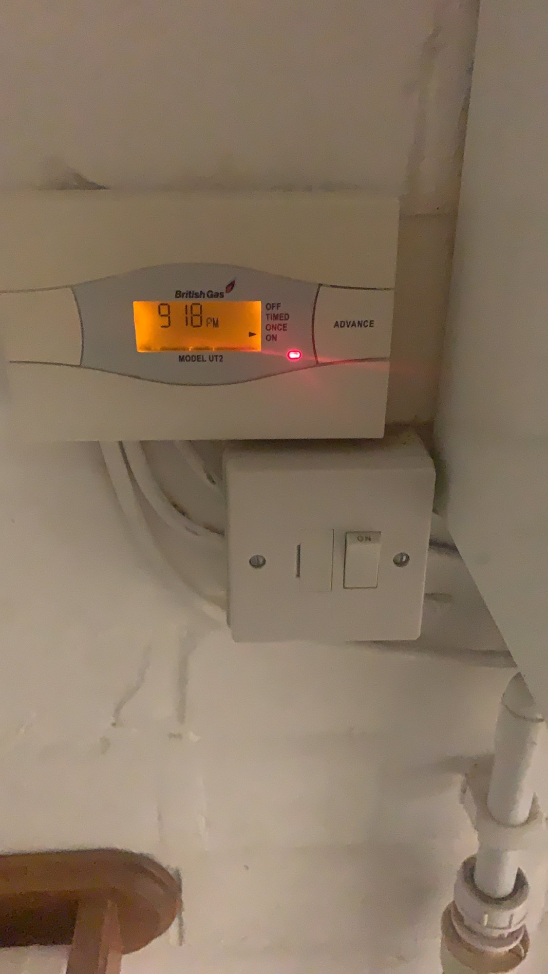

hi, I have no power to my proteon boiler at present. It’s wires into a fused spur 3amp, I changed this and the red light comes on but still no lights or power to boiler. I’ve checked the RCD unit and all switches are up.....

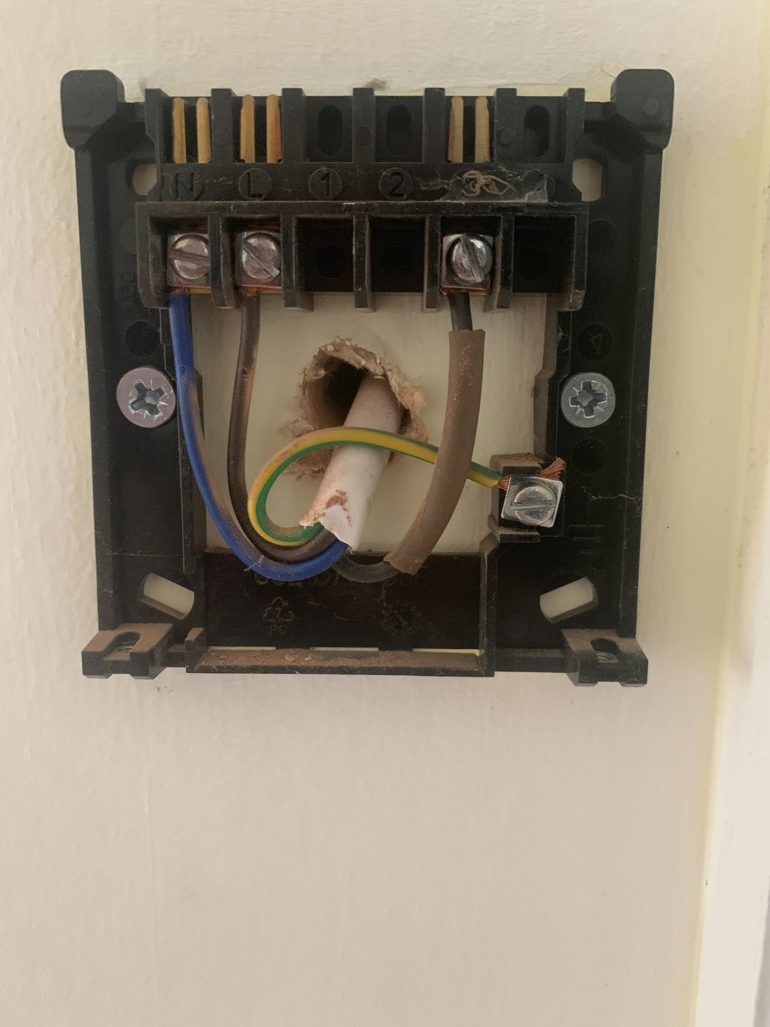

This came about when I looked at the wall mounted thermostat (British Gas rs1) we have had a Nest smart thermostat delivered, I turned off electrics to see the wiring on the old thermostat but it appeared I needed someone with more of a sparky background to wire this up for me. I put the old thermostat back on with all live, earthed, neutral etc back to its original (I took a photo before removing) but I’m now left with no power to boiler?

sounds like when you have re-connected the wires you have pushed a wire in too far and screwed on to the sheathing rather than the wire

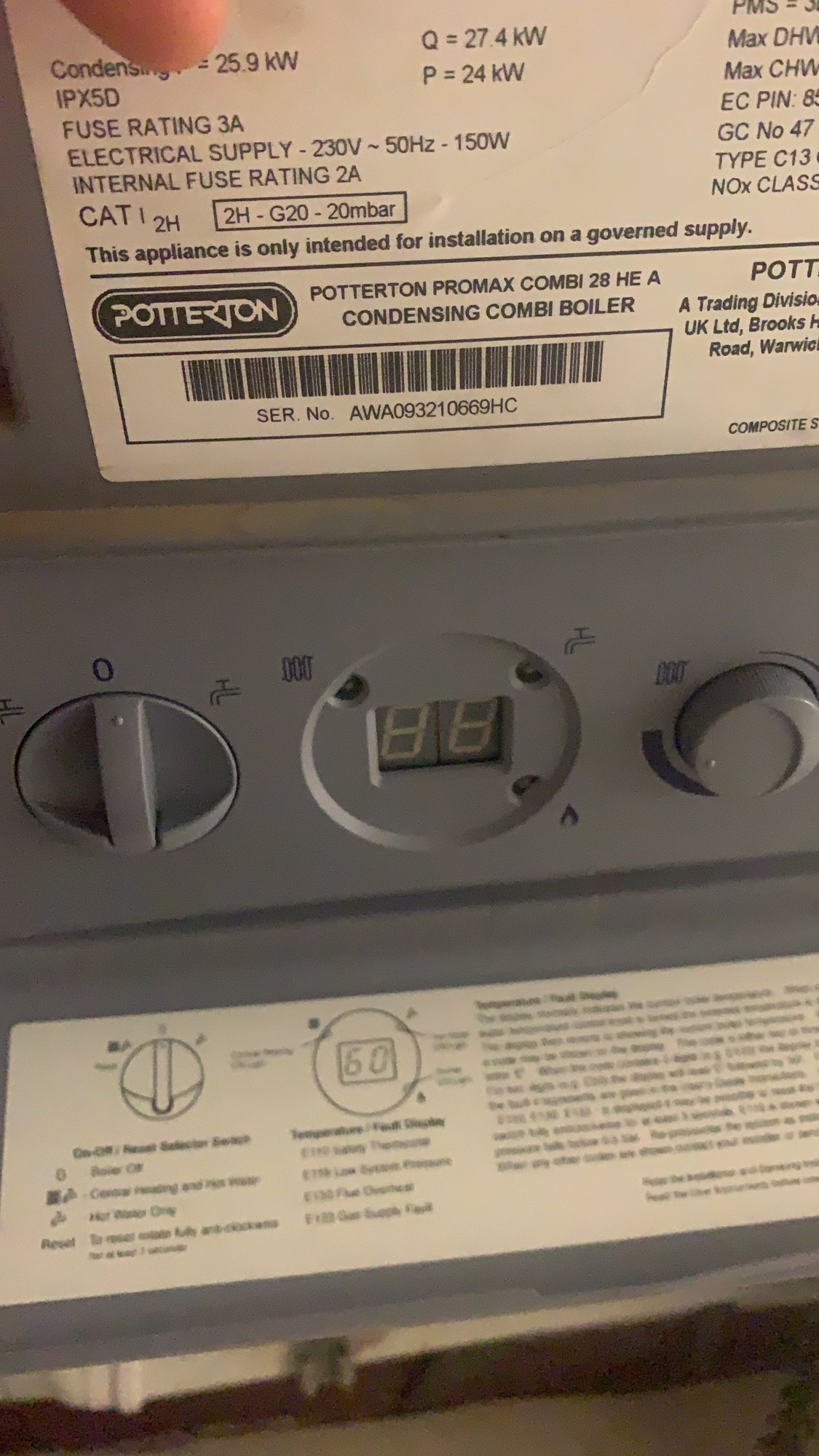

on your bottom pic the function selector is set to O your boiler will not give a display in this position

Lol....it’s got no power when it was set on other settings. All ok I changed the fuse within the boiler located by the PCB all working now. Thanks
