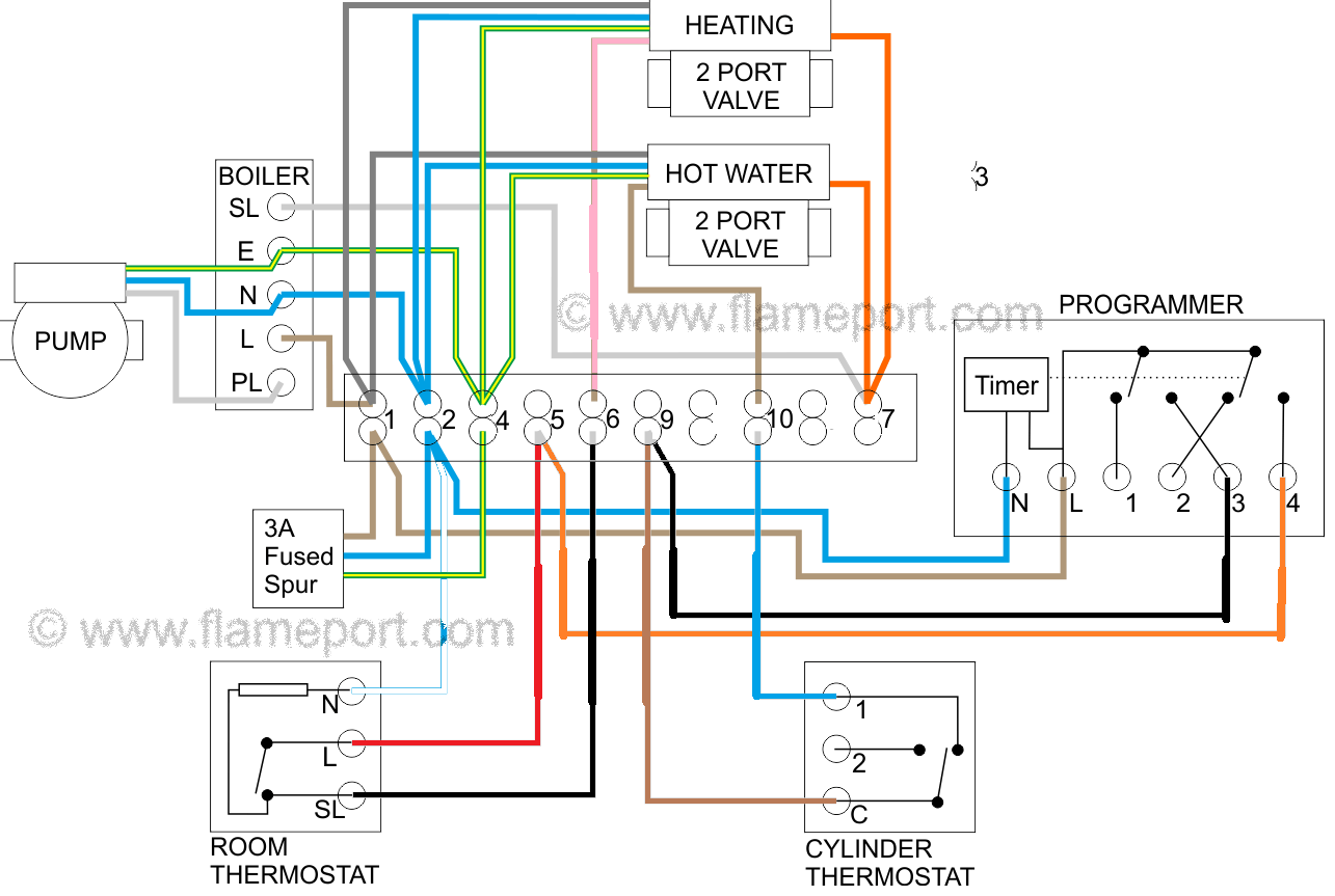

I’ve been looking at s plan wiring diagrams and not convinced that it’s wired correctly and there looks to be a mystery wire in a5 and a6 without an earth.

I can’t figure out where the red and black in A5 A6 are from and there’s no neutral.
What valve type have you put in, Personally I don't recognise the wiring colours for a 2 port valve but it's not often I work on heating systems this small so I'm not that ofait with domestic kit.
My gut feeling is it looks correctly wired to this diagram of a 'programmer' system[my thanks for Flameports drawing which I hope he doesn't mind me altering]. However I'm suspicious that the new valve wiring may not be correct, or even the wrong actuator.
I assume your hive unit [not kit I've ever come across] is a straight replacement for the programmer and the red/black cable you mentioned is the existing room thermostat.
Revised labels:
It looks to me that the unused black is most likely just a spare conductor in boiler cable.
Looking at your pic that I've just reposted I'm not sure of the colour of the valve wire into terminal 6. Is it brown or pink?
It’s hard to believe but it’s meant to be brown albeit the most pinky brown I’ve seen.

thanks for the revised diagram. It does make more sense now!
