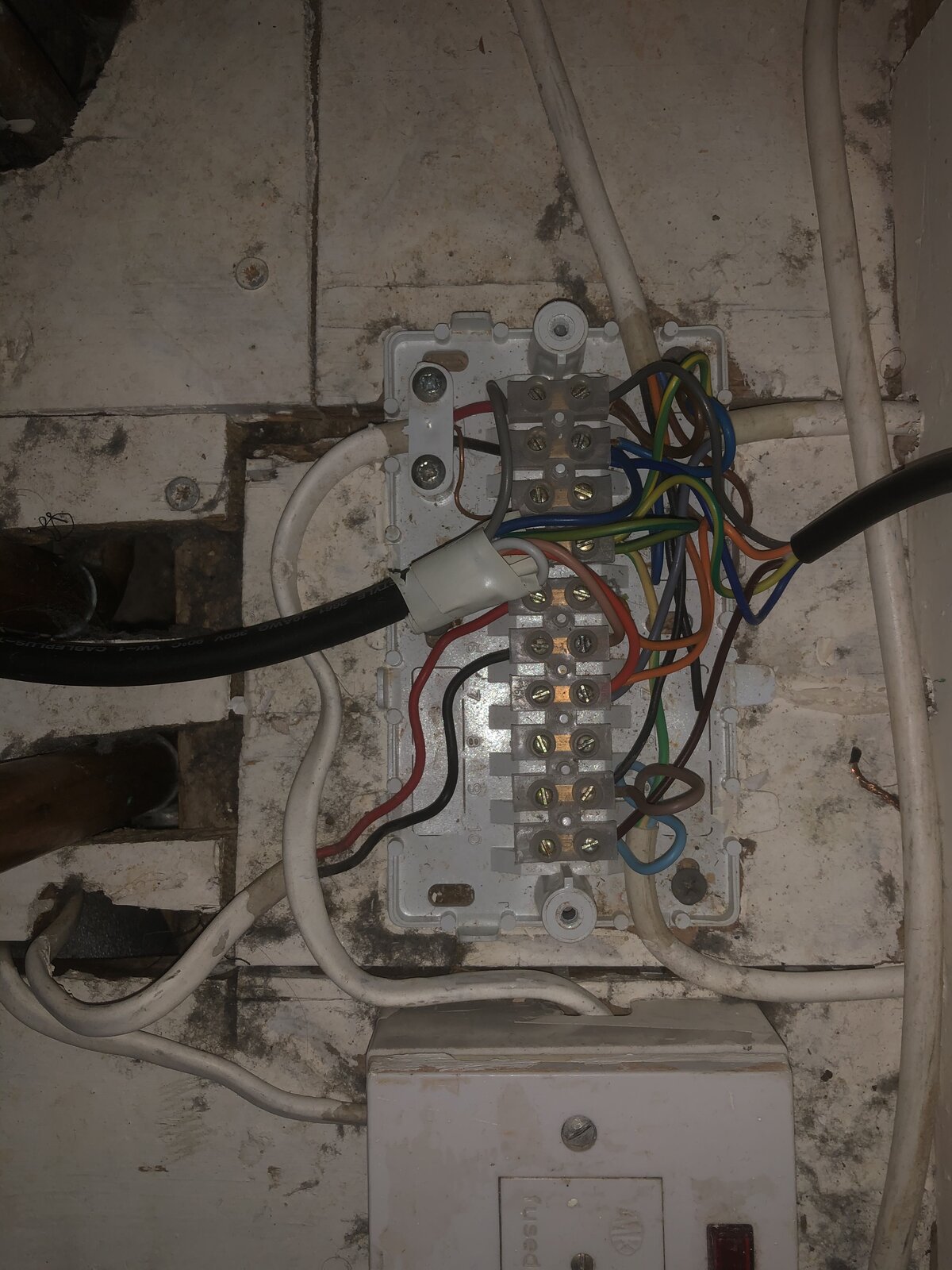

After thinking I had successfully fixed a plumbing problem I seem to have created an electrical one.
I replaced a Honeywell motorised valve earlier today and re-wired it the same way except for an additional white wire which I had to isolate. The original valve only had 5 wires (no white).
The valves are now both working (good news as I have heating) but now my underfloor heating and extractor fan in the bathroom has stopped working (no power).
In the spirit of Sherlock Holmes I would say that it has to be something to do with the wiring but the wires were replaced in the same positions. The picture shows the original wiring. I can take another picture of the new valve wiring but I can’t figure out how/why it would power the room next door.
any advice would be most appreciated.
Where does the dodgy red and black at the bottom left of the picture go to?
a good question! I need to check. Maybe it’s time to bring an electrician in. It’s been fiddled with a few times by various plumbers.
It's hard to see what's what. What's the Blue / Brown cable with White insulation Entering bottom right Feeding a Switch?
Is there a black wire on the right hand side ,not connected to anything ? Just lower than the orange wires and to the right ?
yes! I noticed that. Absolutely no idea.
Tomorrow I’m going to have another look and work out what the hell is going on. It shouldn’t be this complicated.
Again. No idea. The mystery continues!

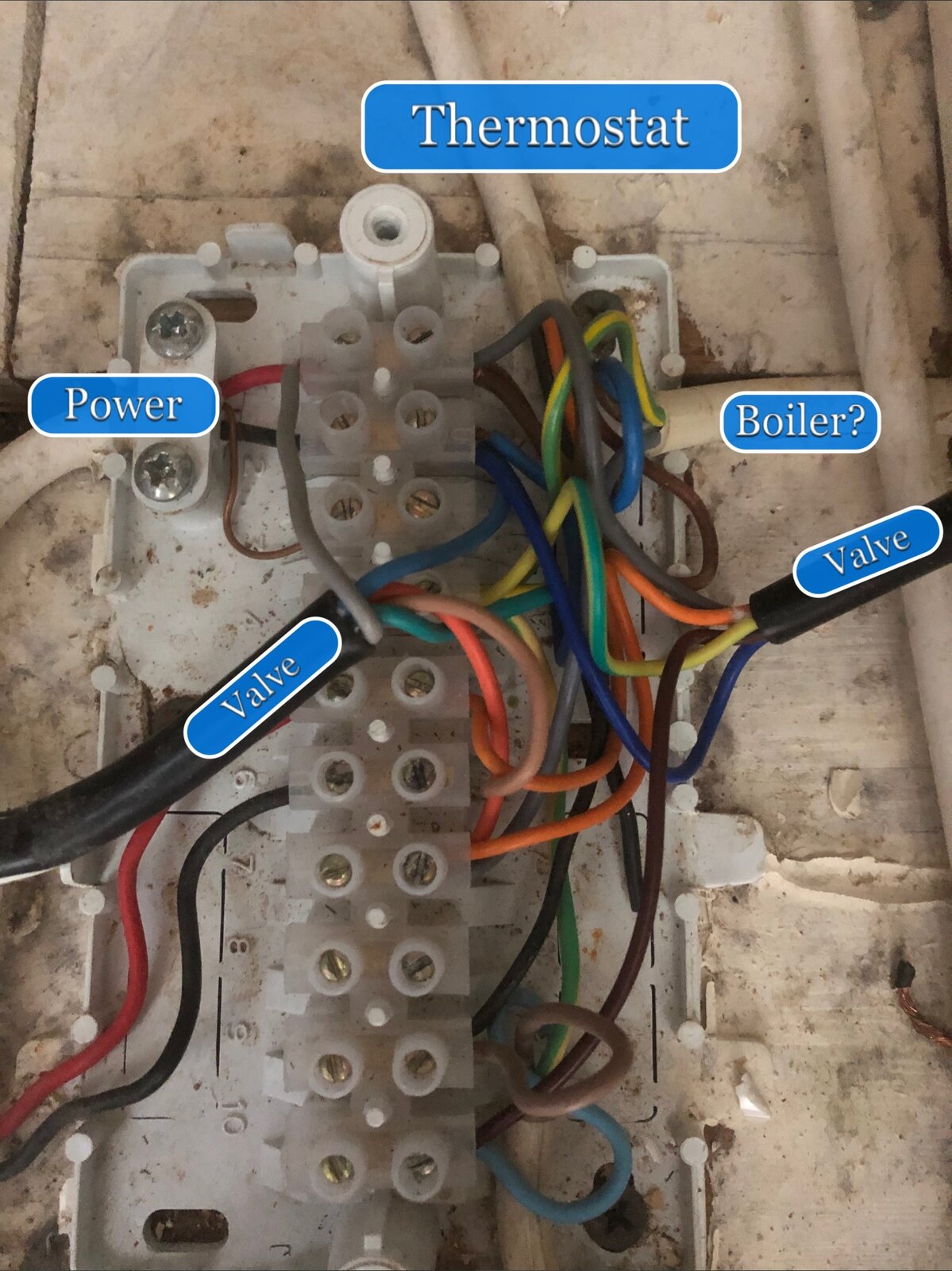

Meanwhile here is the revised picture with the new valve wired in. Definitely something within that wiring has knocked out the extractor fan and underfloor heating though I appreciate they should really be wired into the s plan control box.
the valve is brand new.
I’ve had brand new Honeywell room thermostat set fail out of the box - think they’ve one a bit downhill since becoming resideo controls keeping (mocking imo) the Honeywell name.
Tbf - not sure that the extractor fan in bathroom should be from your wiring center for heating. Checked all switches are on?
