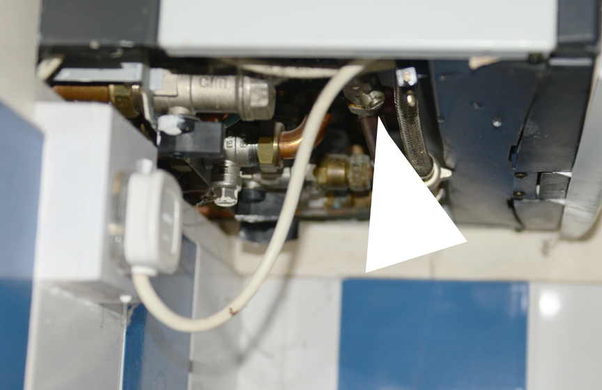

I have a Baxi Combi 80e boiler. There is water but the water is not hot and the pressure gauge is at 0 with the light flashing 'Fault on Pump or Low System Pressure'.
The pump seems to be working as I can hear it but I maybe mistaken.
Any ideas how to resolve this please

This could be a tricky one, try re pressurising to 1bar and see what happens.
Do you have anything resembling this near the boiler?
shopping
Any valves on either/both ends with a slot for a screwdriver?
shopping
You're a diamond! Fixed it! Thanks for your help. Much appreciated (y)
