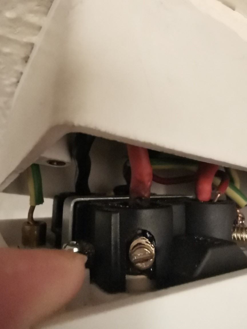

Hi
we have a Triton T70XR and the other day it just stopped working. Having looked on other threads, we tested the resistance of the solenoid coil which was 3.6. So wondering if it is the pull cord, having opened it up as much as i can, one of the cables looks a burnt. Could this be the cause of the shower not working?

I can't tell from your picture, but it's a common problem. You'll probably find the voltage drops under load, and the screw heats up. The wire will be loose in its terminal.
Needs cutting back and re-terminating for sure. To answer your question yes it could stop your shower working. Other common problems with Triton is the filter getting blocked or the Thermal Cut out.
so we cleaned/ cut back what we could and replaced the pull cord switch, it lit up which it wasnt before and the shower made a noise but no water still. going to have a look at the filter next i guess. any other thoughts please let me know
