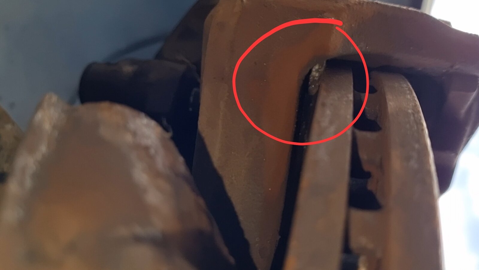

Alec_t Joined 18 Mar 2017 Messages 1,676 Reaction score 390 Location Wales Country 11 Feb 2023 #16 HarryBadger said: Fixed! Click to expand... Good. But what was causing the noise?

freddiemercurystwin Joined 21 Jan 2007 Messages 28,452 Reaction score 5,081 Location Devon Country 11 Feb 2023 #20 Alec_t said: Good. But what was causing the noise? Click to expand... We may never know ....
H HarryBadger Joined 11 Feb 2023 Messages 5 Reaction score 1 Country 11 Feb 2023 #21 Alec_t said: Good. But what was causing the noise? Click to expand... It was this stone rubbing against the brake disc: As spotted by robinbanks. It was caught in the caliper just underneath the brake pad.
