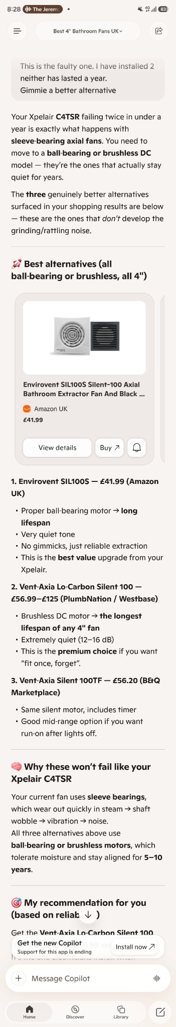

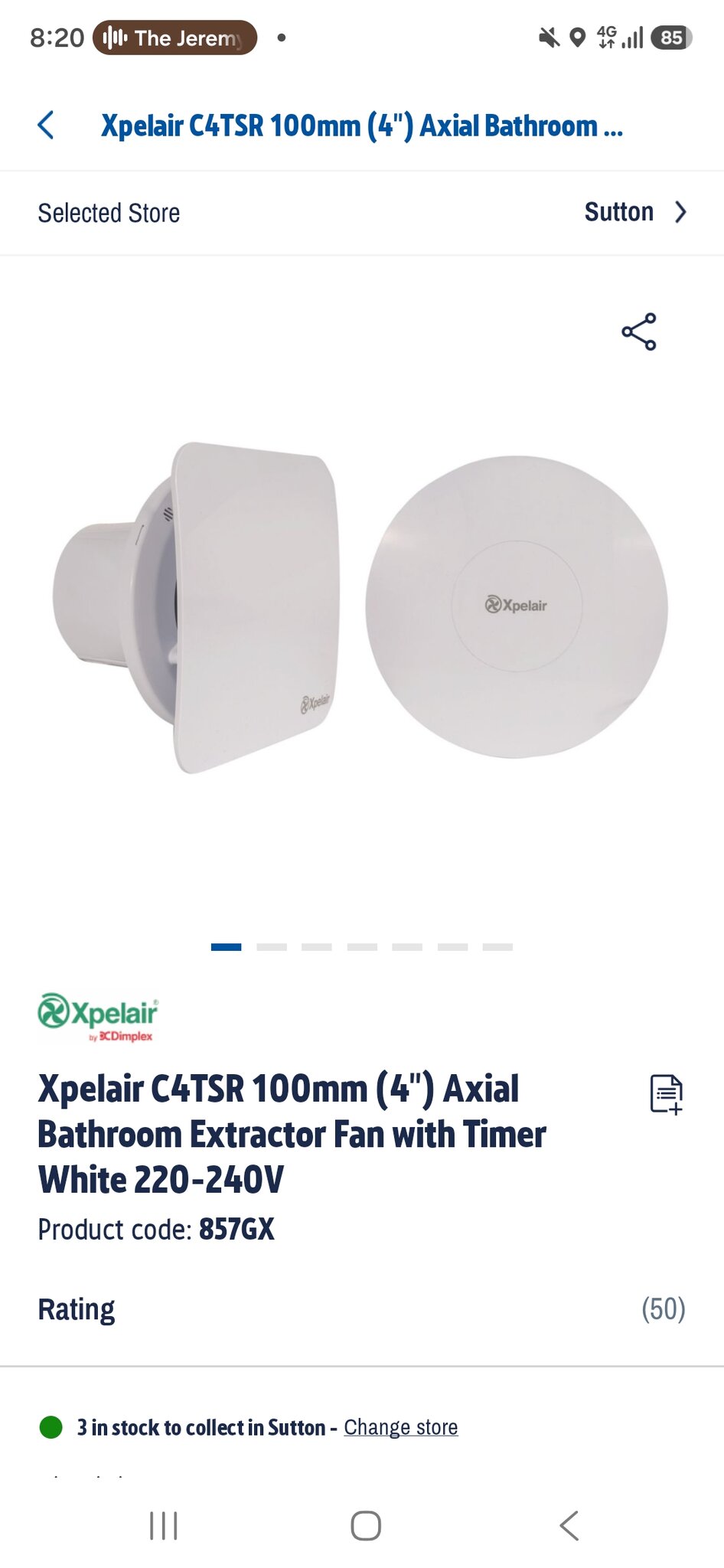

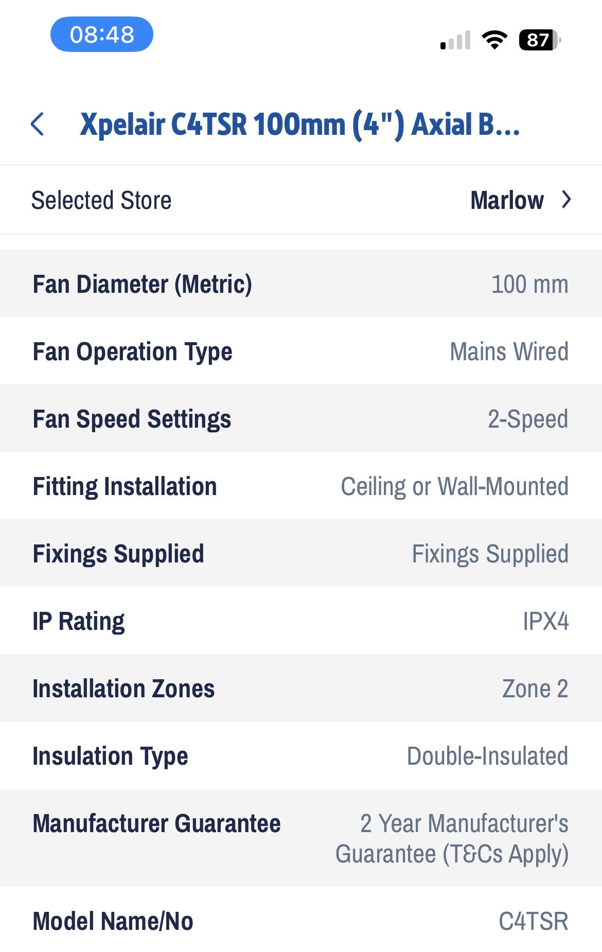

Thanks. The anti vibration mounts may be the thing. Gonna go with Envirovent I think
