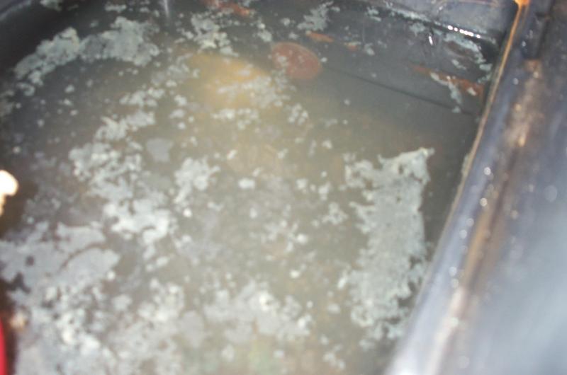

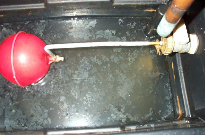

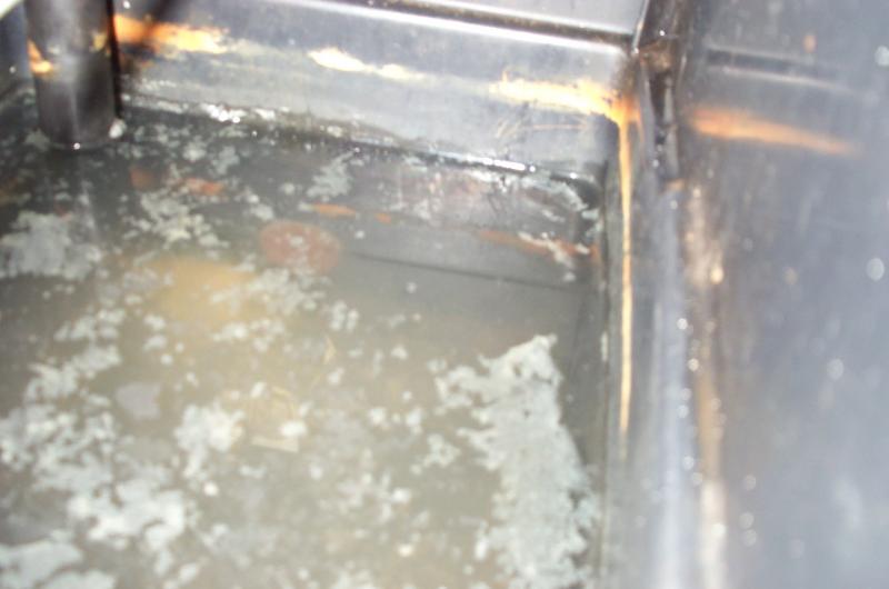

I have since been into the loft to check the expansion tank and was surprised to see a white film on top of the water. Could this be scale from the boiler? Pictures attached
Do I need to clean again to once and for all clear system noises ?[/img]
