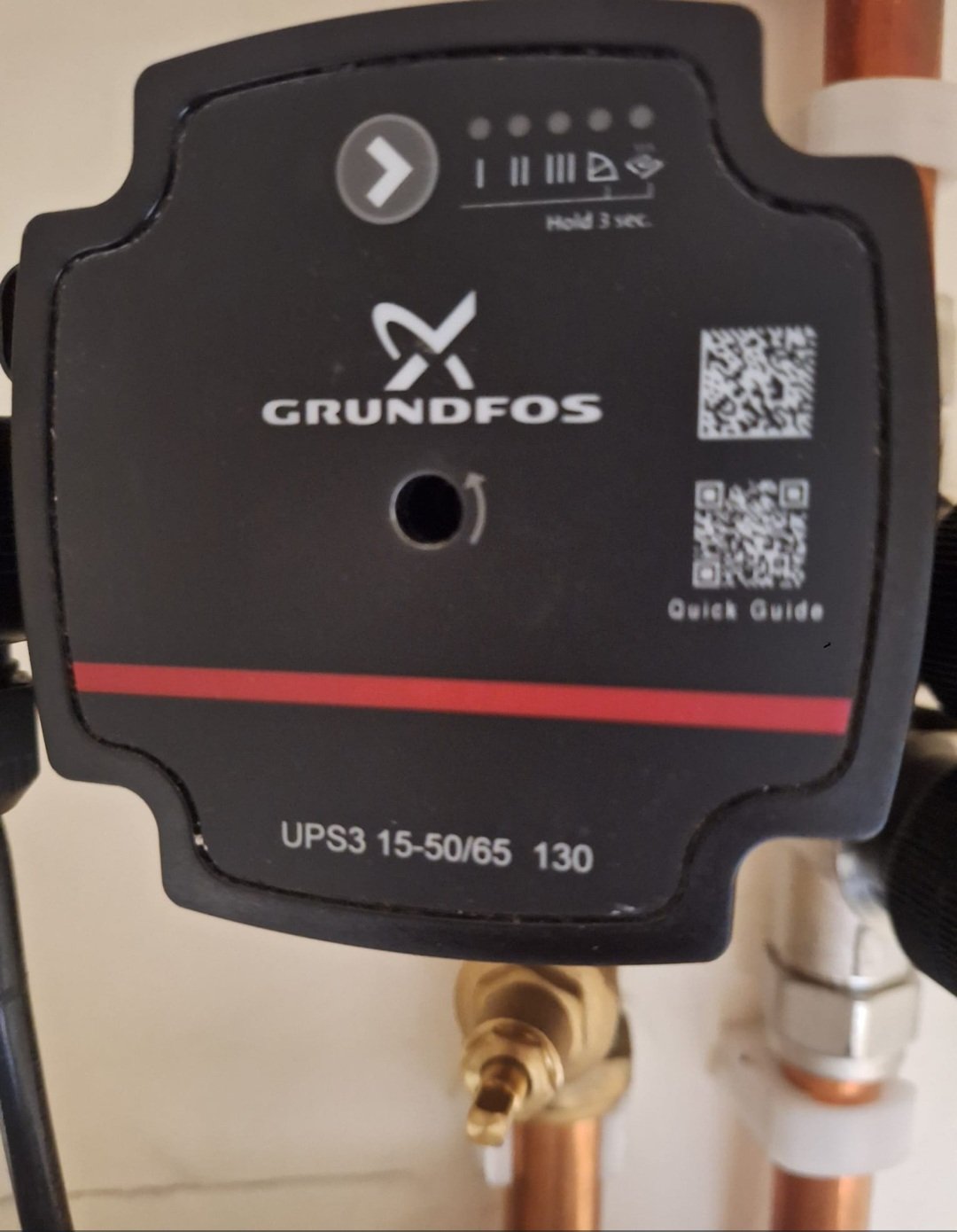

Also, to check if it's possible to change the external Grundfos settings somehow. I believe this pump is an ERP (Energy Reduction Pump), so not possible to manually change its speed but maybe there's some other setting that on the pump that could help? Any ideas?

Can you post a photo of the external? Grundfos Pump while running. showing the LEDs, also show/state its model number.
OK, I see you have a internal pump.

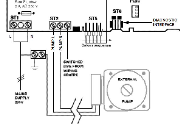

it shows a external pump in the WB MIs but you stated in another thread in reply to my same query (re internal or external) that its a internal pump, can you check this out again.

Hi, Very sorry for the delay in getting back to you. Your help is very much appreciated. Have attached pic of pump now. Do you know what setting it should be set to please?

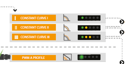

Just start up any zone and lokk at and post a snapshot of the LEDs. IF its running with one solid green followed immediately by two solid yellow LEDs then its running at full speed which can lead to excessive noise, while its running, just press the setting button briefly to change settings, suggest constant curve 1, just one solid green LED and see if that makes any difference.
Many thanks, will do. Much appreciated!
The pump was in fixed speed mode number 3, so I set to fixed speed 1 to see how that goes.
