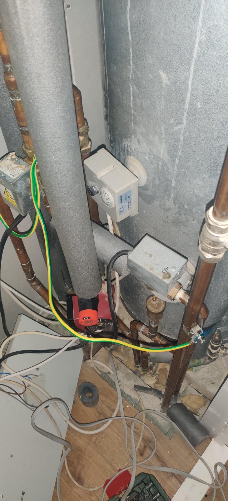

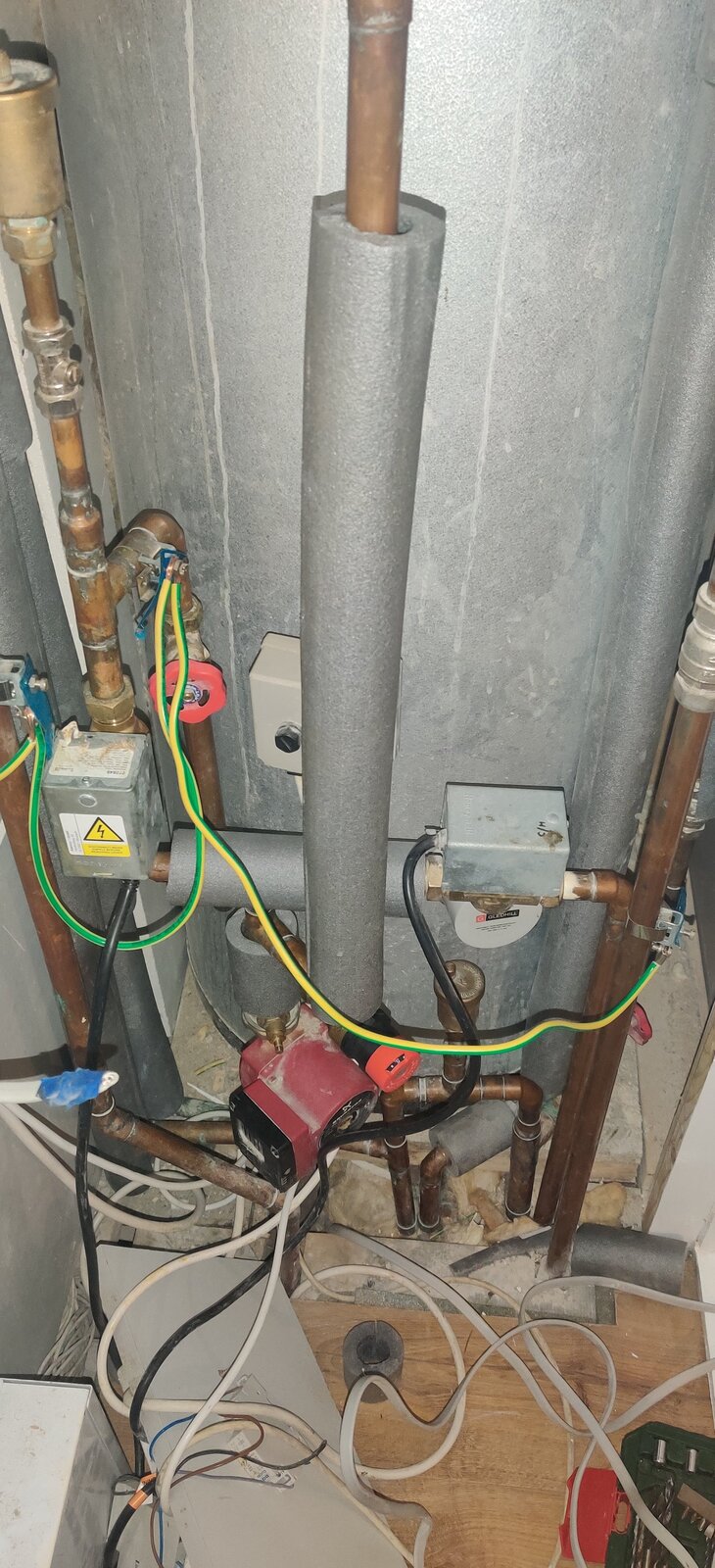

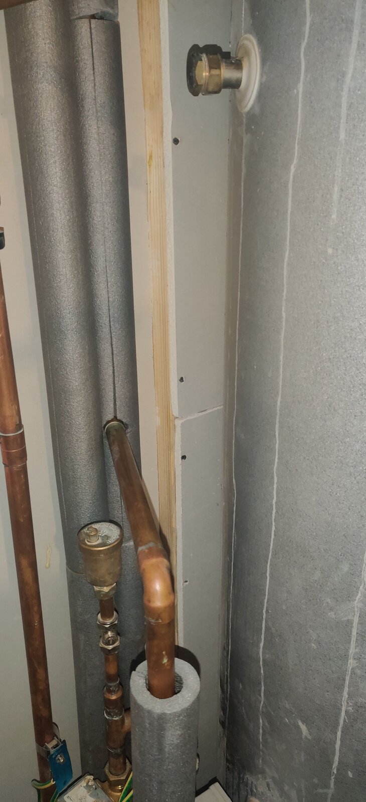

Hey, so recently we have building works done by all be it a not so professional builder or his employees, we had a new cylinder installed and all new plumbing the problem I am having is:

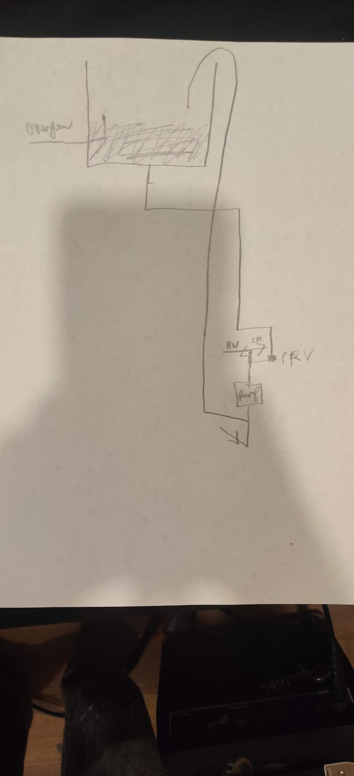

1. When the pump is turned on regardless of whether calling for HW or CH the vent pipe gurgles, if you watch the pipe as the pump turns on it sucks air in, but when the pump turns off it pushes air out with a trickle of water into the f&e tank.
2) The pump, ever since installed has been quite noisy, it vibrates a lot and you can hear it through the floor and the walls, it also makes a sort of air crackling noise on all speeds, the sound could be due to the fact they just drained the system so there may be air but it has been a week nearly.
I have attached pictures and a really rough diagram of how the pipework is on the CH side
Thanks for all the help, much appreciated

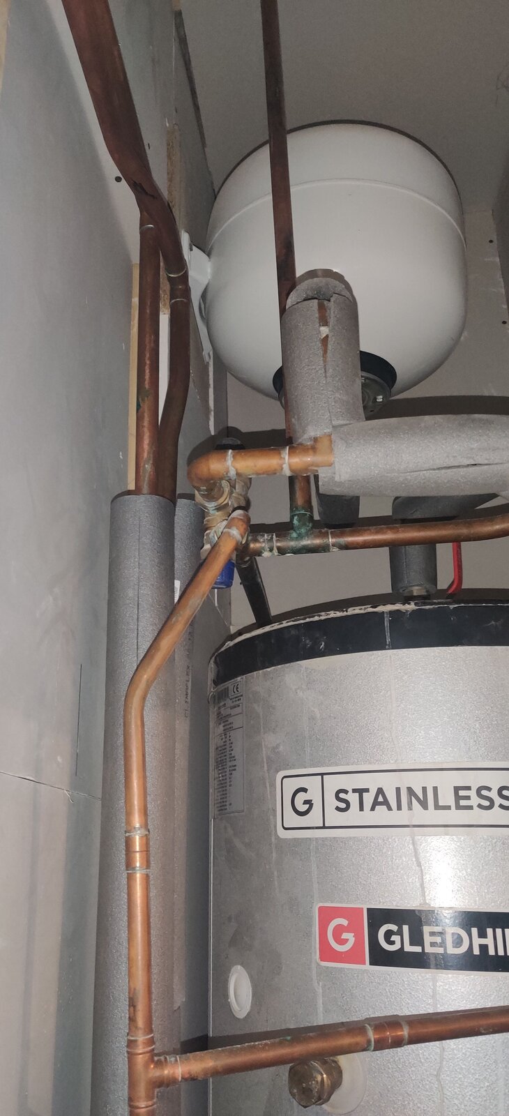

Is that photos of previous cylinder? I’m guessing it’s a thermal store, as opposed to unvented?
new cylinder installed last year in February. and what do you mean by thermal store? it's a hot water cylinder with a pressurised cylinder(correction it is an expansion vessel)
doesnt look new to me
brand new installed by builder last year
and it's an unvented indirect cylinder.
So why do you have a tank above then? Unvented cylinders don’t have them, thermal stores do. Did you receive a G3 certificate?
To be really honest I'm not so experienced in this field I have basic knowledge but with coronavirus, I can't get a plumber in, the builder also refuses to help because he says everything is correct. from what I know, and what the manual says (https://www.gledhill.net/products/unvented-cylinders/stainless-es/) that is the expansion vessel and is needed for pressure in the system.

This makes no sense, or is he saying if you’re not happy then pay for a plumber? Also can you post a photo of the cylinder label showing model. I can’t see how an existing tank is an expansion vessel.
Basically, the plumber who he employed he fired apparently because he had made to many mistakes, the plumber now works independently but sometimes does jobs for him, he says that all the plumbing is fine and if I want him to check it he will charge me to call the plumber, he said if I get any other plumber and they find issues he will not pay for them. So I'm stuck because I don't want to have to pay a big cost because he plumbed the system wrong. Anyways I've watched the model it's difficult to see because it's on the side of the cylinder but here:
  • Thanks
Reactions: CBW
The white cylindrical part is potable water expansion vessel.
Ok, I stand corrected. I wasn’t aware that the primary circuit could be open vented. In answer to the post above, yes potable expansion vessel is fine. I don’t work on unvented cylinders, so was unaware of them being open vented.
