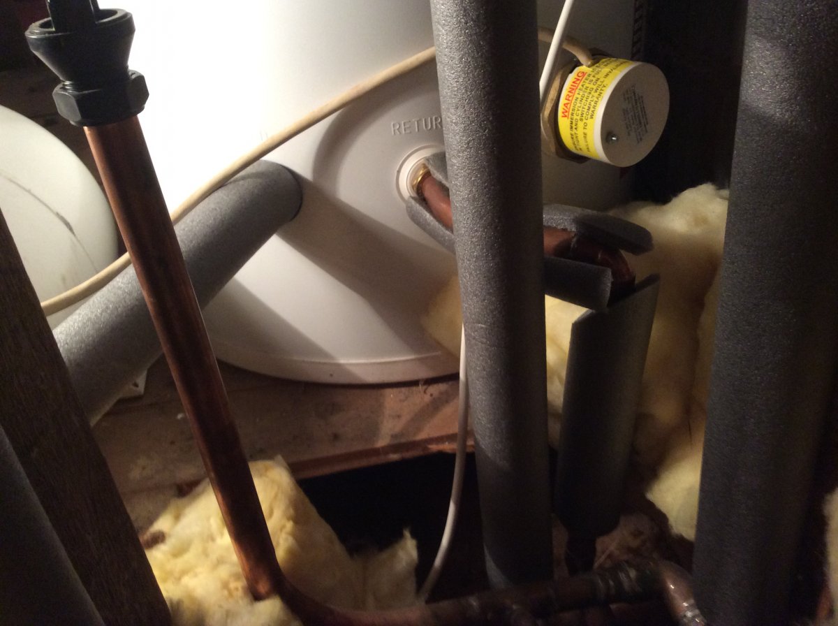

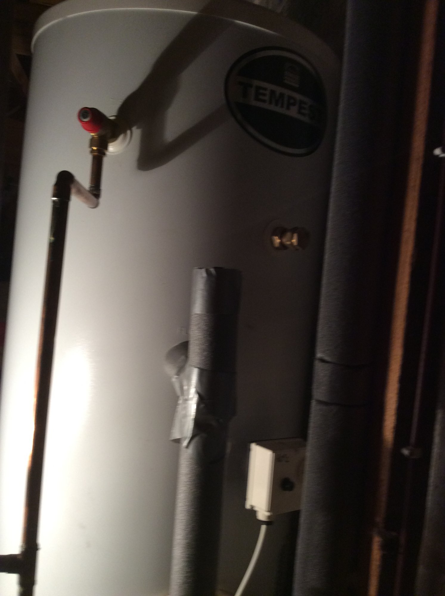

IMG_0516.JPG Hi Phil. I can have both heating and central heating off and it still happens. Wasn't sure if the thermostat is faulty on cylinder, therefore making it go on and off, its noisy at night, can hear through my pillows...here's pics...hopefully you can see them?..

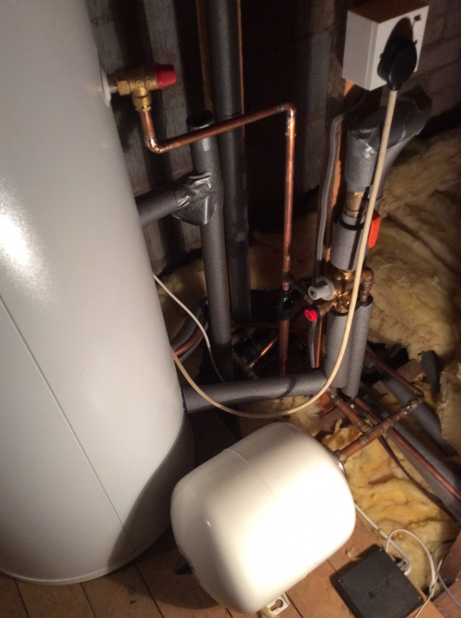

If cylinder fitted within last year then by pass not necessary as a different coil is now used on the verticals. The cylinder looks like it's a single coil and I presume is run by the boiler. It could well be circulation pump is running continually but I would of thought the other plumber would of identified that whilst there.
That immersion looks to be wired to a three pin plug which is a no no if drawing 3kws. Immersions should have a 20 amp DP switch to them normally but are only there for back up if the boiler fails.
You said it was wired to solar somehow but still think it shouldn't be on a plug. I'm no sparky though.
Is there a 2 port valve fitted with a sticky microswitch keeping demand running?. If it's a modern modulating pump the coil will sing at random times so fix the pump speed.
A circulation pump? Where would that be? I will ask plumber this question?
Also 2 port valve where would I find that?
If you steer me in the direction I will take a picture and you can advise if I have?

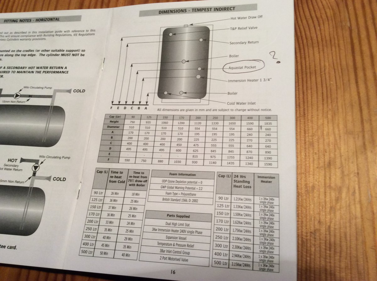

This is the booklet...I think it must be this page as plumber has written on this....

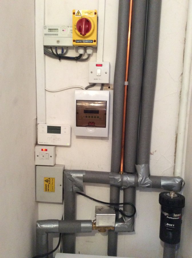

This is the thermostats above the boiler.
Big panel in middle solar immersion, kept that off all week. The one with the yellow switch beside is solar. The panel beneath is the thermostat
