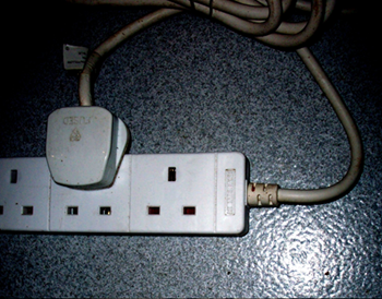

If the socket is such that that can be done with one of these devices, the same could presumably also be achieved using a BS1363-compliant plug, and even the NHS could not 'ban' the use of them!.
Actually no, a standards compliant plug cannot be inserted upside down in a standards compliant socket - that's part of the standard (indirectly.) Two factors at play :
* A plug is rigid, so can't be bent to allow insertion upside down using just the "earth" pin to open the shutter - the (msotly) soft plastic covers can.
* If the socket is standards compliant, the size above the earth pin is such that the L&N pins will foul before the earth pin goes very far into the socket. However, there are some extension leads where they are undersized and allow this - but then they are not standards compliant.
So just the fact that most of these covers are made from (relatively) soft plastic creates a new risk - that with little effort they can be forced in upside down, will bend to allow it, and will defeat the built in protection from the shutter.
* If the socket is standards compliant, the size above the earth pin is such that the L&N pins will foul before the earth pin goes very far into the socket. However, there are some extension leads where they are undersized and allow this - but then they are not standards compliant. So just the fact that most of these covers are made from (relatively) soft plastic creates a new risk - that with little effort they can be forced in upside down, will bend to allow it, and will defeat the built in protection from the shutter.

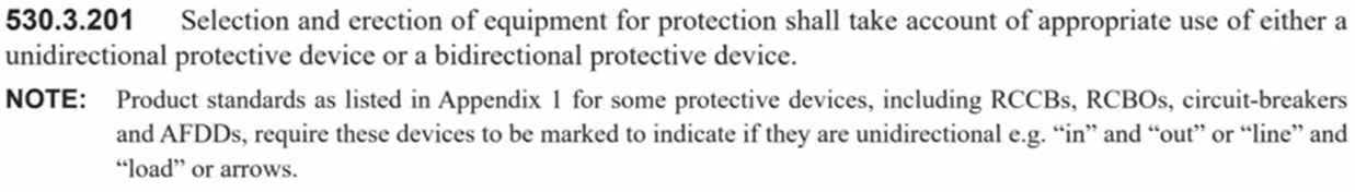

As to BS 1363, BS 7671, G98, G99 etc. These can all be altered, but as far as identifying unidirectional RCD/RCBOs that remains a problem. I can't see a simple way to tell the public you can plug in with this type A but not this type A.
I do see the regulations do say with the note, that they must be marked, but in and out is normally hidden by the CU cover.
I remember seeing one make with the marking on the face seen by user, and tried to find it as an example, doing this hunt, I noted how many type A RCBO of the short design were unidirectional.
With a RCD we could easy mount it either way around in a board, if it physically fits
when horizontal the direction of writing means nothing. But the neutral tail on the RCBO means we don't really have an option of which way around.
So we just hope that all unidirectional devices do have in/out marked.

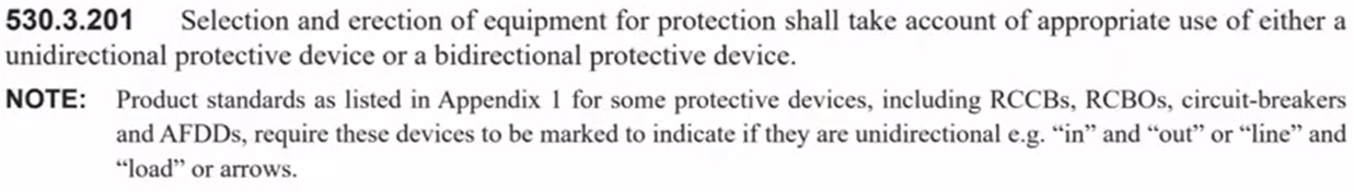

View attachment 415412 I do see the regulations do say with the note, that they must be marked, but in and out is normally hidden by the CU cover.
That's a new one on me. Where did it come from, since I can't find it in any version of BS7671?
No matter what you (or 'we') may 'hope', and as I've said, it it is surely the case that there are countless millions of RCDs (presumably 'unidirectional') out there in service (including well over a dozen in my house) which do NOT bear any such marking, isn't it?
For that reason, I find it hard to understand how any 'regulations' about plug-in inverters could possibly address this issue - if many/most people don't know (and probably can't ascertain) whether their RCDs are unidirectional or bidirectional, they can hardly be expected to comply with regulations that would require that knowledge ?! ;)
Spot on, I can't see how it can safely work. And it does not matter what amendment 3 says, manufacturers are not going to recall products to add to them the load etc.
As to "Line" is that a miss print? see page 9 it does it seem to require RCD/RCBOs to be labelled, but as far as plug in solar goes, that label must be readable without opening the CU, which with most it is not.
