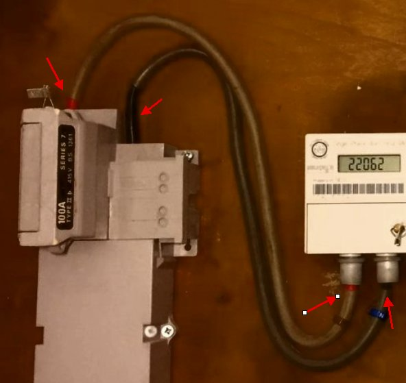

To be a bit more serious, if the photo we saw yesterday (insulation visible on four ends of cutout tails, to a ridiculous extent in one case) is anything to go by, there are clearly people out there (probably not DNO personell) working on cutout tails who take very little care/pride in their work - so goodness knows how careful they are to make sure that the terminations are secure. It would therefore not surprise me at all if there were at least some fires originating in plastic cutouts (and/or meters, maybe even more than those originating ion plastic CUs :) ).

What photo?

What photo?
upload_2018-5-14_22-55-27-png.141788
