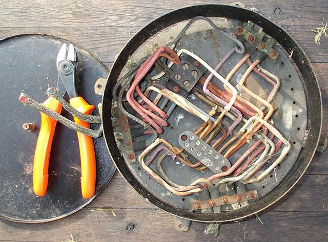

non-modern lighting wiring in attic

Those old joint boxes are so cool, so much wiring room and well thought out terminal design and cable clamps. You don't get that now.
hah, very interesting photos here! Thanks for all the comments.
What I did in the end was a rather over-engineered solution, and unnecessary considering that all the cables came to a central point. But, it gives my friend confidence regarding the layout and it didn't really take much longer than sticking everything into one box. Basically I split it all up into four new junction boxes (the 65p-from-screwfix sort), one for each of the four lights+switches being served, with just very short cable between each box, and mounted them all on some board which I then mounted low on the back wall of the attic.
(I also added a fifth junction box to serve the new attic lights which was the whole purpose of my original investigation)
First time I've used them! In my own house I looped in at the ceiling roses but I now see what a damn pain that actually is.
