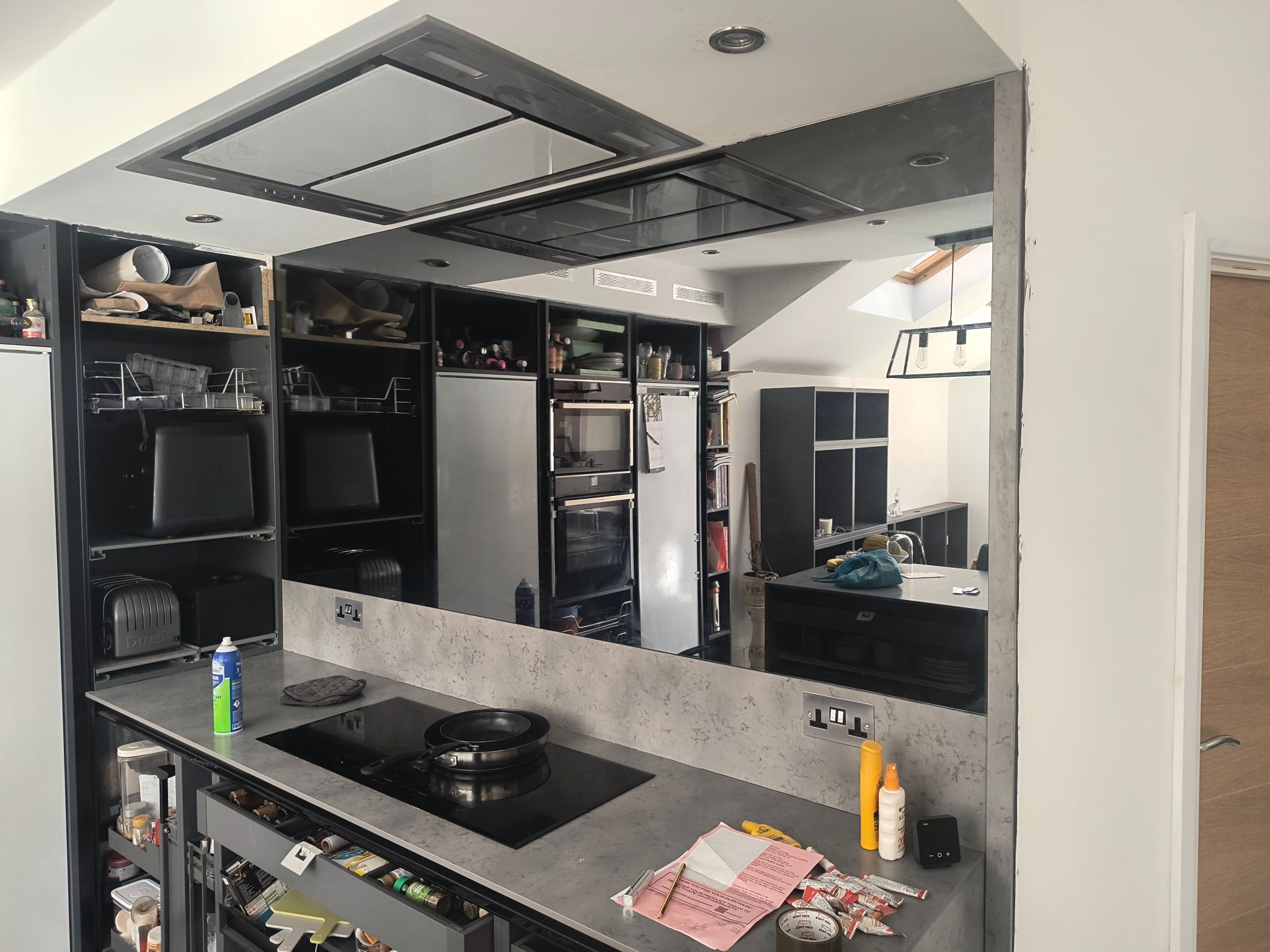

I'd be happy with Stixall round the perimeter, say about 25mm so you could chop it out if necessary (not sure why).
My big mirror stuck on with Stixall:
