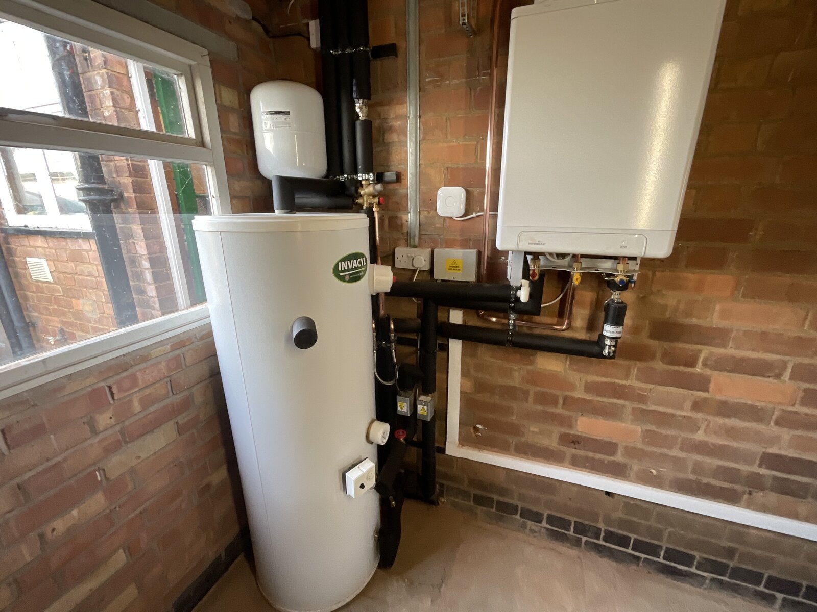

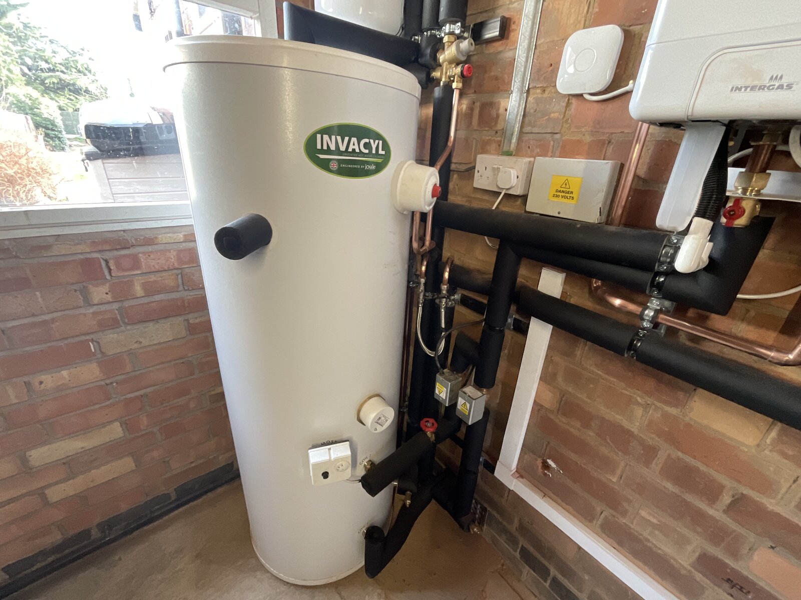

If you are looking to minimise space use then @muggles approach is a great option. A high recovery coil with a cylinder close to the boiler on HW priority will give ample HW with min recovery time. All you need to decide is the max HW usage you may have (bath or extended shower use) to determine the size of cylinder.
Heat loss over 24Hrs with a modern highly insulated cylinder is very low so that isn't really a factor. If space is the key to you then that and usage would drive the cylinder size. If you have a sustained 18L/Min @ 4 bar then there will be very little impact on flow when multiple outlets are used. That would be reliant on 22mm distribution pipework from the cylinder to as close to the outlets as possible to maximise flow. it would also open up the ability to use the HW outlet from the boiler too.
To give an example, recently installed a 24Kw sys boiler with a 200L unvented. Mains is 23L/Min @ 3.5 dynamic .... 2 bathrooms .... 2 showers ... with both showers running and hot and cold tap in kitchen there is still 16L min delivered at the outside tap. It has a 32mm mains, drops to 22mm distribution pipework until it exits the floor when it drops to 15mm (no flexi's/reducing ISO's are used anywhere on the system) m12 hard pipe for the mixer taps. The dynamic figures are key to the whole system working as it does. It is a true dynamic figure where the flow is sustained even with multiple outlets being used. Without that mains and the pipework/fittings there would always be a danger of a noticeable reduction in flow.

It doesn’t sound like you really need the extra complication in your case, personally I’d recommend you either just go the combi route or take @muggles advice and fit a hot water priority system like this one…
