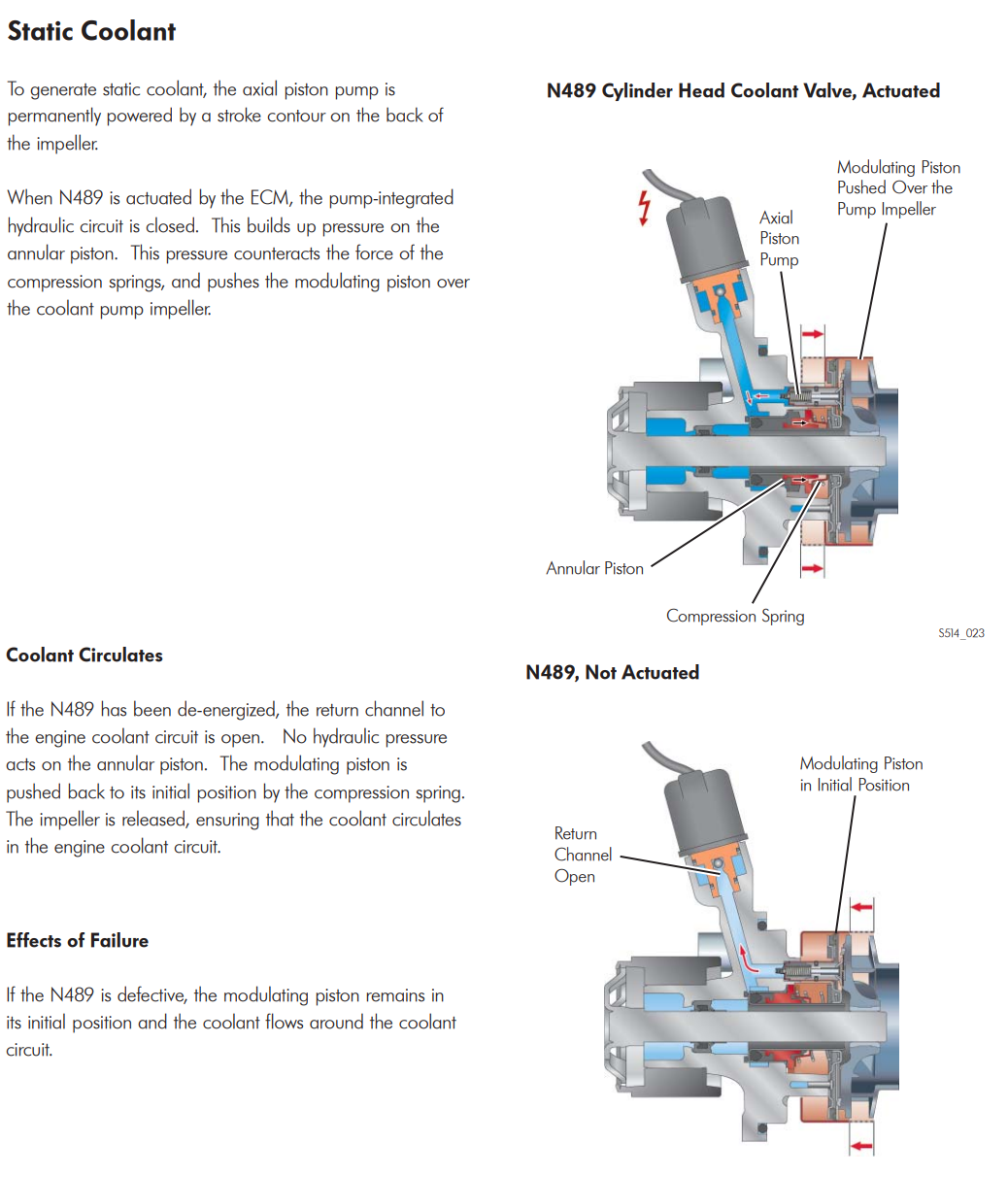

Was it a clutch, or was it a moving shroud that goes over the water pump impeller when the engine is cold, to speed warmup? (The latter being what is in our 2 litre diesel Kodiaq and they're famous for sticking).
I didn't realise that my car actually had one of these pumps......the pump impeller has a shroud over it that presumably moves out of the way as the engine warms up - a new one on me and I've no idea how effective it is.
I unbolted the original sensor and fitted it to the new pump.
Thankfully the original one was just fine and had been completely reliable so fingers crossed for this one!
This fancy pump is around £100 more than the standard item - whether it's worth it is unknown to me.
John :)
John :)
They're a brilliant idea, poorly executed. One the back of the impeller there's a little hydraulic pump that takes a bit of coolant and tries to pressurise it. When the engine is hot, there's a solenoid valve that just bleeds that pressure away internally, but when cold, it "pumps" this shield out against a return spring, and covers the impeller, which all but cuts off the water flow and speeds up the engine warm-up period. Once warm, the ECU tells the valve to open, the pressure bleeds away, and the shield retracts. Sadly, they're famous for sticking and causing the car to overheat! Received wisdom is to change them when the cam belt is done. Funny enough, ours overheated (slightly) a week before it was due the cam belt, so we got it done. They definitely do speed up the warmup time in cold weather (and they're loads cheaper than having to fit a combustion heater)!

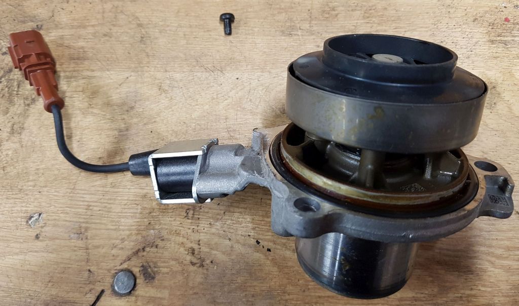

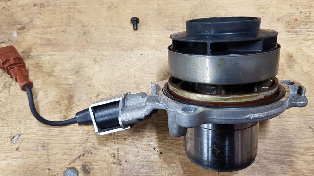

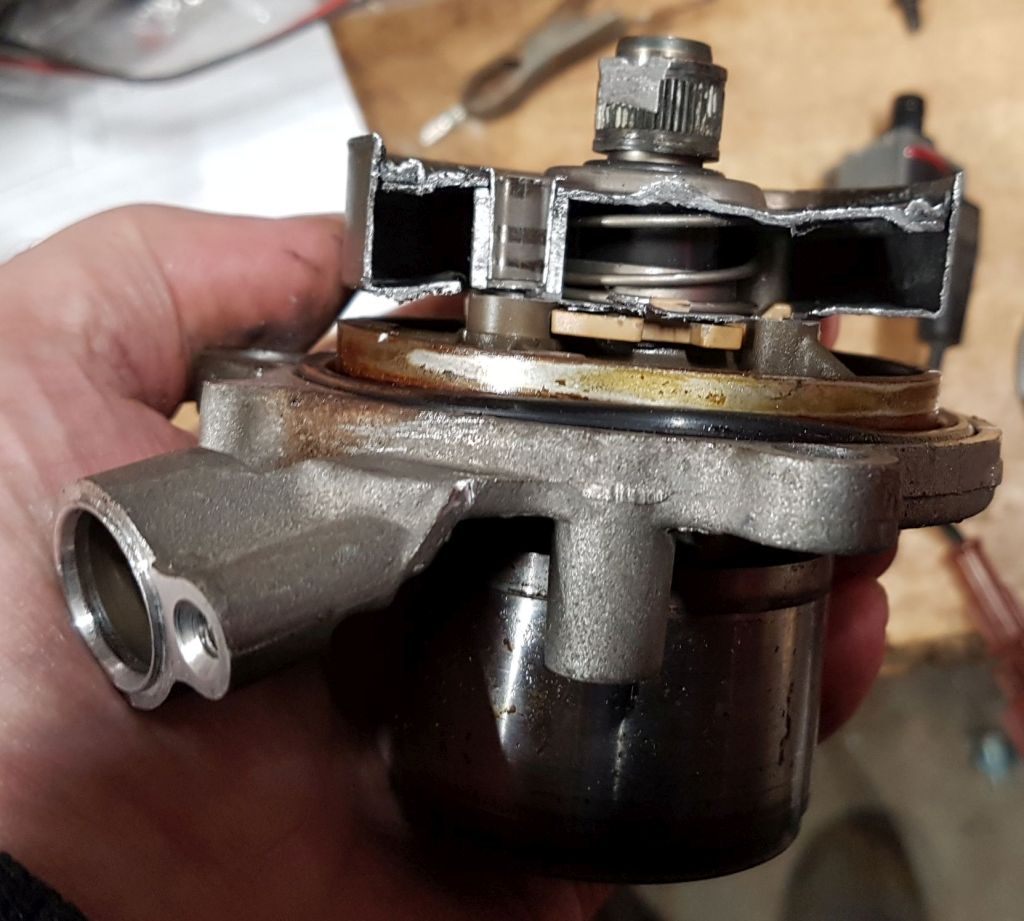

Alas, they don't seem to! I asked the dealer to give me ours back after they'd changed it, and I chopped it up to see what was inside:
Here it is in the "cold start" position with the shield over the impeller.
and here it is with the shield retracted.
This is it, having been very crudely chopped up.
I think the problem is that putting it into "cold start" mode, requires the pump to build up some pressure and push it there, but moving it to the "warm" position, is only done by the return spring. My guess, is that there are some nylon moving parts in there that swell and stick in their bores, so that the shield can't retract, but the pump will always be strong enough to push it out.
Sometimes, they do it intermittently, and a few people say they have been lucky enough to pull the connector off the solenoid valve on engine shut-down when the temperature is OK, so that on the next cold start, the shield can never come out again, because there's no feed to the solenoid valve. The pump just works normally then (but the engine takes longer to warm up).
