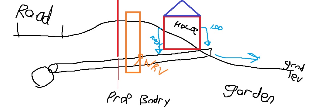

I'm thinking of installing an NRV in my houses main sewer line to avoid backflows from the street's main sewer during intense rainfall.
I know there are loads of pros/cons/pitfalls etc - and I'm getting a bit dizzy looking into all the options.
Does anyone have any practical experience of installing and/or living with one of these?
I like the idea of an open one (one of these in a new inspection chamber) so I can spray it, rod it etc to keep it maintained without getting down and dirty with bolts and lids etc. The head of water I'm dealing with would be OK with this setup.
However, most places only seem to sell/recommend these - which look like they have so much potential for going wrong - then being impossible to repair without hugging it to get access to the internals.
I also don't like the idea of those retrofit jobs - where you just slot them down the pipe - they look to reduce the capacity of the pipe and introduce too much of an obstacle. My overall sewage line gradient is very low.

@freddiemercurystwin - ground levels. Gradients work against me and dip the opposite direction to the drainage route.
My garden has the lowest ground levels in the street, the drains run about 8" below ground in my garden. It's about 3' deep in the street. From my garden towards the road, the ground level rises, then drops off again slightly in the street. My property boundary includes the high ground towards the road.
The water would spill elsewhere before it overtopped my new manhole. I would also specify a screw down lid. A five year old would describe it as so:

The connection to the rest of the sewer is a standard outfall, several house's branches come into a 90deg bend into a pipe of about 12" dia in the chamber in the street.
Unfortunately, a there is a lateral inflow from a highway gulley (not shown on my diagram) between my property and the outfall into the main chamber. If someone put an NRV at the outfall - during the storms, the inflow from the highway gulley would cause my sewer to flood anyway, and I'm no better off. Well, it would be cleaner water after the initial flush.
*But*, the neighbours also have their (mostly private branch) leading to a gully that also backs up when it rains a lot. They are oblivious, and in denial that it backs up - so the reality of putting the NRV at the end of my branch, is that the water would probably surcharge from my neighbours drain, run straight into the highway gulley, then back into my system - bypassing the terminal NRV. So would need their own NRV too, and the highway gulley diverting (or also NRVing). But no chance of that due to the aforementioned denial.

Part of the problem is that ground levels for the entire street go against the gradient of the sewer. There is almost no fall, but it's ~15 foot deep by the end of the street. My property is like a nested microcosm of the wider system.

Thankfully, it's not that deep. It will be about 3 foot deep, so an old fashioned brick build inspection chamber will allow inspection and installation. I'm not pressured for space either, and there are no electrical services near it. Just my incoming water main (which I want to re-lay too - but that's another story!)
