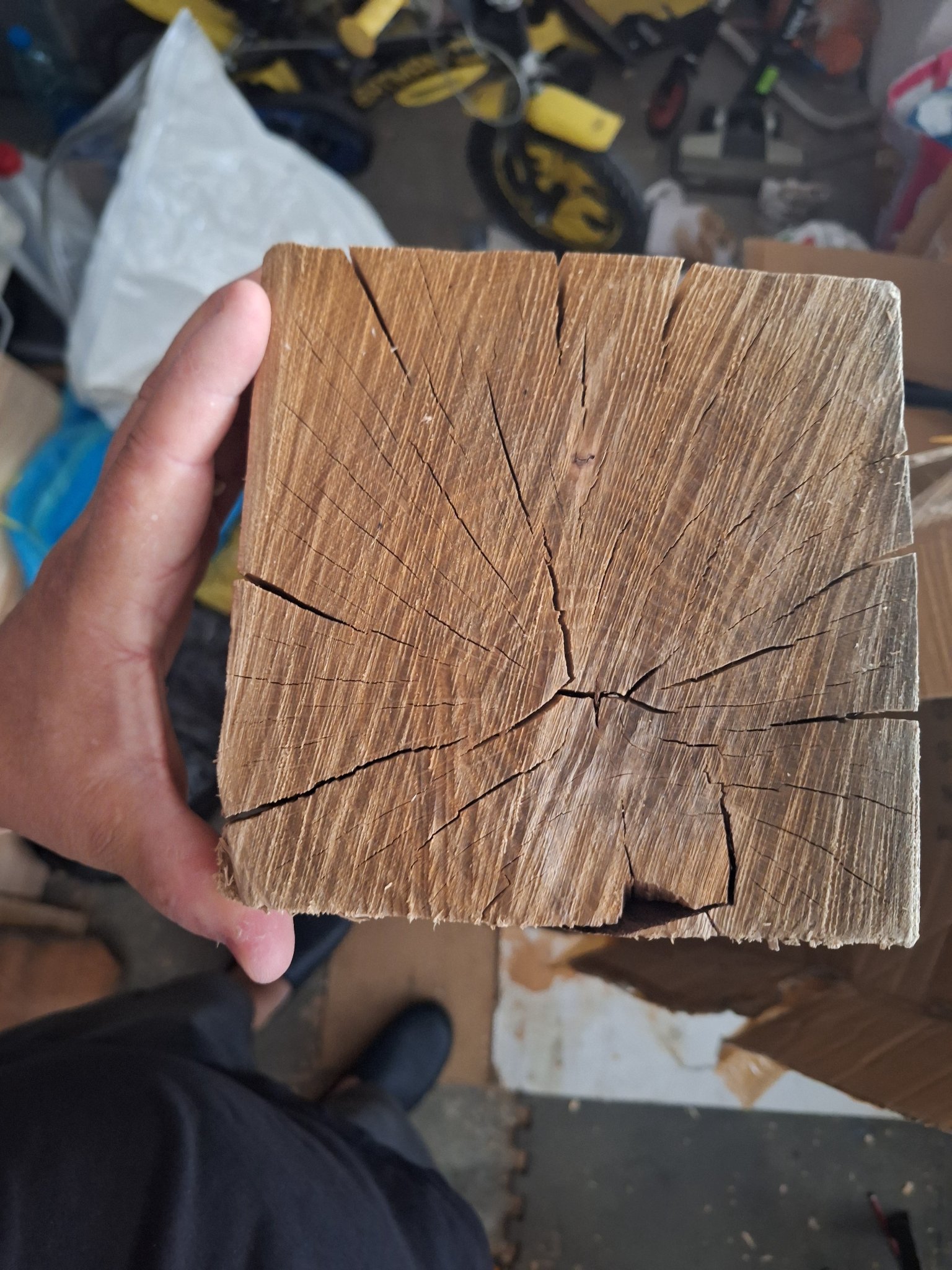

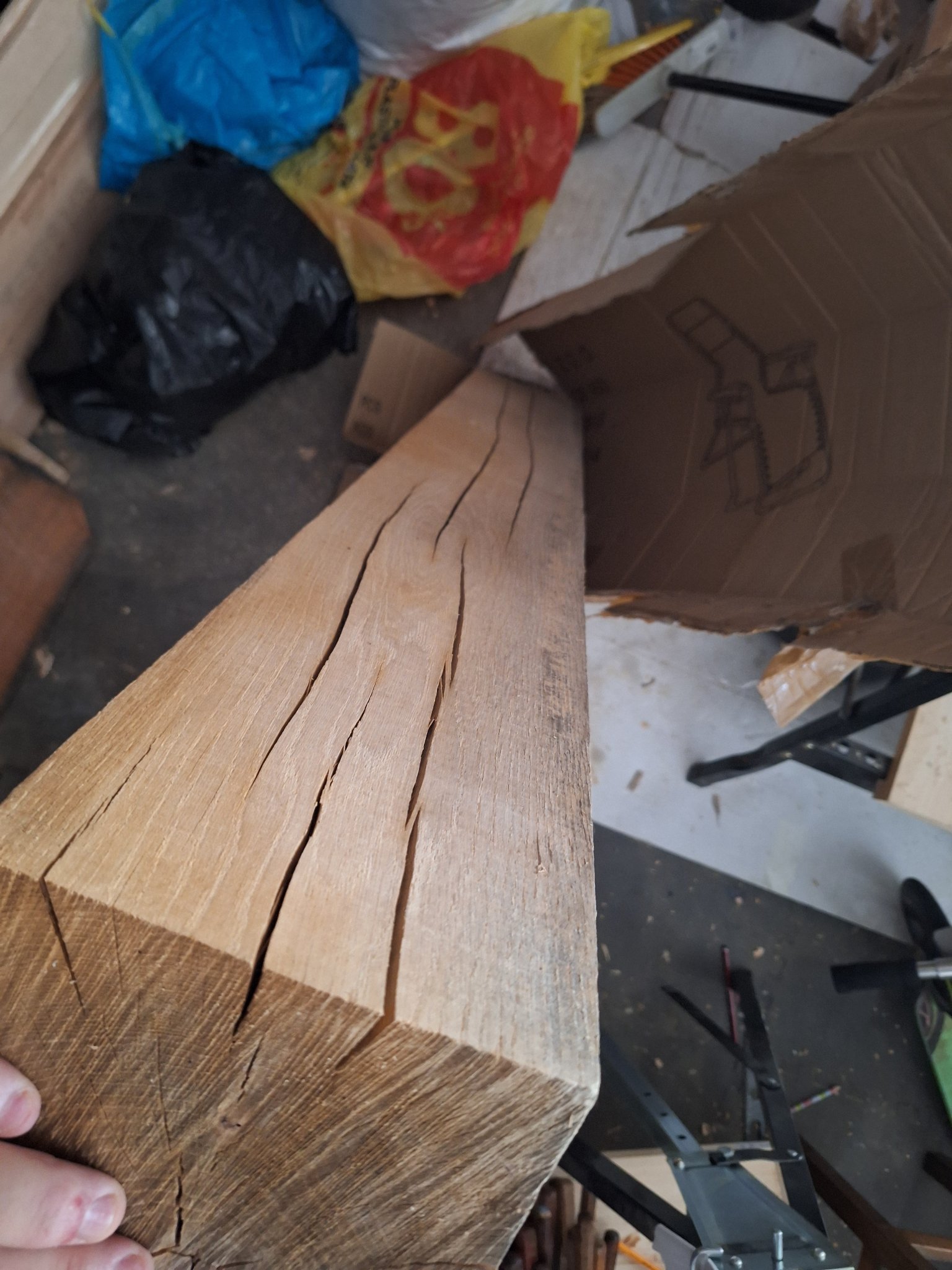

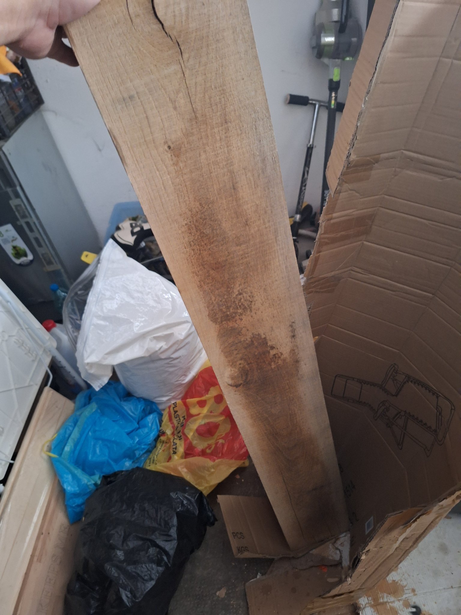

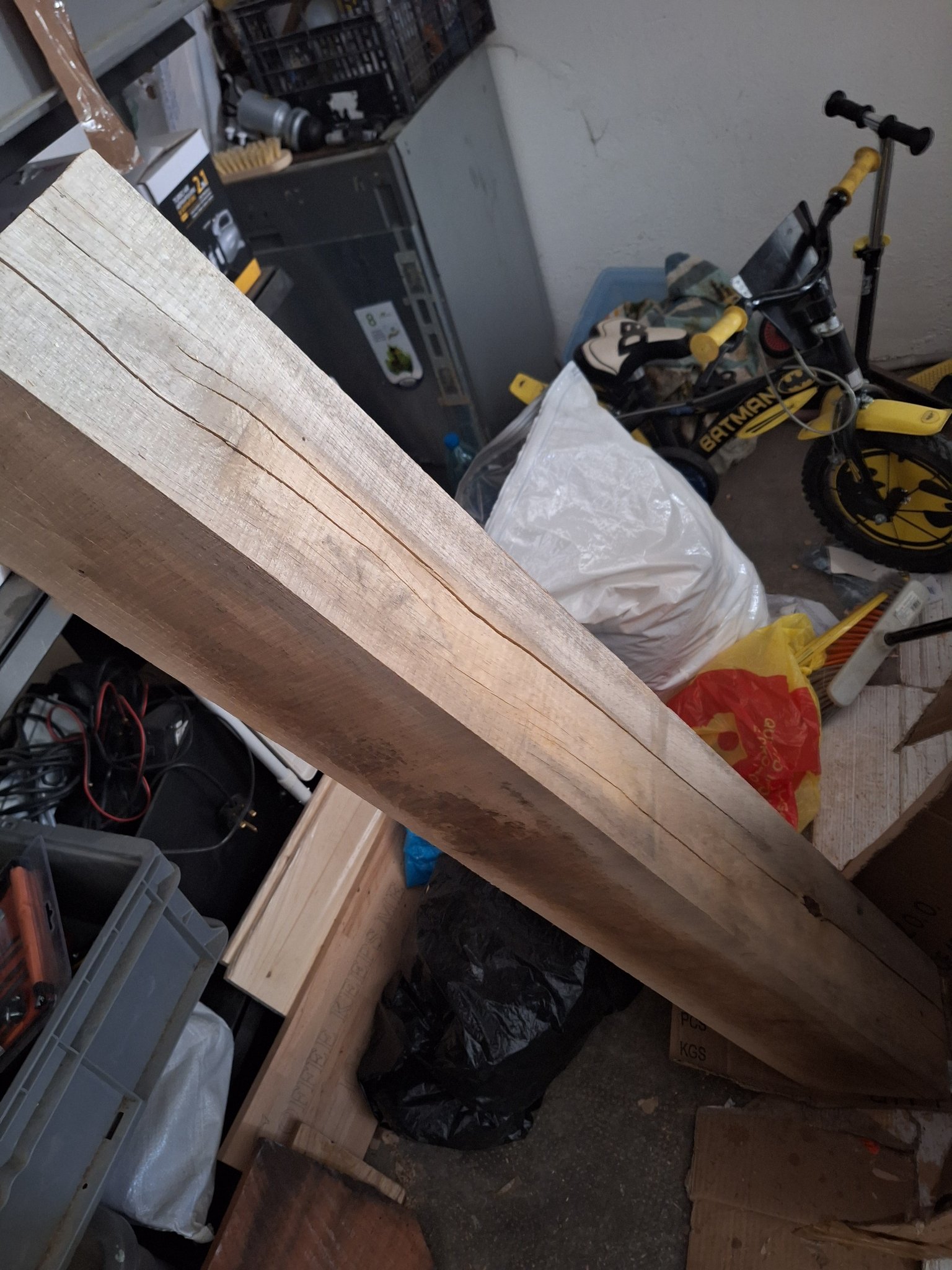

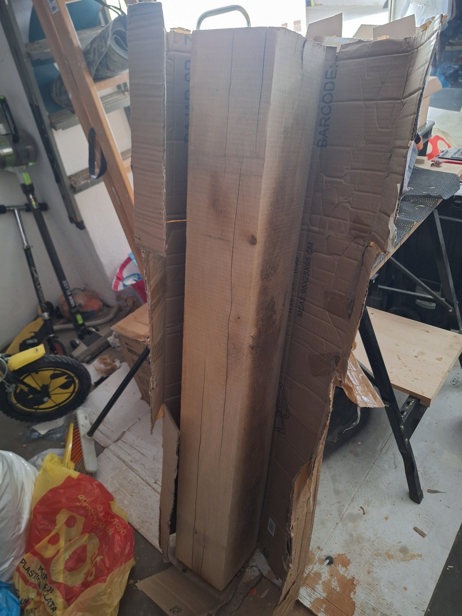

Got this planed piece of oak to make a mantlepiece 140cm x 16cm x 16cm...its very heavy i guess as is not dried out...not sure of how it was processed as i bought it online...would appreciate any advice on how to best go about treating it, and then securing on wall...the chimney breast its going on has been constructed with hollow blocks and then a layer of cement (house is in Italy)...the breast is then going to be tiled all over...not sure if better to add mantlepiece and then tile around it or put on after tiling. Also whats best way to secure it to wall?

By the cracking, it looks fairly dry to me but that doesn't necessarily mean it's seasoned. You'd need to know when it was cut and how long, how, where it was stored thereafter. If you don't have time on your hands then you could just install it now. I've always used Briwax on the ones I've done - as long as it's not going to be too close to an open fire. For woodburner it should be ok (that's what ours was).

thats the rubbish pith leftover after the mill has plain sawed the good stuff - look at the shrinkage cracks in it, and it may still get worse, that bit normally gores in the fire not above it.
I do appreciate that some want this rustic look, but basically you are recreating something that was originally badly done.
Its prob not the best piece of oak i agree but i think for what i want its fine, i wanted a more aged look, i plan to round of the edges a bit, sand it down and stain it a bit darker with some oil stain...i originally bought a reclaimed, finished oak mantlepiece, made from an old barn beam, and it arrived full of worm holes and with big areas of crumbling wood...that was a bit too rustic...this piece was much cheaper and at least its solid...and tbh there isn't much choice here, wooden mantlepieces are not as popular in Italy. My shopping list so far is;
