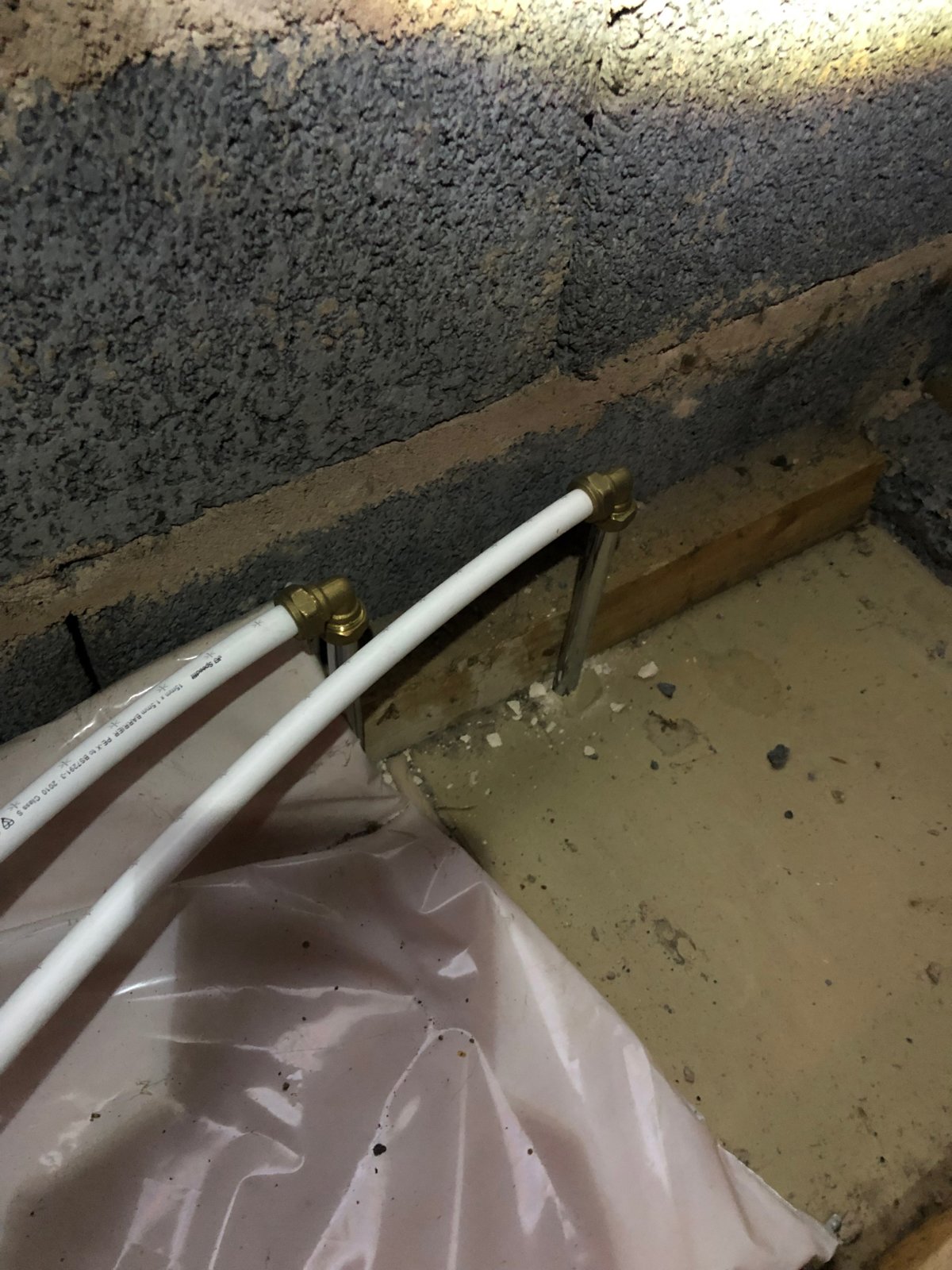

Not long moved into a new house. It has an old gravity fed water system. There are 2 showers upstairs, both running from a pump in the airing cupboard. One works perfectly and the other will not hold its temperature for love nor money. I assumed (wrongly it seems) that because one was fine that the fault with the other one must be the thermostatic valve in the shower mixer. Because it was fairly cheap (and an easy bolt on job) I simply bought a new shower with the same fitting and connected it up. However it's exactly the same as the old one - temperature all over the place, a tiny movement of the lever results in a massive change in temperature etc. Can anyone point me in the direction of what the issue might be?

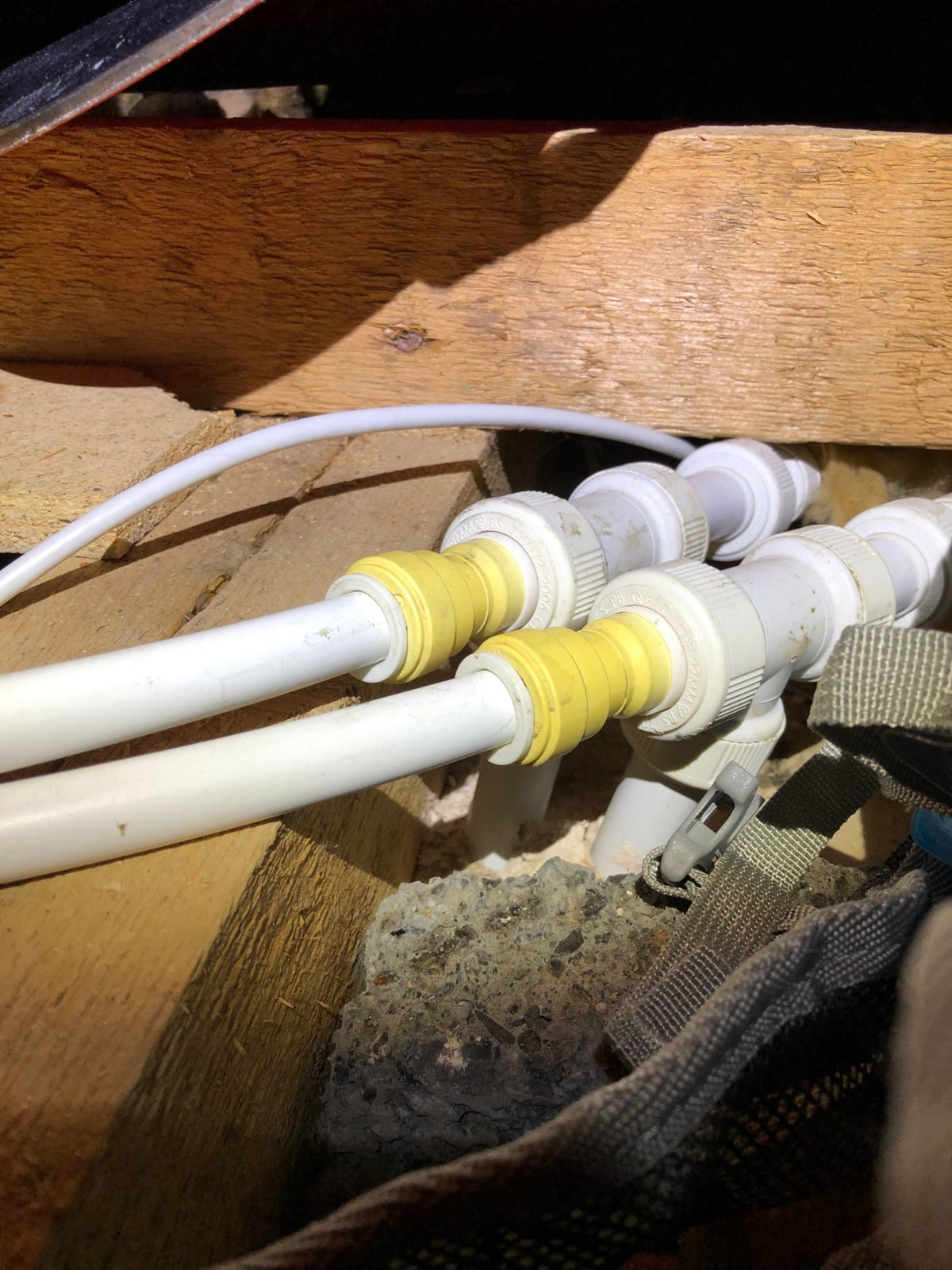

The hot pipe is the one on the left. Does that mean that reversed pipes is not the issue? If they still need to be swapped there are 2 places I could do it, one being a plastic to plastic join, and the other being plastic to metal. I've attached pictures of both for clarification. Which would be quickest/easiest/least likely to leak later on?

If the mixer is fitted upside down, as sometimes happens, its inlets will be the wrong way round.
You do mean that both hot and cold suppplies come from the loft tank, at low pressure before being pumped? The cold doesn't come off the (high pressure) watermain supply?
Yep, as I stand looking at the shower the left hand pipe is the hot and the right is cold. Does that mean I shouldn't swap the pipes over and that something else is causing the temperature fluctuation?
1. If the shower bar has been fitted upside down, this would have the same effect as connecting hot to cold and vice versa.
2. If they are the same shower in each room, are they mounted the same way up?
3. Otherwise, if the hot pipe is correctly fitted to the hot in side of the shower, the problem lies elsewhere.
4. First point to check would be any filters and / or non-return valves fitted to the outlets from the wall.
5. Photo's of both showers would be useful.

I'll have to get up into the loft to double check but as far as I recall the hot is pumped (the pump is situation next to the hot water cylinder) but the cold is supplied by a tank in the loft (mains goes to the tank and gravity brings it from the tank to the two showers).

Do you mean that the hot and the cold are at different pressures?
That would (does) cause it.
