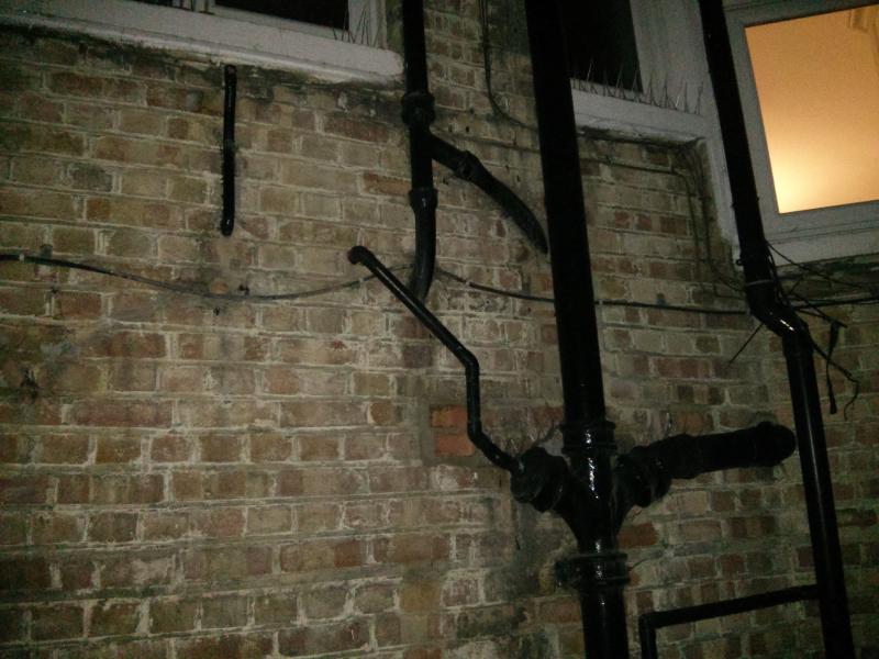

Can you see the pipework on the outside? How/where does it run? Pictures might help.

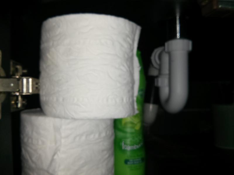

Ok, so took some photos. One is of the pipework beneath the sink.

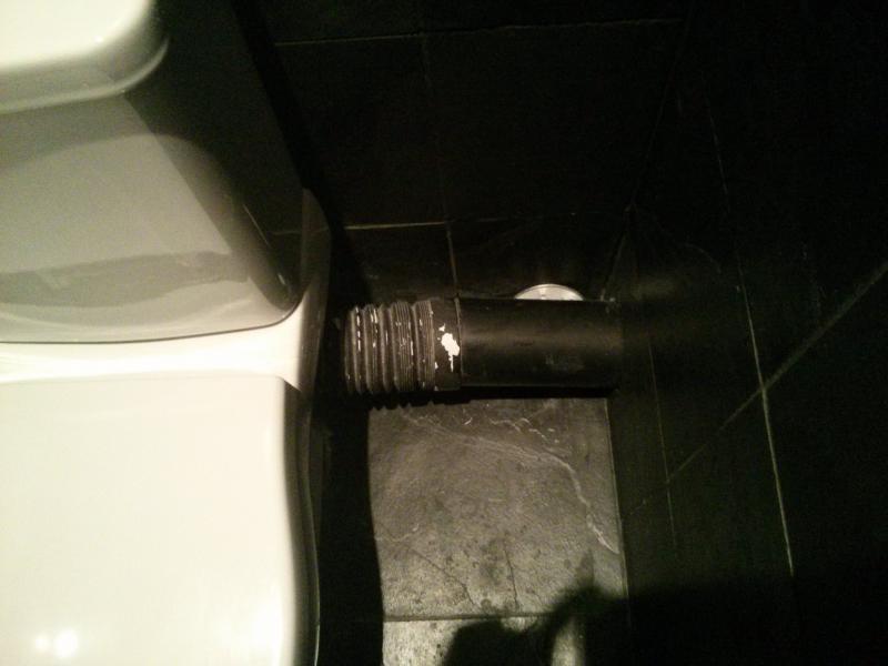

The second is the waste pipe from the toilet. The shower is out of picture to the left of the toilet, but presumably the drainage pipe from the shower joins this main waste pipe, as on the third photo from the outside, there's only one waste pipe exiting.
So the 3rd photo - you can see the waste pipe from the toilet on the right hand side, running from right to left. The pipe from the toilet is on the left hand side - there's a pipe, furthest left, running from just under the window frame. Not that one. The next pipe on the right is from the sink.
So for the shower, I'm guessing it's most likely the problem is going to be beneath the shower itself? But not sure what the problem with the sink is, unless the pipework underneath the sink has been done incorrectly?
Update – I kept the shower running after having plunged it so it drained smoothly, and tried the sink at the same time. It still didn’t drain properly, so I’m assuming the two issues are unrelated. I’ll have to get someone in to take up the shower/tiles to access the waste pipe, but does anyone have any thoughts re the sink? Does the pipework per the photo look correct?

So the basin waste is the one at a steep angle joining into the main stack at the branch? Can't see any reason there why it wouldn't drain properly so would assume the problem to be inside.
Are you sure it isn't clogged with soap scum, perhaps in the pipe after the trap as it passes through the wall? Could it be the same issue for the shower waste too?
