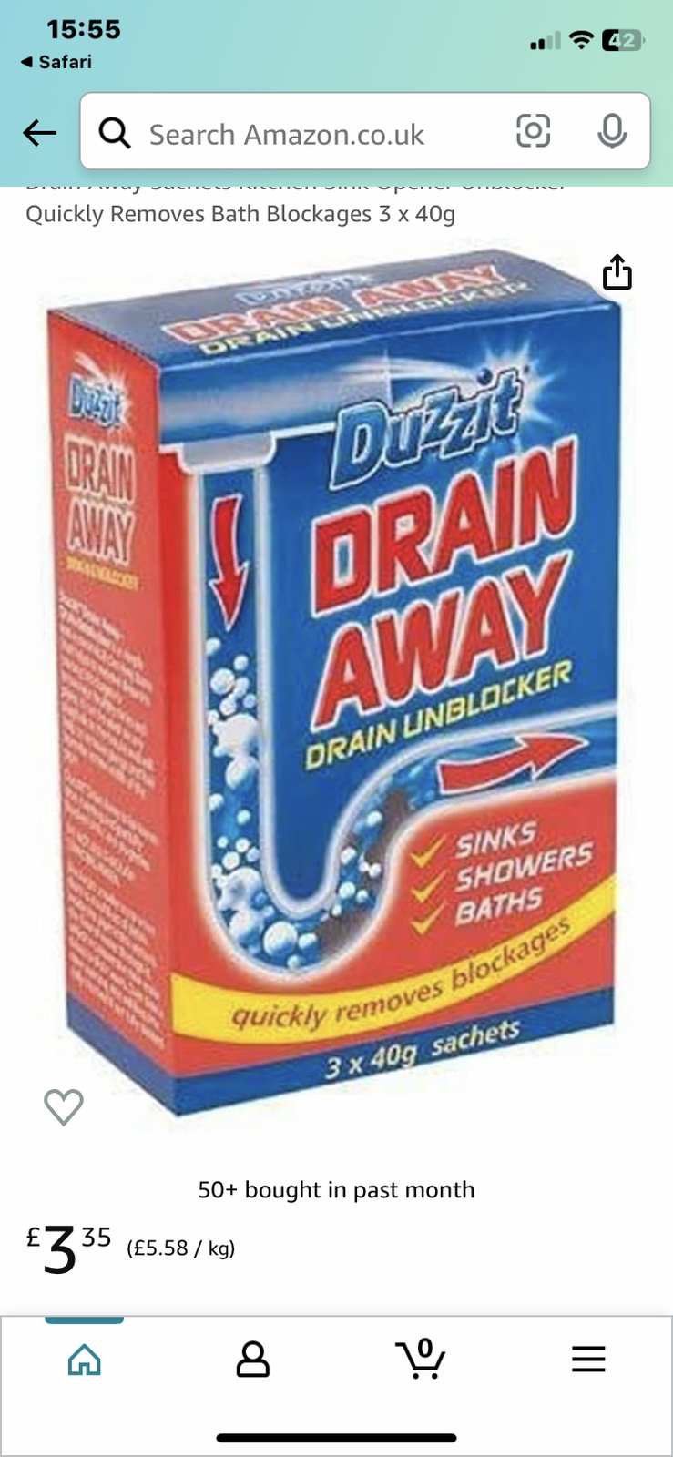

This stuff worked well for me on bath and basin .
Thanks, I'll give it a go. There might be an issue in that the blockage, if it is a blockage, is someway along the pipe, so will this reach a relatively long distance. Worth trying though.
