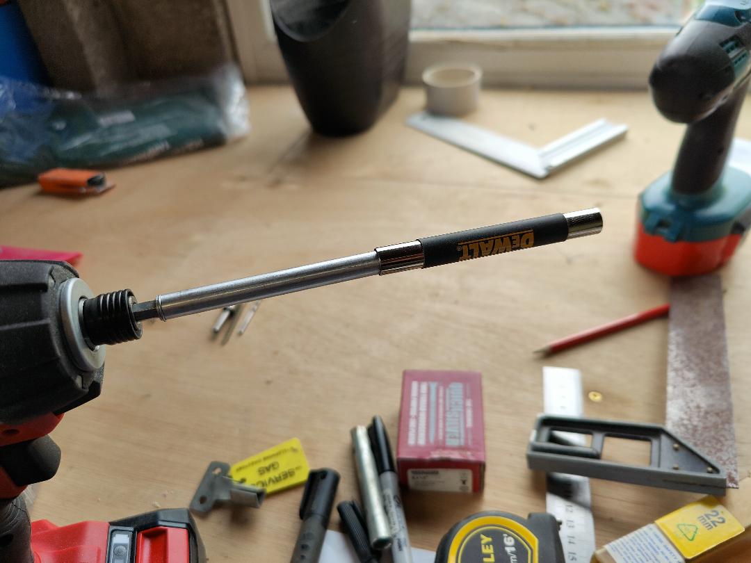

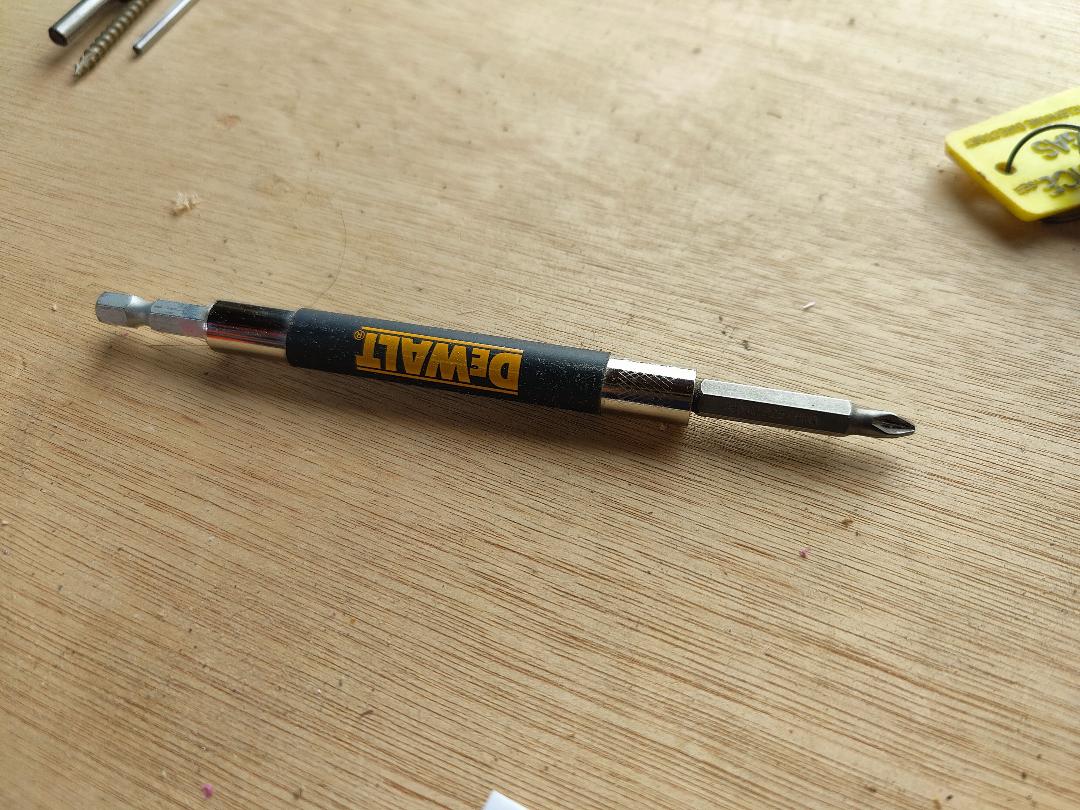

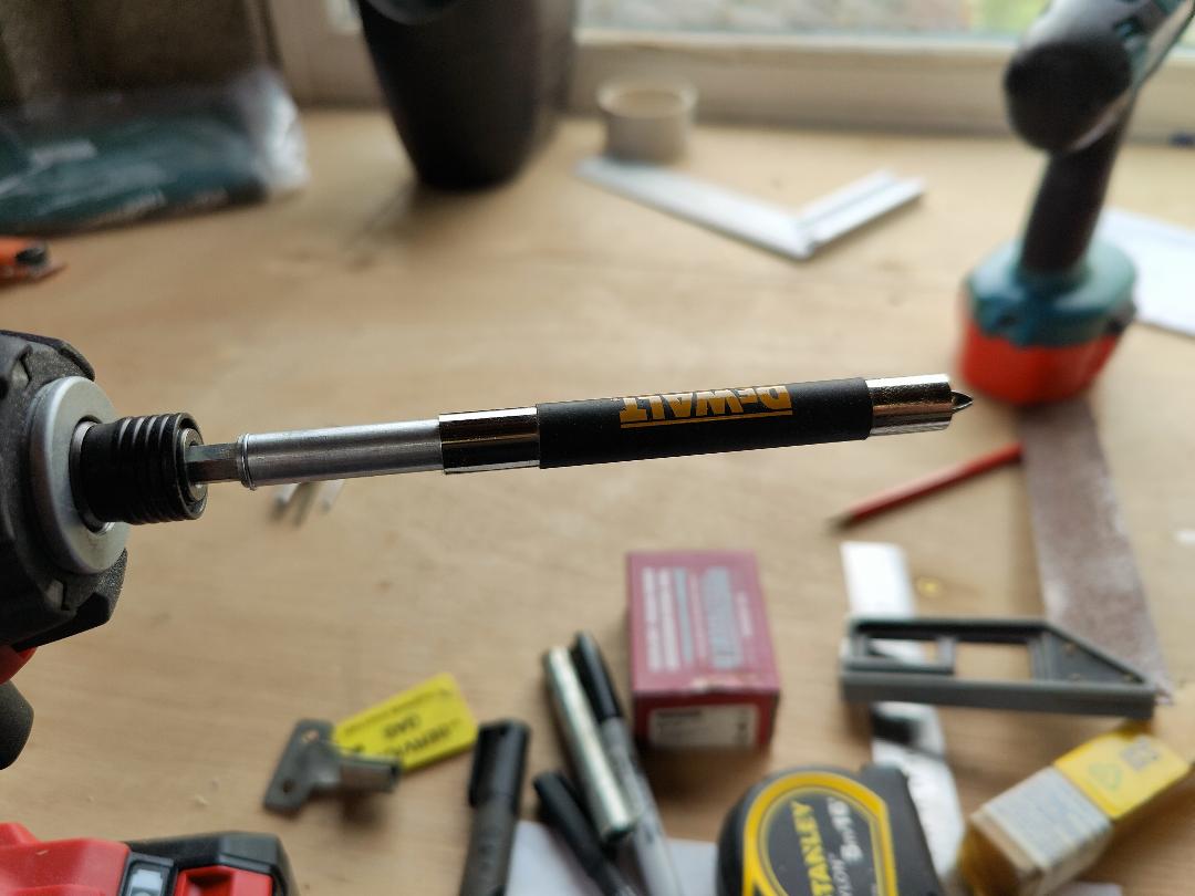

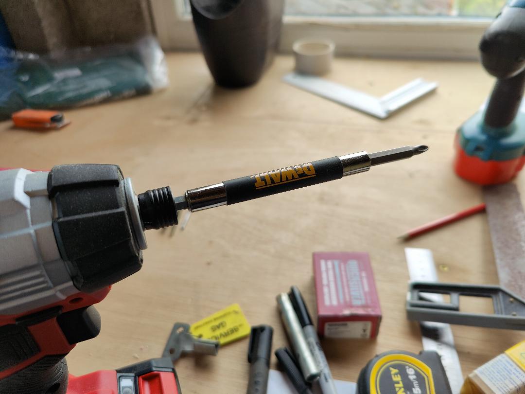

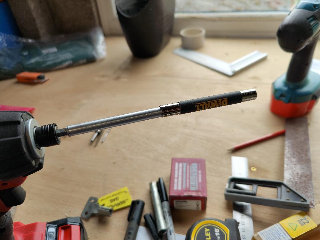

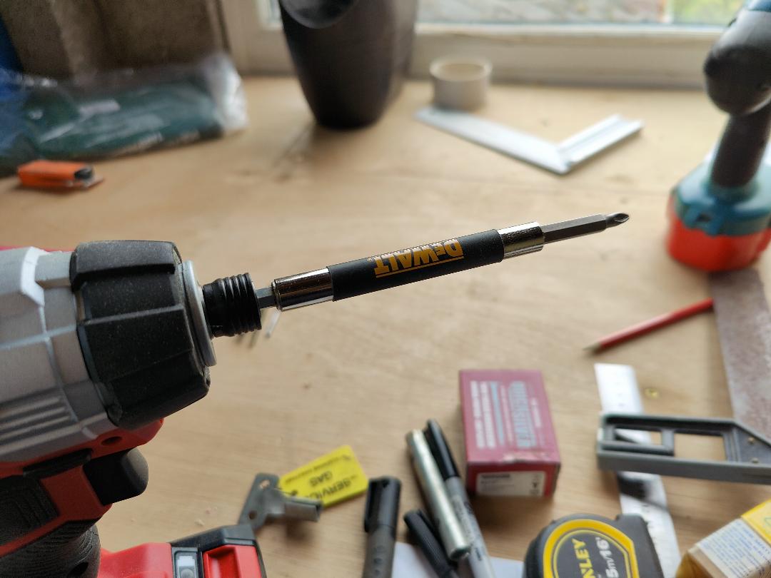

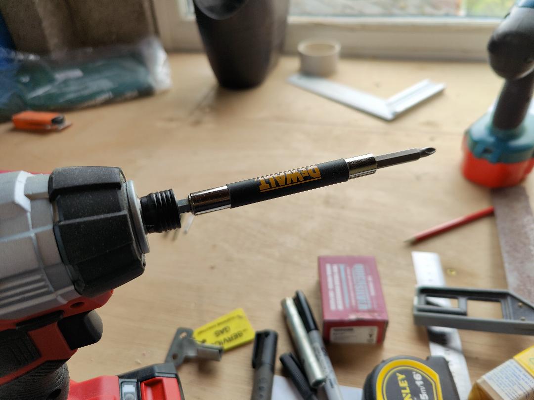

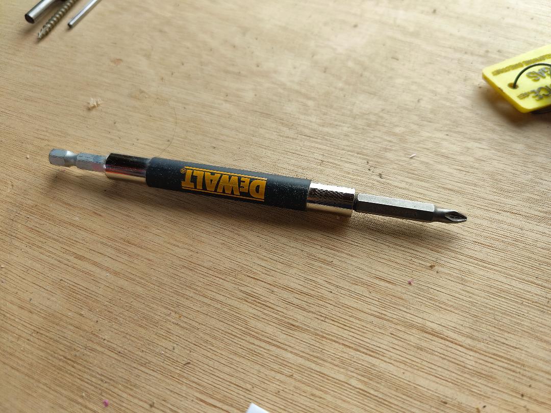

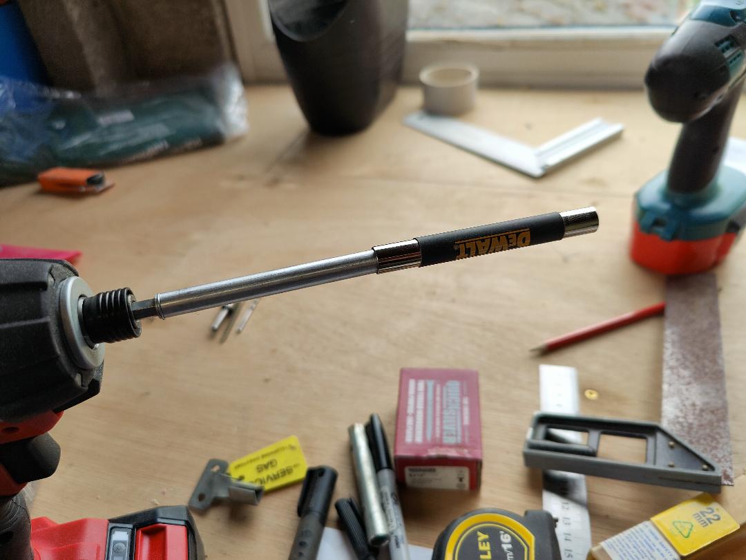

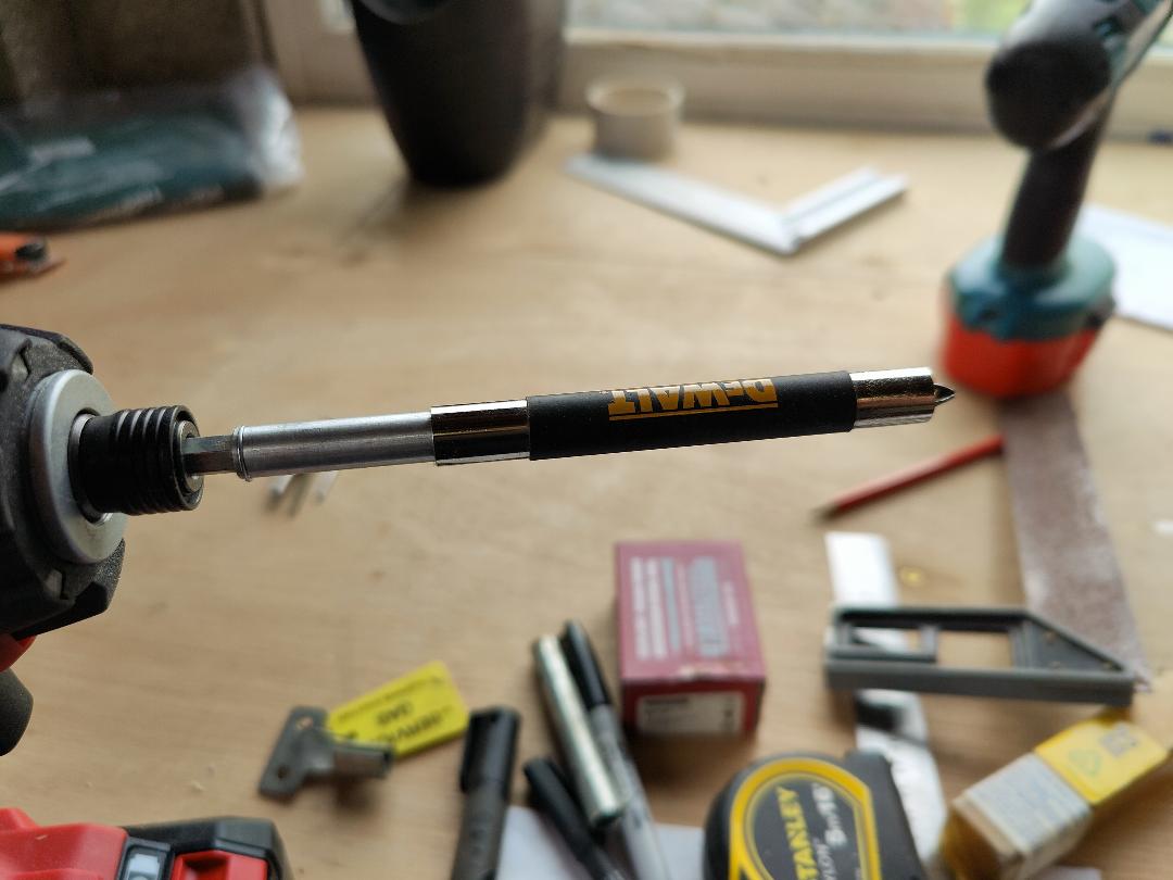

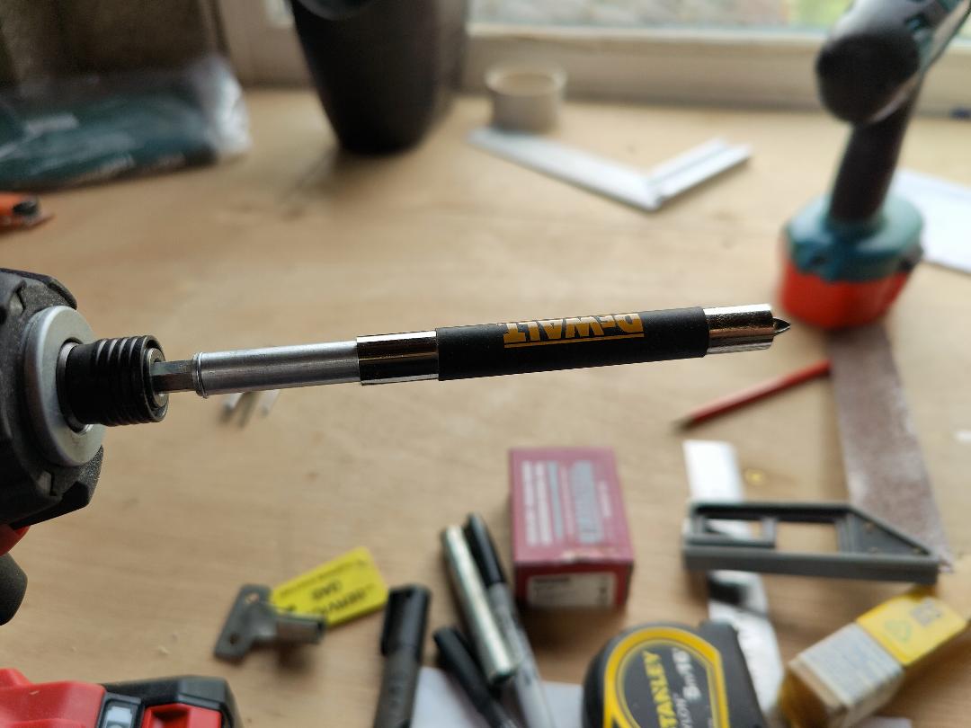

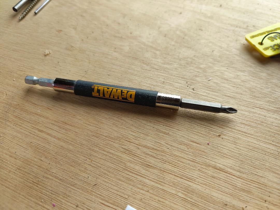

So I bought this extension driver set https://www.screwfix.com/p/dewalt-6...x9cjd7Cx1ku4n6-IOXhoCCBAQAvD_BwE&gclsrc=aw.ds but (here's the key) I bought it pretty cheap off Marketplace (apparently new), however the outer sleeve slides up and down as per the photos (on both extensions). It works just fine as it doesn't slide about during use but surely the outer sleeve is not supposed to slide up and down? Or is it and I'm being thick?

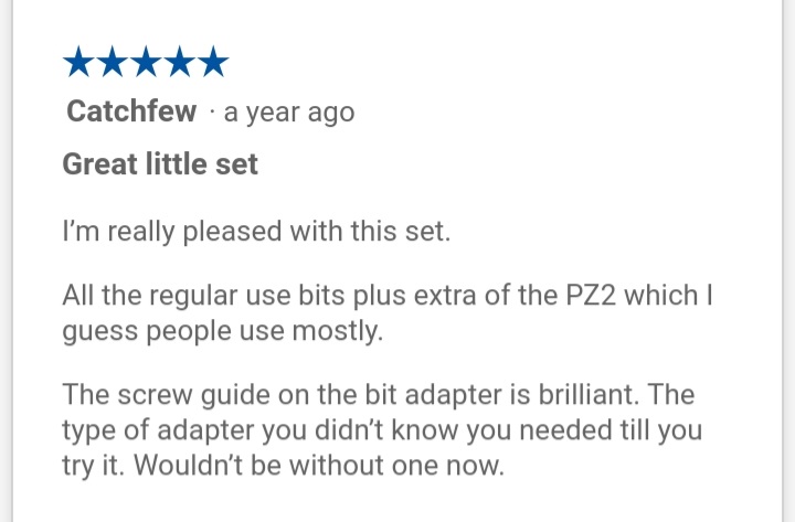

Hmm that's a bit crap, the bloke in the video was incompetent, his reasoning was kind of what I was resigned to thinking that that's what it was for but I can't say I've ever had a problem. Hmm.
If you'd ever driven a lot of slotted head screws you'd understand the need for the sleeve. Driven at speed (after all the reason why you buy an impact driver) the bit will often tend to slide out of the screw head, and skate merrily across your work (not nice if it happens to be a polished piece of furniture), particularly if the screw is worn. The sleeve prevents that.
The sleeves are almost sod all use with steel Torx, Phillips or Pozi screws in my experience, for which a magnetic bit holder is far better - but it may be of use for those pesky non-magnetic stainless steel, brass and bronze screws you sometimes have to deal with

Mine does that.
I have one of those Dewalt sliding sleeves. They are magnetic.
Yes, but the point I was trying to make was that an open slotted bit is about as much use as a chocolate teapot when used in conjunction with an impact driver or a fast drill/driver, magnetic or otherwise, and is potentially of limited used with non-magnetic screws
Either way, a product of limited utility
