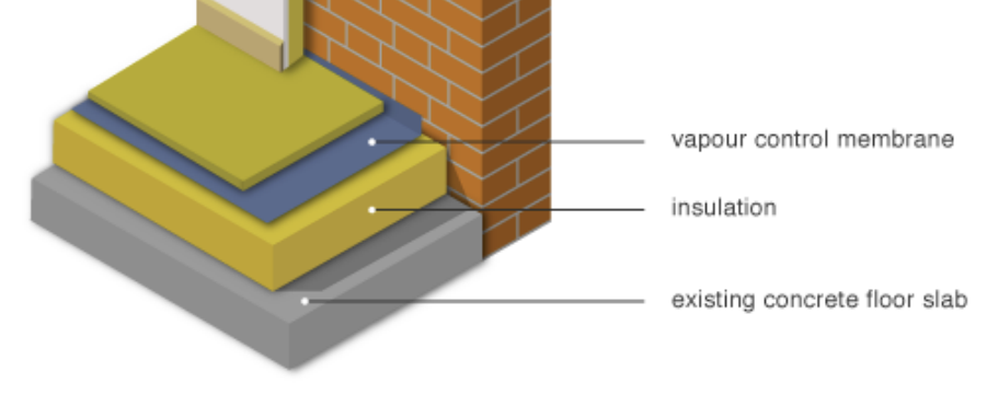

Do you have the height for a suspended floor? You could just lay insulation boards on the slab.

If I put insulation board on the slab, could I then just put flooring sheets over that I take it? Cheers
Yup
Got the space for 100mm? PUR or PIR. https://insulationmanufacturers.org.uk/inside-insulation/types-of-insulation-2/
