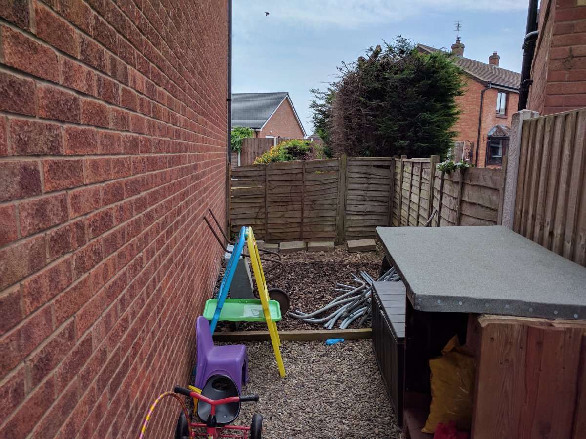

Hi All,
I'm looking at building an office shed at the side of our house. We've not decided whether to go for a pre-fab, or build one ourselves. I've not bad at DIY myself - kitchens, bathrooms, partition walls etc. We also have a good friend who's a carpenter.
We were hoping someone might be able to offer some high level advice if possible?
Please see attached photos - I'm thinking of using as much of that space as possible whilst keeping it square to the house ( 3m depth x 2m width )
My first question - is it a good idea to build the shed attached to the house? So the brick would be one of the walls on the interior. Or is it better for it to have it's own wall butted up against the brick? When I say 'better' I mean in terms of water ingress, damp, mould or anything else.
Second question - any thoughts on the best approach for the foundation? A concrete slab seems the best choice, particularly if attaching to the house.
I've also considered a timber frame, raised off the ground using some of these puppies concreted in holes:
http://www.toolstation.com/shop/Lan...crete-in+Sleeper+/+Base+Anchor+Bracket/p75498
Another option is using a base kit like this:
http://www.shedstore.co.uk/shed-accessories/shed-bases/eco/10x6-pro-shed-base-kit-shs
With the base kit, I'm just concerned about damp rising up through the timbers.
It's early stages weighing up the options, but any thoughts are welcome.
Cheers
What you propose will likely need full planning and building control, given the proximity to the boundary.
Can you not stick it at the bottom of the garden. it will be an order of magnitude cheaper.
Thanks for replying. I was under the impression that as long as it's under 2.5 metres we're fine right up to the boundary:
https://www.planningportal.co.uk/info/200130/common_projects/43/outbuildings
With building regs, I didn't think it was a consideration, but I just checked:
https://www.planningportal.co.uk/info/200130/common_projects/43/outbuildings/2
and it mentions 'within 1m of the boundary'.
I'll look into both factors though to be sure. We're just trying to make use of the dead space, and with a window to the front, double doors to the rear (no side windows), it'd be an okay place to work with plenty of light.
Planning/Building Regs aside, do you have any thoughts on the foundations?
If it's attached to your house it's not an out building.
Some people seem to think a gap of 150mm is sufficient, others think bigger.
Will the design work with a 200mm gap say?
It's not designed yet, just scoping out issues such as these at the minute. We could factor in a gap if needed. I'll look into that then - I didn't realise there were different rules if it was attached to your house - thanks for the heads up..

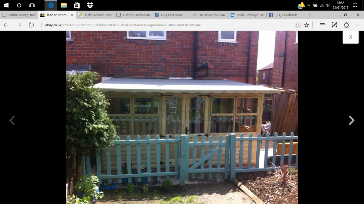

Hi, I'm just about to post on here somewhere for advice...I am having a shed/outhouse type of construction built against my house and am doing it from scratch. I did wonder whether to buy a building but it worked out more expensive. I will add a photo of the sort of building I wanted to buy, then was going to insulate it, waterproof it etc etc. As you can see this is joined on to the back of the house, its just an idea but thought I would show you.
Providing you retain external doors and walls and build it at ground level. As per the guide:
  • They are built at ground level and are less than 30 square metres in floor area.
  • The conservatory is separated from the house by external quality walls, doors or windows.
  • There should be an independent heating system with separate temperature and on/off controls.
  • Glazing and any fixed electrical installations comply with the applicable building regulations requirements
