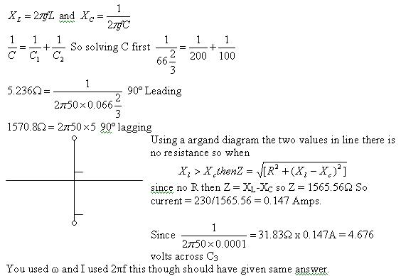

Sorry missed a set of brackets I got it wrong.
At 50 Hz Current = 142.1031304ma and voltage = 4.523283127 volts
At 60Hz Current = 119.4963906ma and voltage = 3.169740207 volts

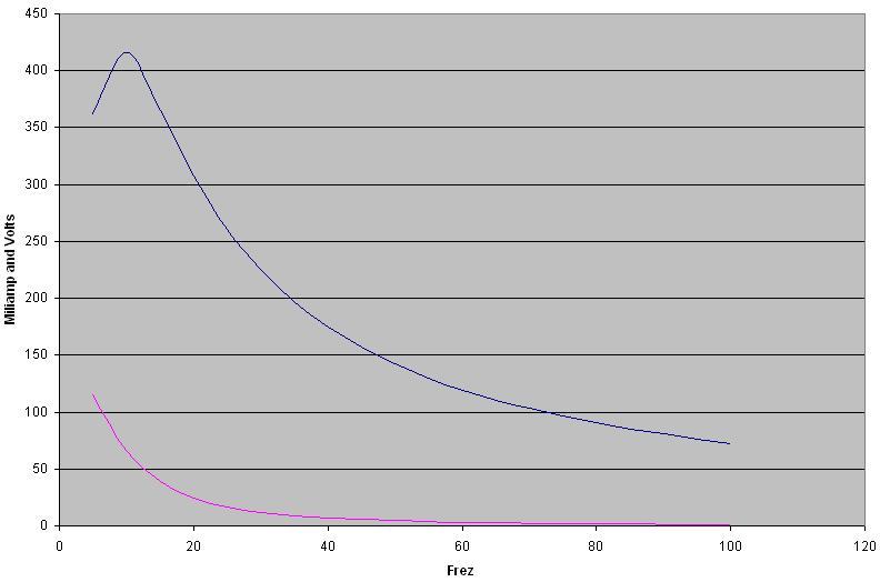

Since frequency was not given so here is a chart to show frez compared with both milliamp and voltage.
Frequency was 50Hz as shown bottom of diagram.
Very close with the answers but small error margin, didnt show the answers in degrees though ;)

You have not included any resistors in the problem. In real terms there would be a mixture of resistance capacitance and inductance. And yes once one adds some resistance one would also need to work out lead or lag in degrees. But this will be 90 deg lag.
Since no other answers and I note my problem got no answers either it seems know one wants to get involved in complex numbers.
This is a DIY forum and the book I was using to revise with was level 4 to 6 and using Argand diagrams and J notation is not really likely to be of much interest to most readers.
I did note with BAS example we had some wrong answers and it is so easy to make a error as I did missing out just one set of brackets.
Which means to publish the answer really needs the step by step workings to show any errors.
In another 24 hours if you get a few more answers it may be worth it but I am sure my method is correct and any error will be another set of missing brackets or some other minor error on the spread sheet and hardly worth your time and effort to write out the answer with workings and without workings it is hardly worth the effort as it would not really show where the error was.

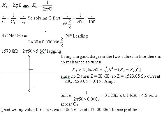

ericmark you are correct about the resisitance in the circuit, in my haste to put the problem out I drew the circuit and completely forgot about it having any form of resisitance :)
Thats said the circuit is still solvable and as it looks like there may not be any more answers forthcoming i'll show the solution
well done with your answers as its quite a complex solution.
View media item 8865
the current through the capacitor measured would lead the voltage by 90 degrees, but the current through the ammeter would be in phase ( 0 deg ) with the voltage due to the inductor correcting it..
so to answer your question..
the voltage at the voltmeter would be at 0 deg in relation to the supply voltage, and the current through the ammeter would be at 0 deg with relation to the supply current..
I got 4.53V and 0.142A

I am looking a lower case omega squared and can't see where that comes in as since no resistance the square and square roots cancel each other. And I see no square roots only squares? If you had included values as well as how calculated it may have been easier to find.
When I entered 1/2*pi()*50*0.0001 I also got wrong answer and had to enter 1/(2*pi()*50*0.0001) and I will guess it is something like that which has caused our answers to differ.

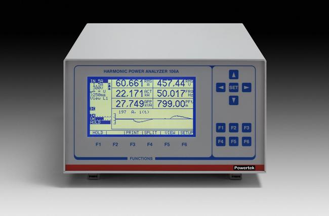

I did not see anyone setting it up do any calculations and the only way I know of measuring the power factor is with an oscilloscope.
So in real terms when will we ever use those calculations except with my hobby of being a radio ham?
You could use a PF meter (I have a clamp on one - clicky - even does DC power factor :confused: ),
or from my college days, use a volt meter, current meter and a wattmeter.
Yes I know they exist but the big boxes of capacitors will often have a meter like this
built in and you can get these
and even these
resize_image.aspx
but non of these really need you to get the calculator out and really do some maths. Charts and tables will be used to select the correct value.
