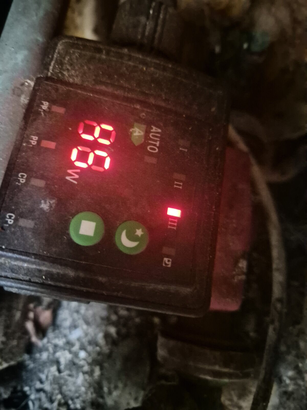

My oil heating has stopped working and i have no idea why. Can anyone tell anything from this photo?
Not much other than I suspect the pump is running. Has the motorised valve actuated correctly and engaged the microswitch?
No i have not pressed reset yet shall i do that? I will send photo of boiler soon juat giving phone quick charge to take one
Plenty of oil. I pressed it and its working now. Took three presses. What would have been the cause?
